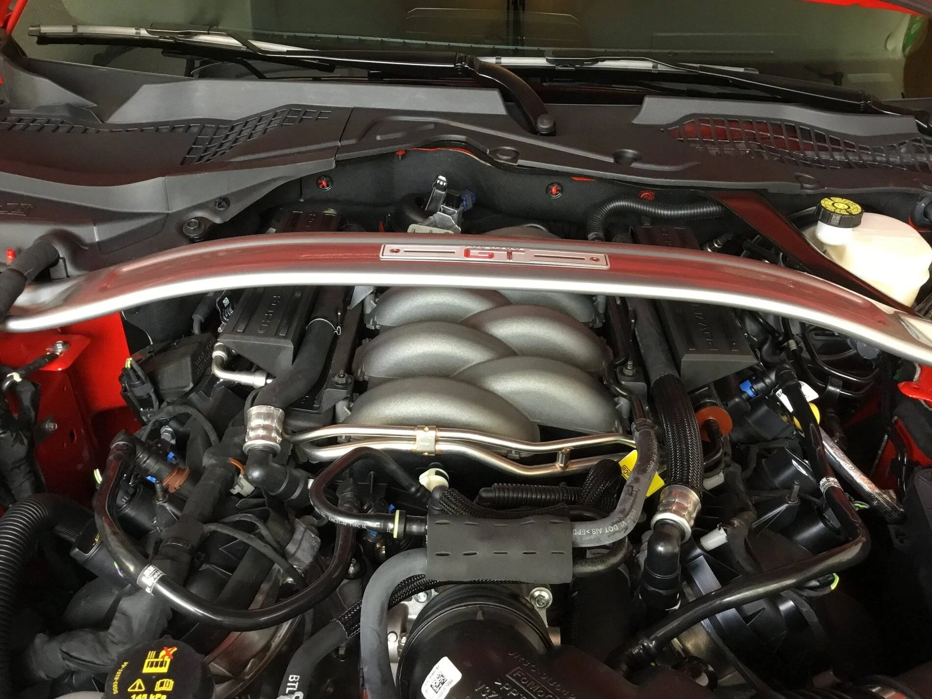

I torque mine to 35 ft/lbs. Mostly because I've heard of many people on here snapping those studs at the 41 ft/lbs value. But it also feels about right on the snug o meter built into my arm. And because they're locknuts in a non critical application. Technically the manual also says you should replace said locknuts every time you remove them, but I don't do that either.For those of you who have removed the engine cover and afterwards re-installed the engine strut brace, did you all re-torque the 4, 15 mm nuts to 41 lbs ft. torque as per Ford, or did you just do it up tightly?
I recently did the engine cover removal and originally put the 4, 15 mm nuts back on tight, but not super tight, but then read they are meant to be on at 41 lbs ft. of torque so will be using a torque wrench next time I am with the car. Just wanted to see if others did this too? Thanks!
Yep, I feel the same way. But I cut the sides off and the inside runners down on the cover so I don't have to removed the strut bolt nuts everytime I have to remove. Good luck.I took mine off the first week. As mentioned super easy to do. It does look plain jane with it off, but to me still better than with it on. After you take off the cover you can twist the oil filler neck off and the oil cap works without it. That helps cleaning it up a bit. I have a catch can, sound tube delete, and the oil filler neck removed. Looks better to me than with the cover on.
That is odd about asking for four new nuts when you install a new strut tower brace. I guess they figure maybe the old nuts have seen many miles and so they give you new ones. I removed mine after less than 50 miles and re-applied them right away. I'm just going to loosen them a bit to torquer them properly to 41 lb ft of torque, so I suppose the original still new nuts should be fine?I torque mine to 35 ft/lbs. Mostly because I've heard of many people on here snapping those studs at the 41 ft/lbs value. But it also feels about right on the snug o meter built into my arm. And because they're locknuts in a non critical application. Technically the manual also says you should replace said locknuts every time you remove them, but I don't do that either.
Technically, because they are locknuts, they should be replaced. This is because the self locking becomes compromised upon removal - it’s unavoidable. Will you have any noticeable deficiency effect from reusing them? Probably not.That is odd about asking for four new nuts when you install a new strut tower brace. I guess they figure maybe the old nuts have seen many miles and so they give you new ones. I removed mine after less than 50 miles and re-applied them right away. I'm just going to loosen them a bit to torquer them properly to 41 lb ft of torque, so I suppose the original still new nuts should be fine?
