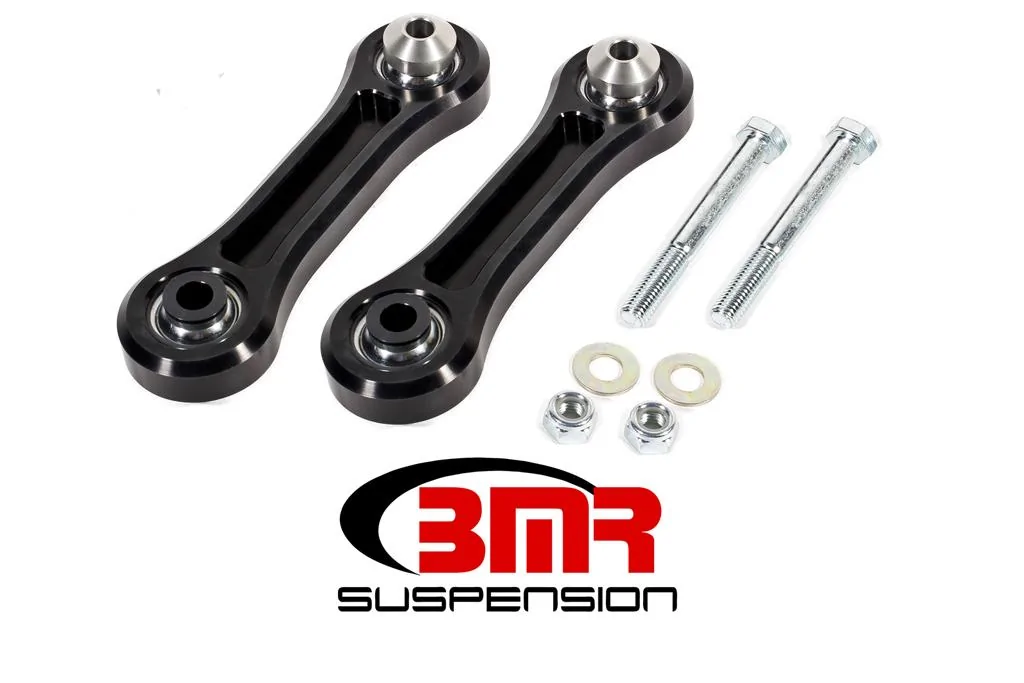

BMR with the sphericals are great for the street. 10/10 would buy and install again

Our TCA045 are my vote.
Currently, they are the only links of their kind - and we have a staggering amount of them out on the tracks, drag strips and roads across the world, with nothing but excellent feedback.
As stated above, they are VERY easy to install...and from that point on, enjoy.
Happy Modding!
J&M vertical links now offer vertical links with spherical bearings.
BMR Tech
