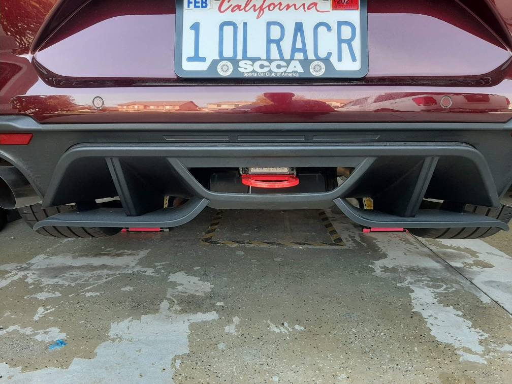

Ford Performance rear tow hook. bolts to the rear crash bars . Replaces reverse light. If you go this route let me know I can help you modify your revise light housing to give it a nice finished look. Oh I also installed a L.E.D. revise light.
yes please, love to see what you did…I have the hook and no reverse for the last couple years, not sure if I care though 😂

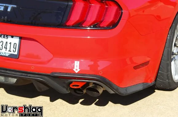

Thanks for the tips. I think the Vorshlag hook is nice from an installation standpoint but I really don't like the look over the exhaust tips.

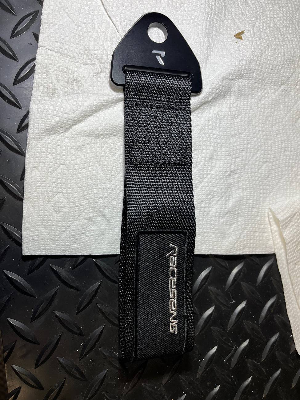

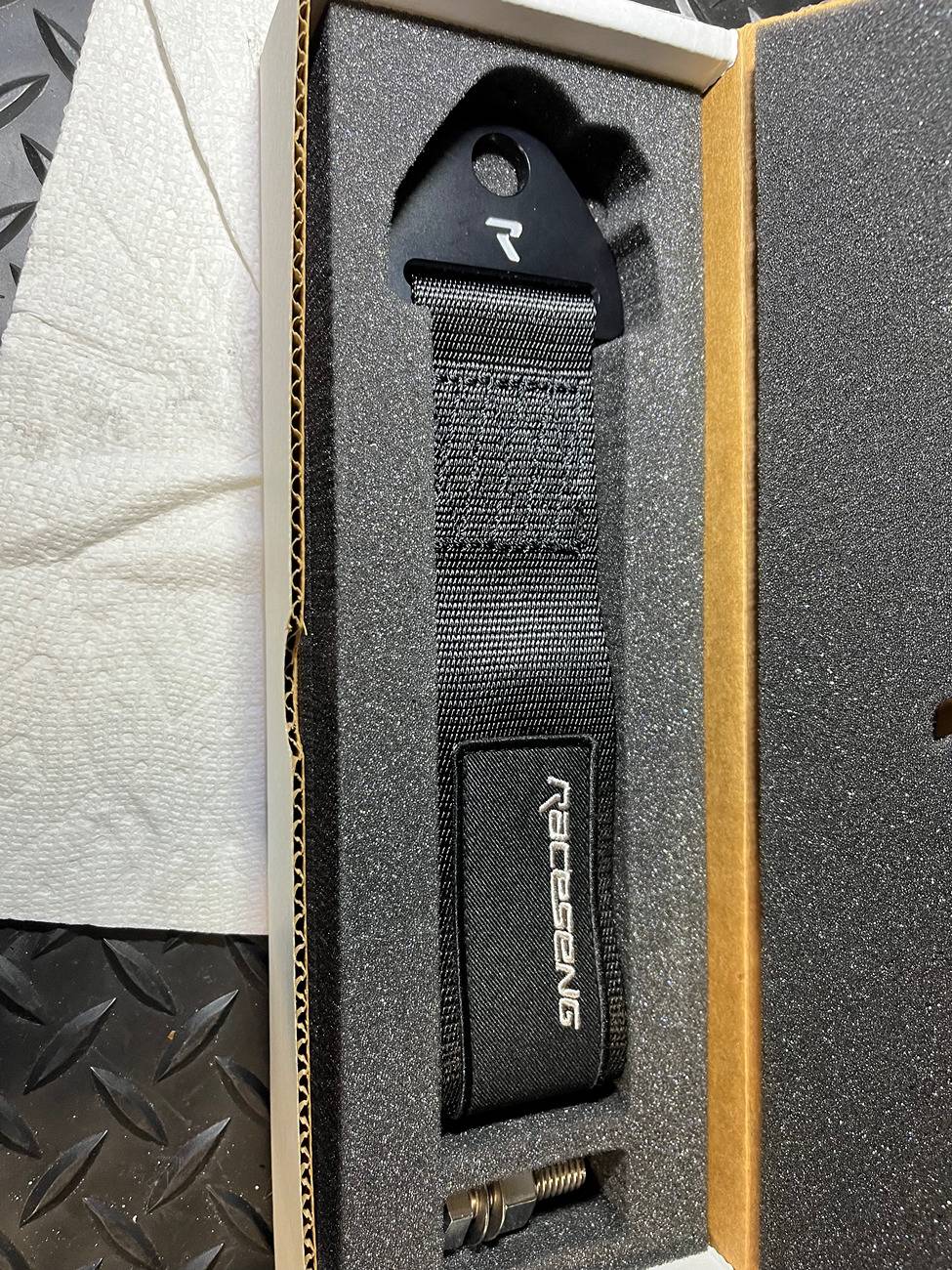

Tow strap came in today, I'll document my progress as I go along in the installation.

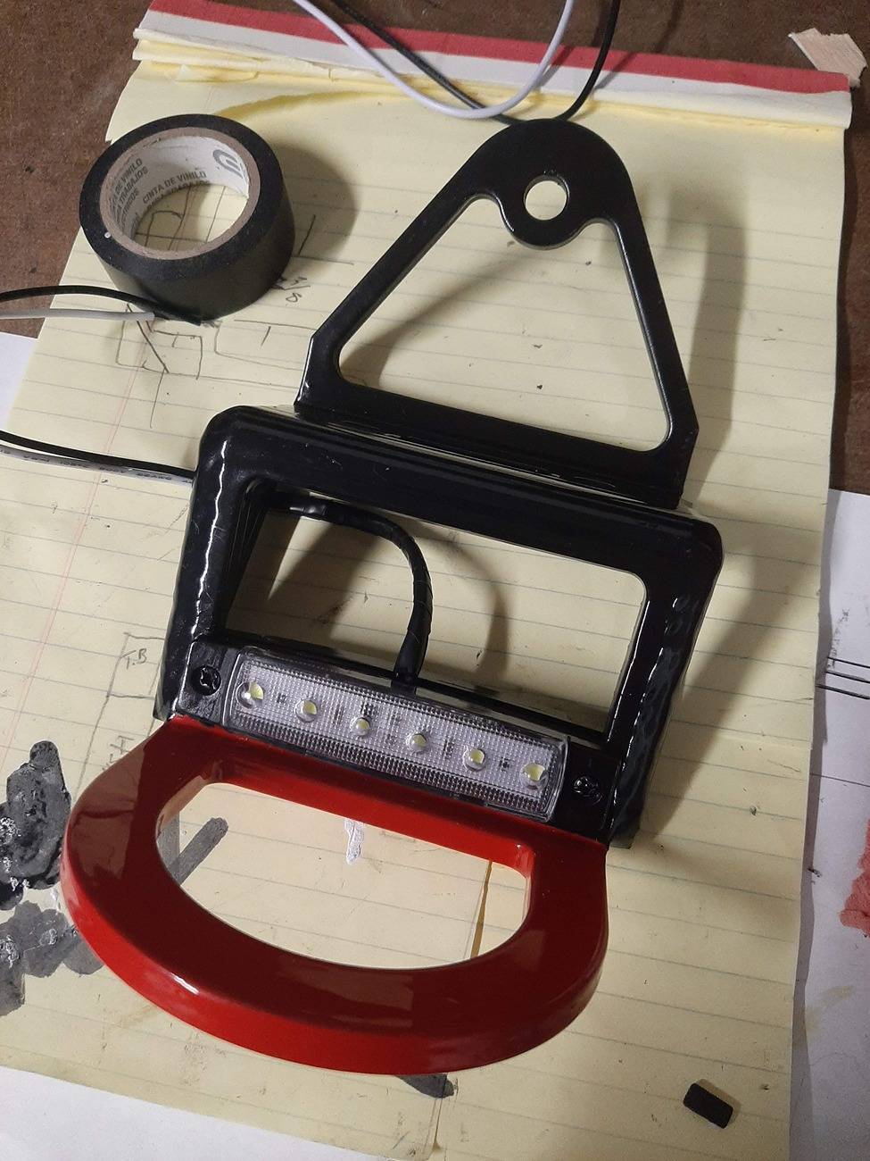

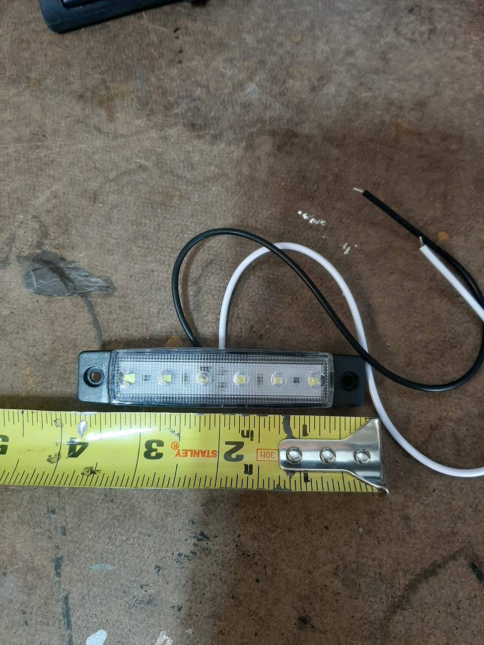

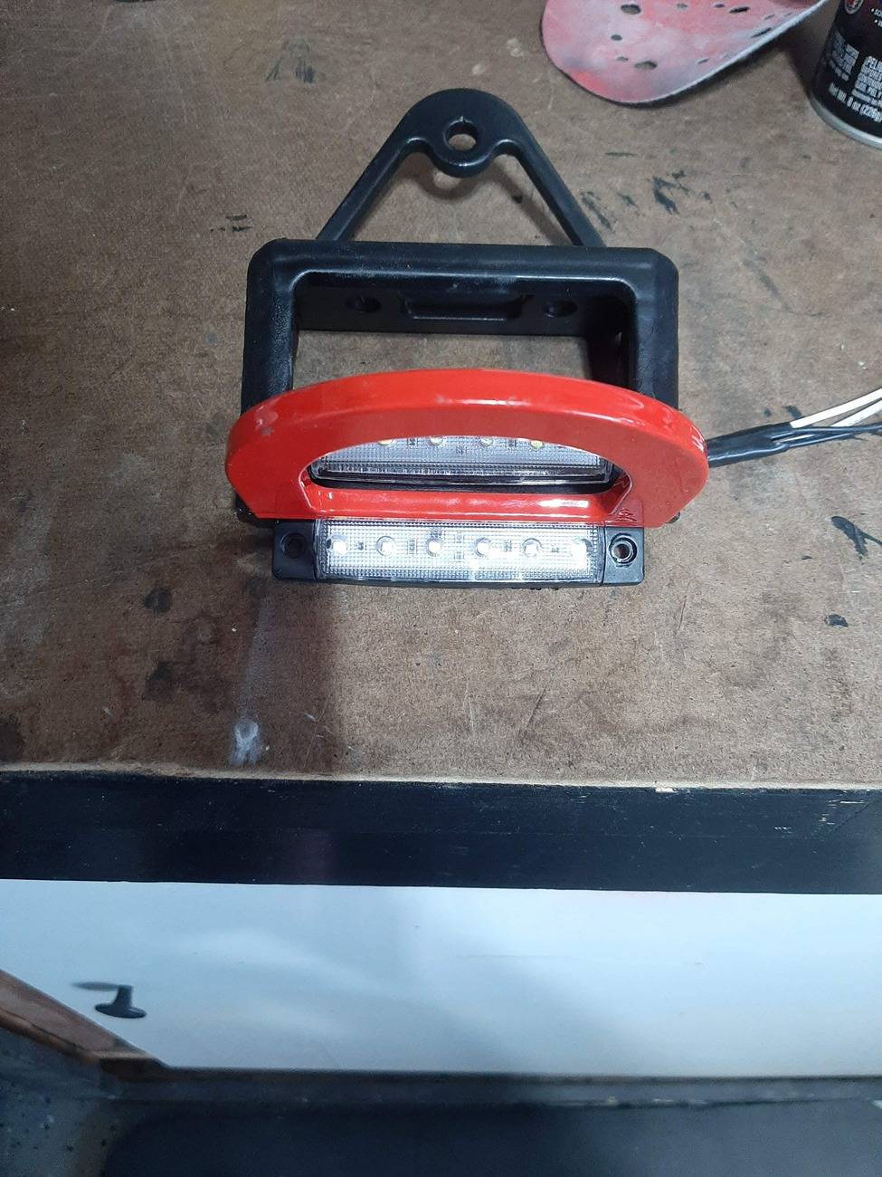

Here is the tow hook with a pair of L.E.D's. I also painted the part that was located inside the reverse light housing black

Amazing. Thank you. Did you drill the tow hook?

I did the Vorshlag on my Mach 1. Had to trim the plastic surround above the exhaust tips as it was slightly holding the bumper cover up. Solid as a rock.

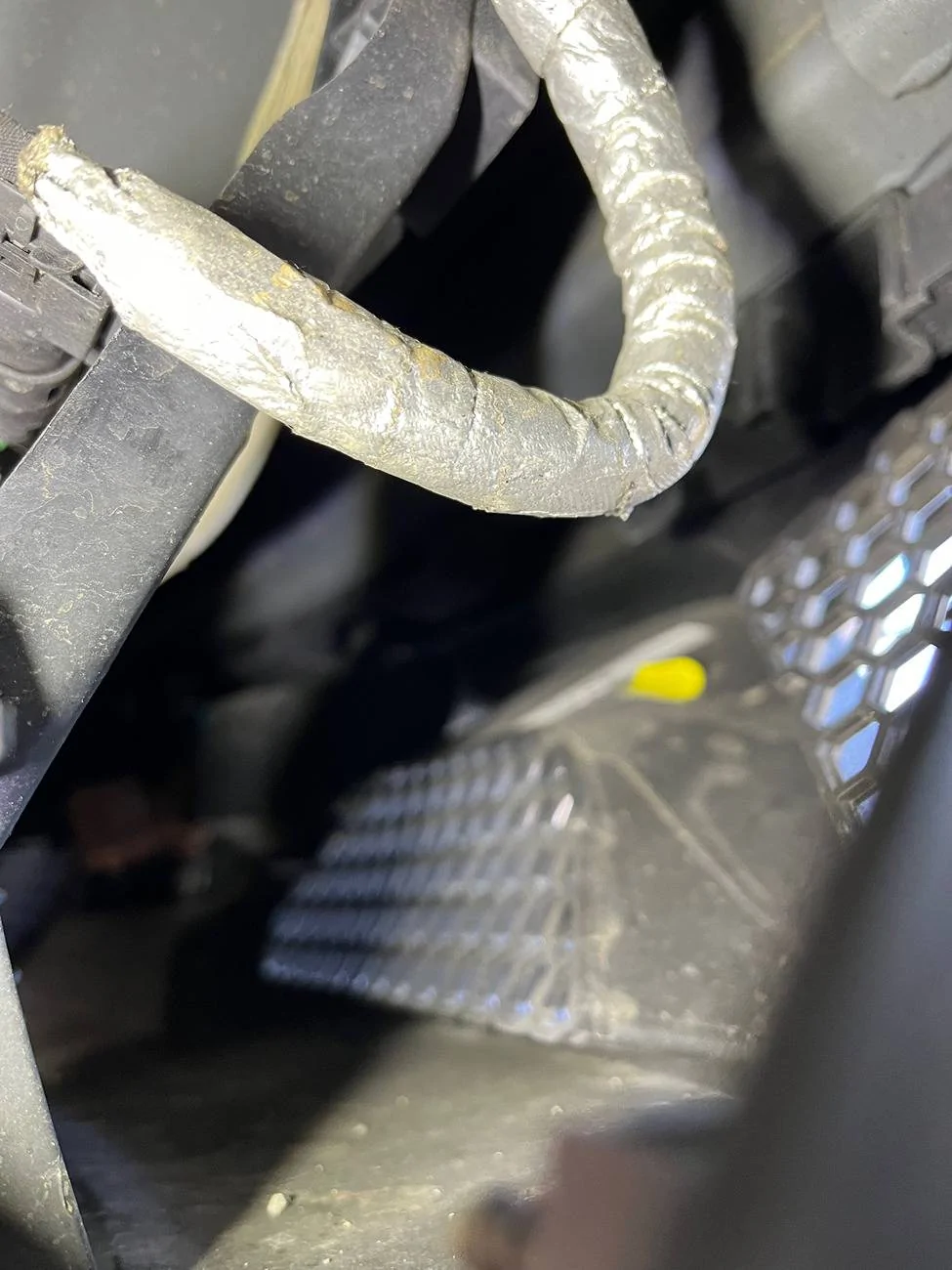

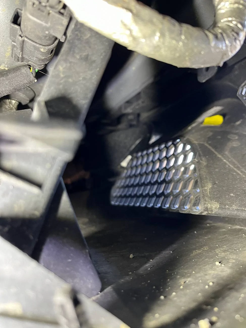

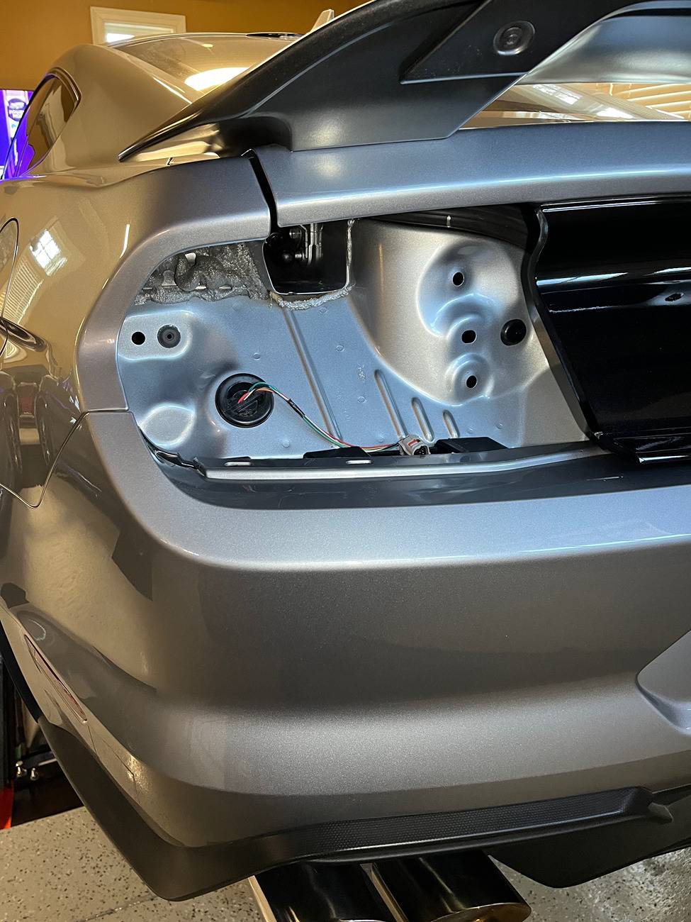

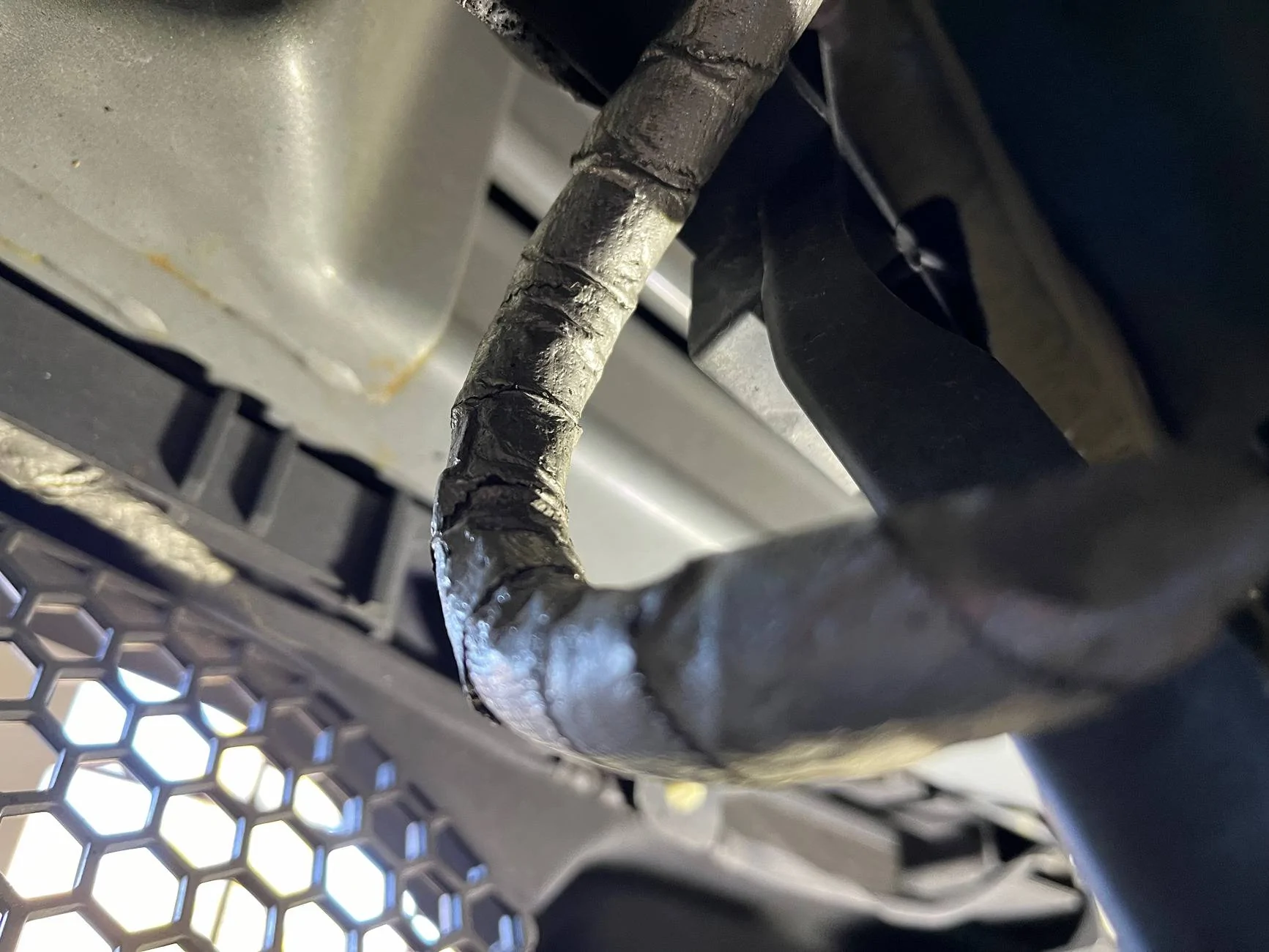

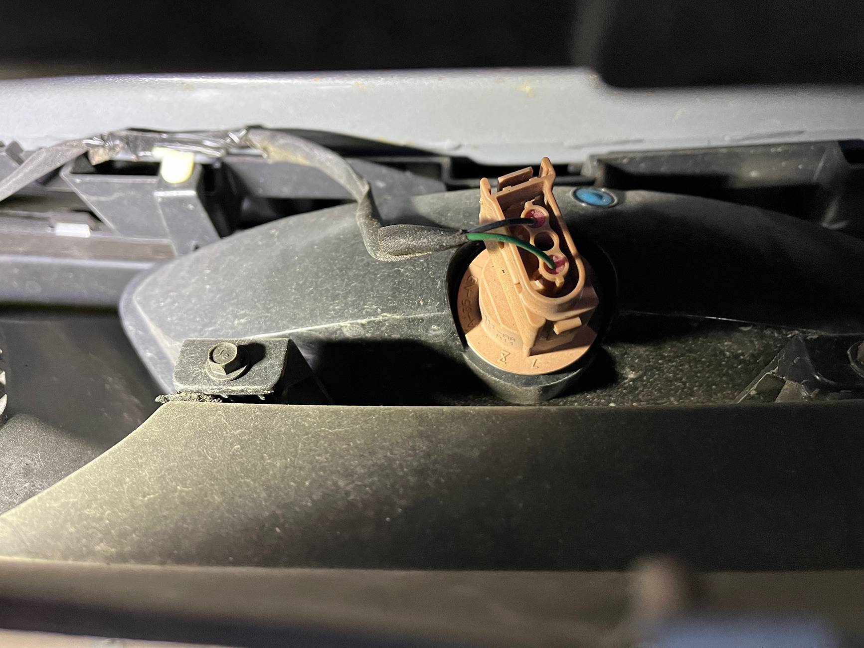

Step 1 remove lower diff cooler cover. Expect lots of gravel, track rubber debris, leaves and other stuff to fall out so have vacuum cleaner handy.
Not much to see, but back-up light is visible as is the crash bar but up a bit higher than I thought it was going to be (happy about that as I want my strap to be up a bit higher.)
Next step-remove rear bumper cover (never done that).
VictorH
VictorH
Mar 4, 2021
31
652
933
South Carolina
Victor
2021 Mach 1
Finished for today.
Not street legal anymore.
Got most of the upper fasteners off the top, still have a couple of mini-bolts and electrical connections to remove (side lights and back-up light.
Then probably take some measurements before removing the bumper cover.

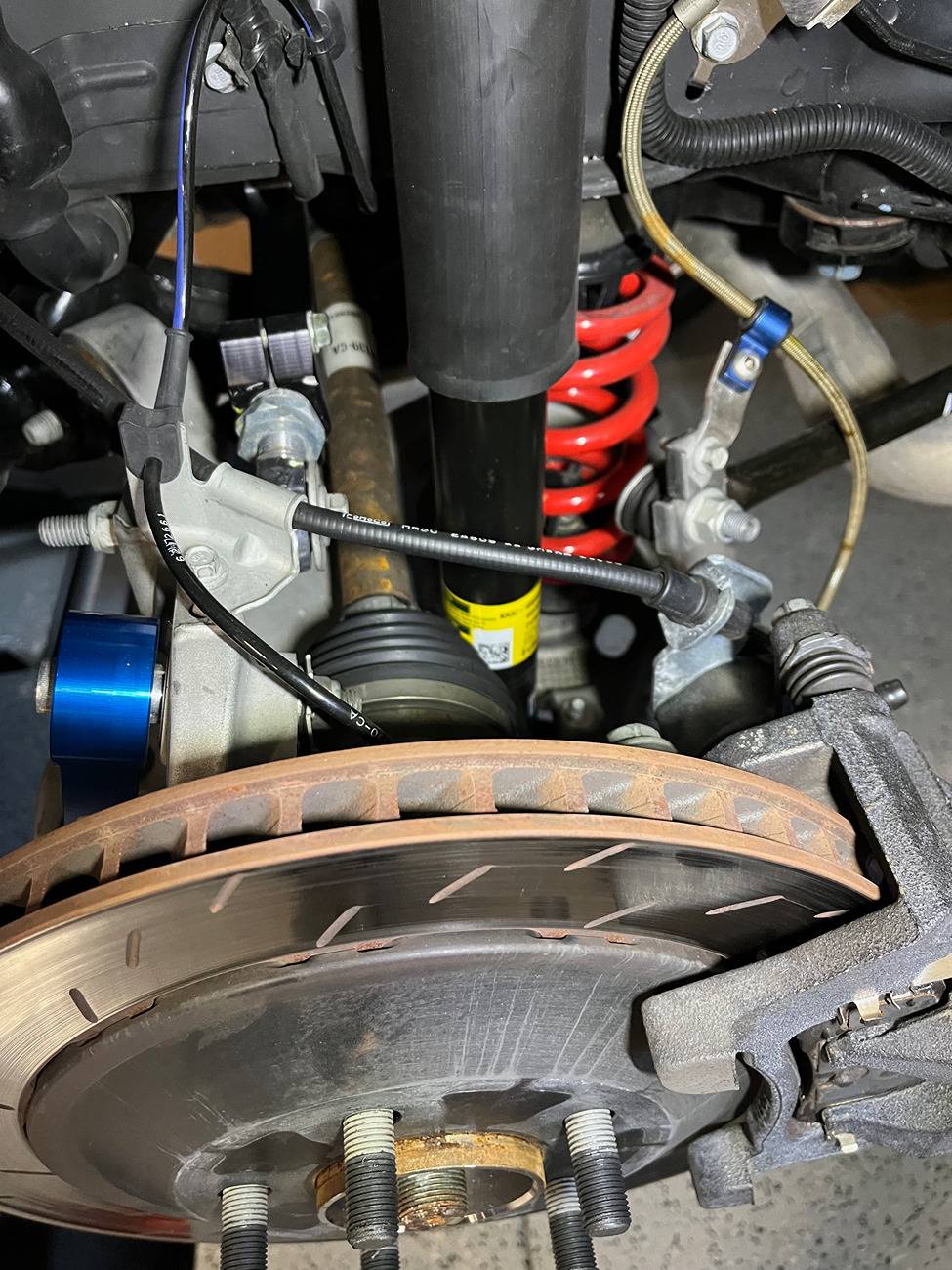

My track set up in back, adjustable camber arm, billet vertical links, coil-over spring conversion and skinny rear sway bar (not seen Ford Performance outer toe link bearing).,
No, I purchased a bag or ten of the LED's , painted two of them black and used them as a backing plates and sandwiched the tow hook between the ones used for light and the ones used for backing plates, bolted them togather with the provided screws and nuts. Of course I could have fabricated a backing, but I had the perfect ones already in the bag .
