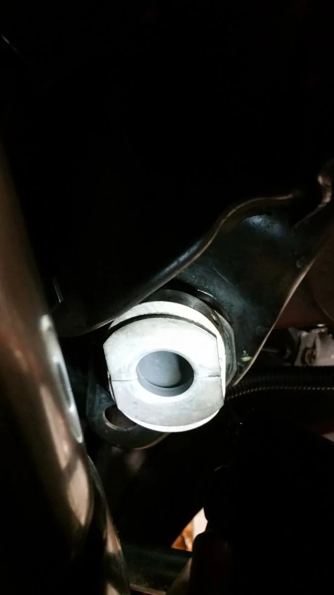

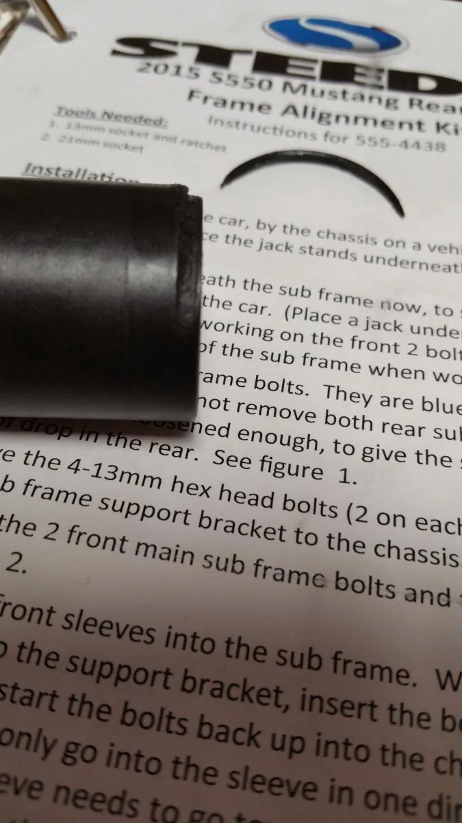

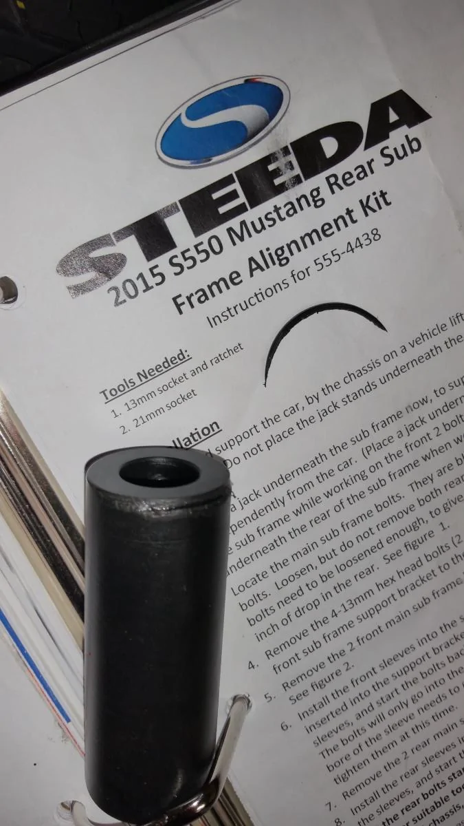

Steeda, I believe I may have found the issue (hopefully). I discovered that the alignment kit sleeve is chewed up. This sleeve was located on the driver side rear subframe bolt. Once I clean everything up and lube all moving parts, I'll check the passenger side. It is obvious that the sleeve was sitting on that lip under load. Please review the provided pictures for a better understanding of what happened. Can you please advise the next step as I'm leaning on not even installing it back on? Will I receive a replacement?

I just saw this but I inspected the brakes and it looks fine. What are or component do they believe will cause the "brake groan" sound? I feel that I may have found the issue with the alignment kit sleeve but it would be nice to know about this groan for others to be aware. I'll provide a update when everything is buttoned up

There are front and rear inserts, get that correct when installing I hope.
After removing both and moving them around, I did install them correctly. The smaller longer sleeve goes to the rear subframe and the thicker shorter sleeve goes to the front.

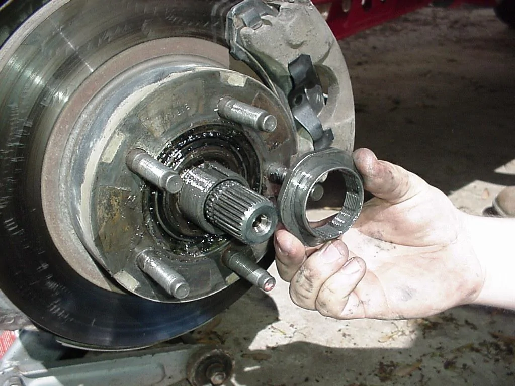

Sorry to be such a noob, but which is the spindle nut again? Do you have any pics or reference?

Spindle nut is the nut that essentially holds the CV/half shaft into the hub.
Photo below is not a Mustang, but you get the point.
Without this torqued properly, you risk not seating the bearing properly causing premature wear (noises) and, well, a myriad of other issues.
Ford really has no excuse for the number of these we've seen reported that are not torqued down properly. I don't think dealers get into the business of loosening these nuts during their post-delivery/pre-sale activities.
Final torque with the wheel on the ground to keep it from spinning or lock it up with a crow bar in the wheel lugs, whichever. I don't think you're supposed to impact these down given there's a bearing there.
