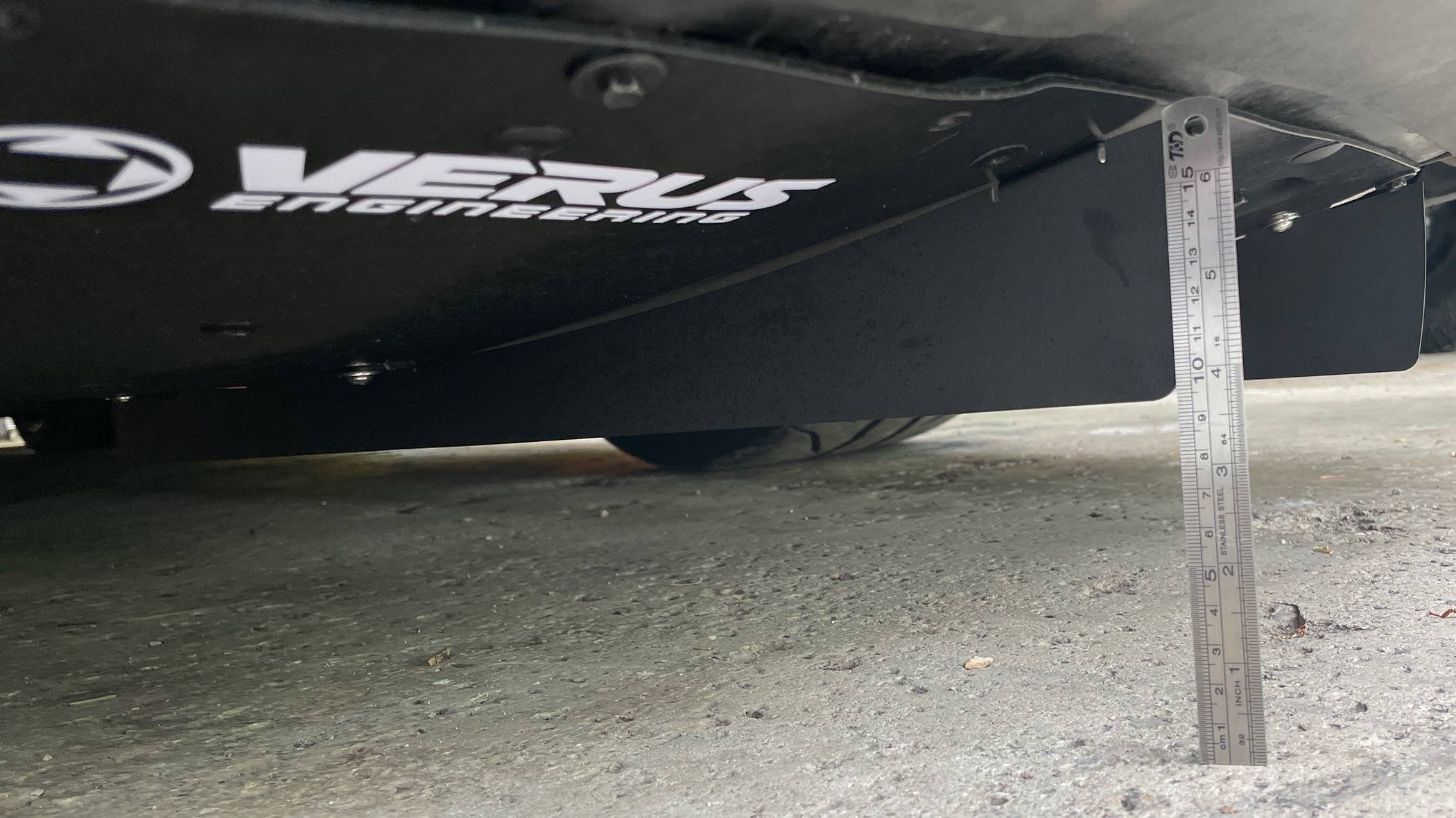

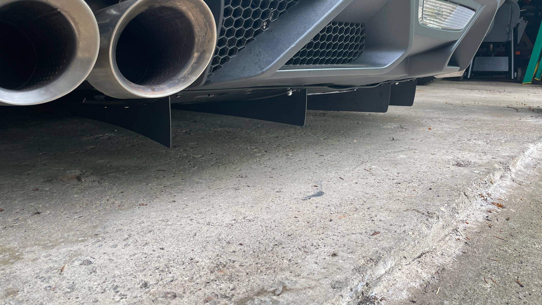

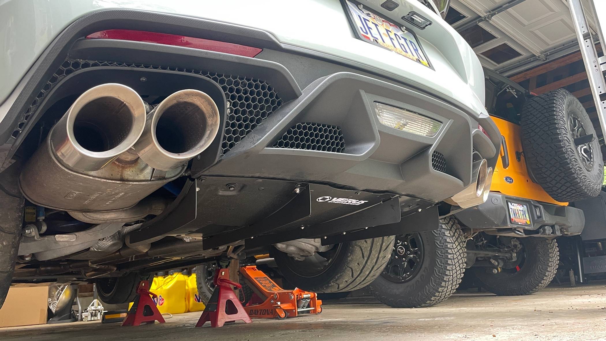

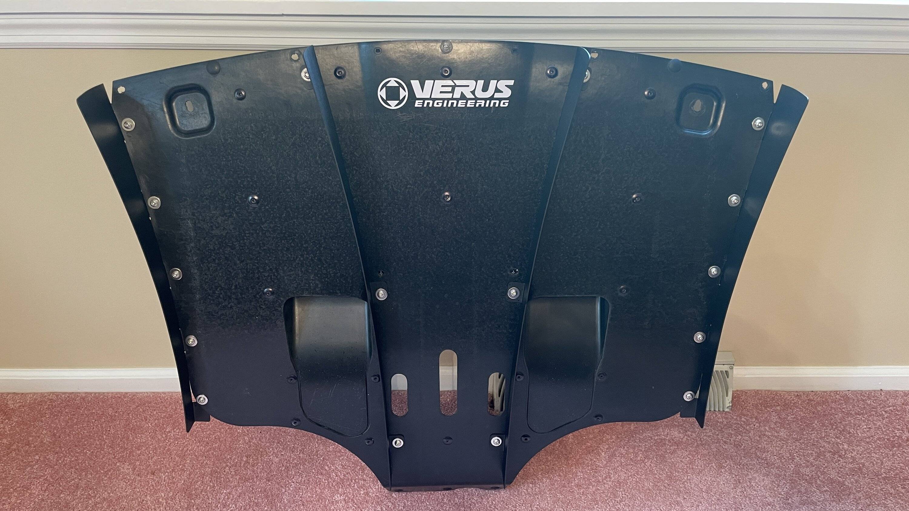

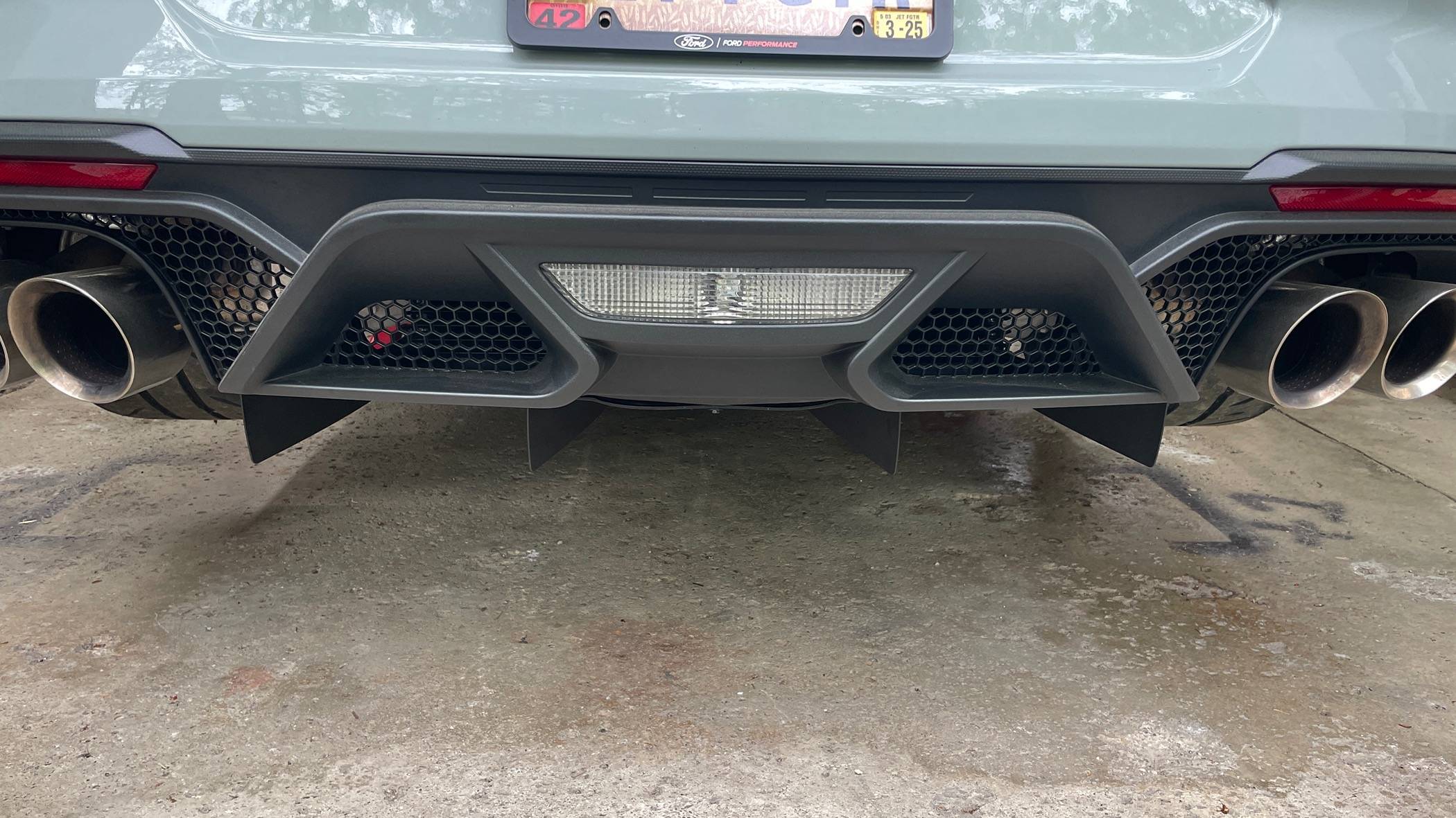

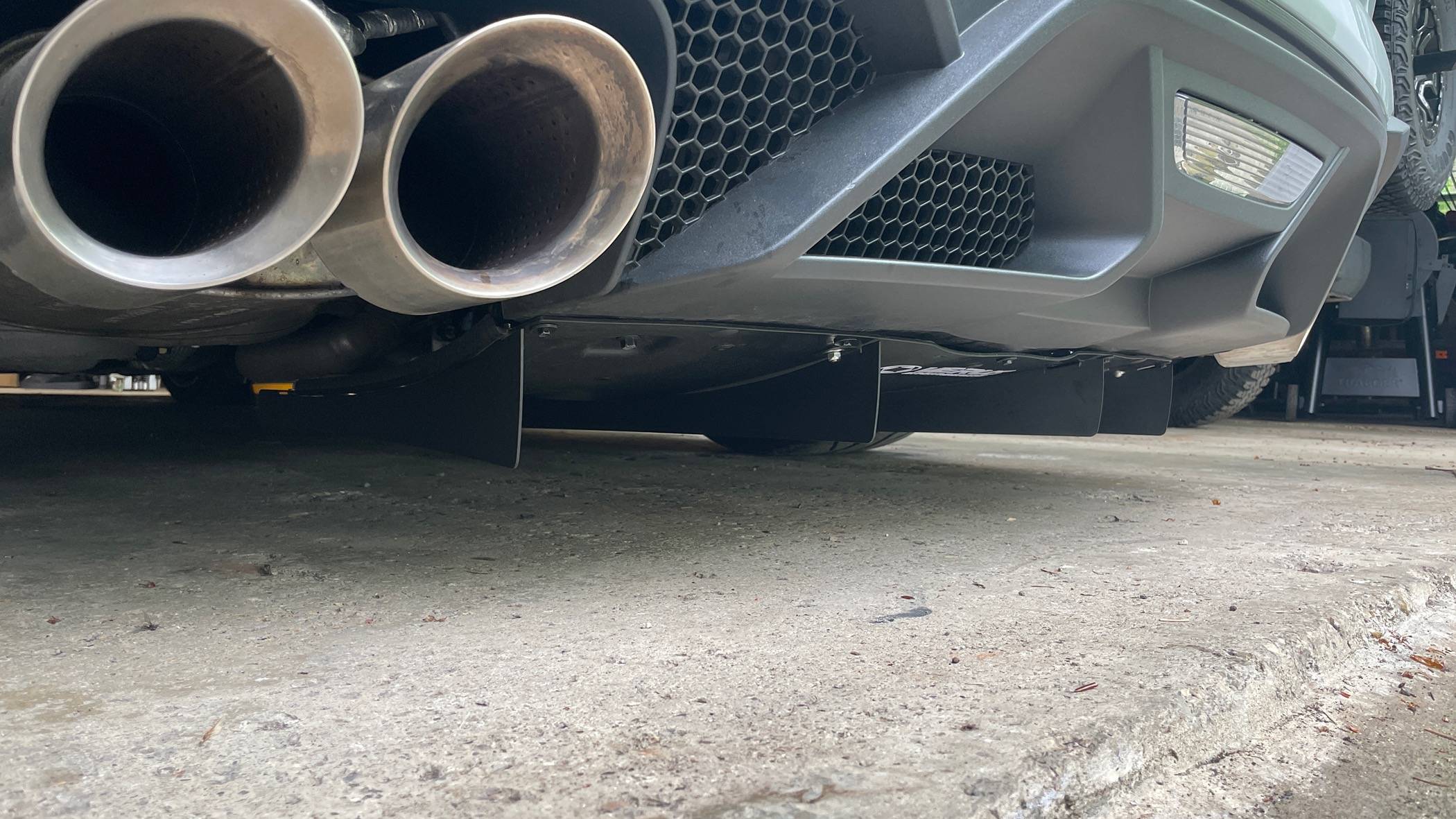

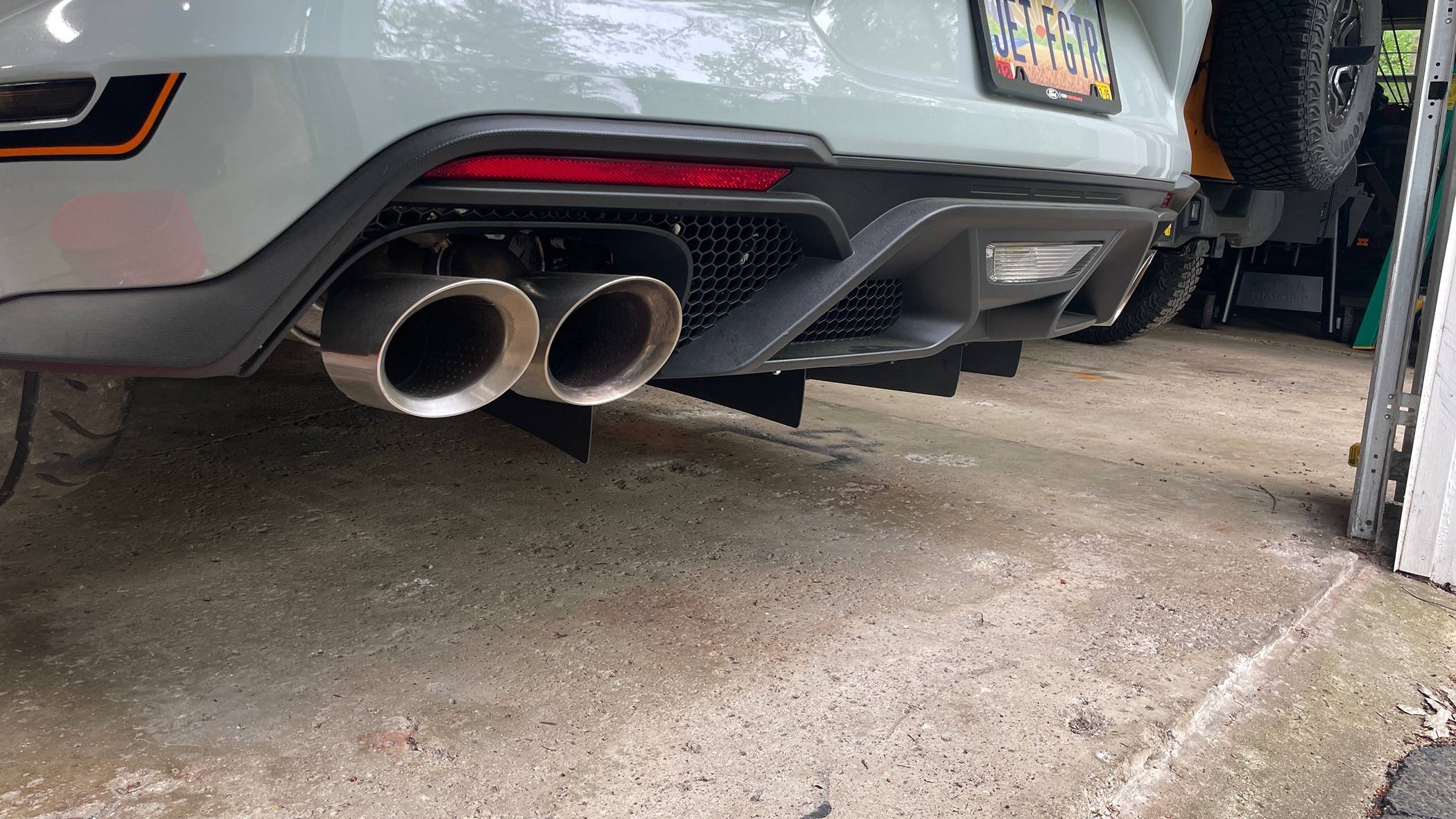

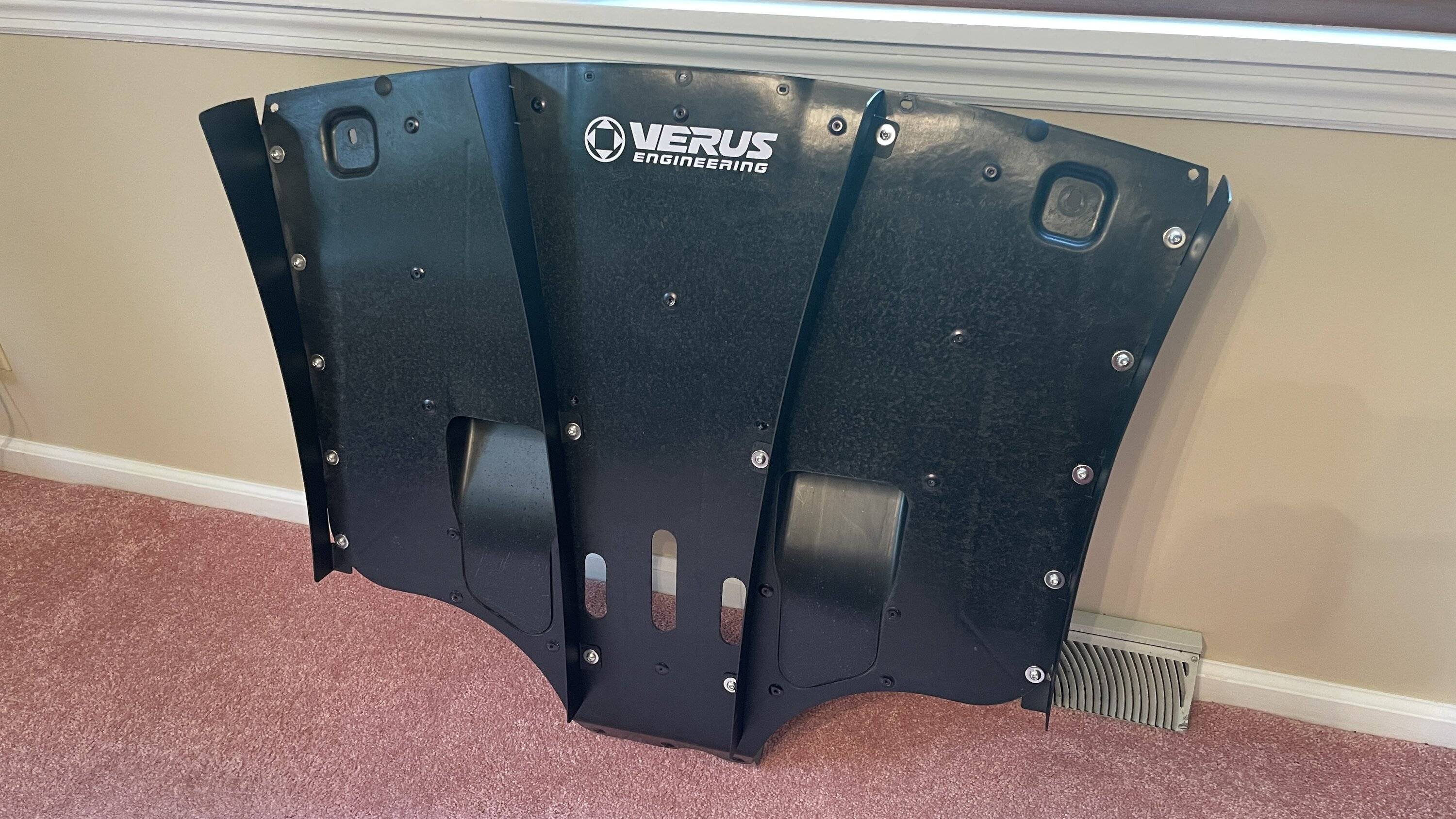

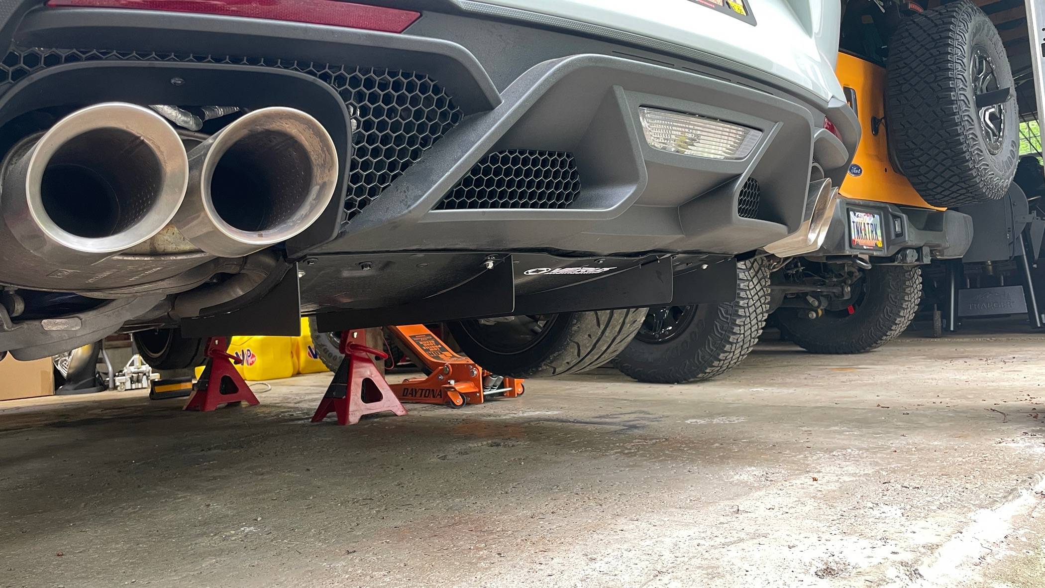

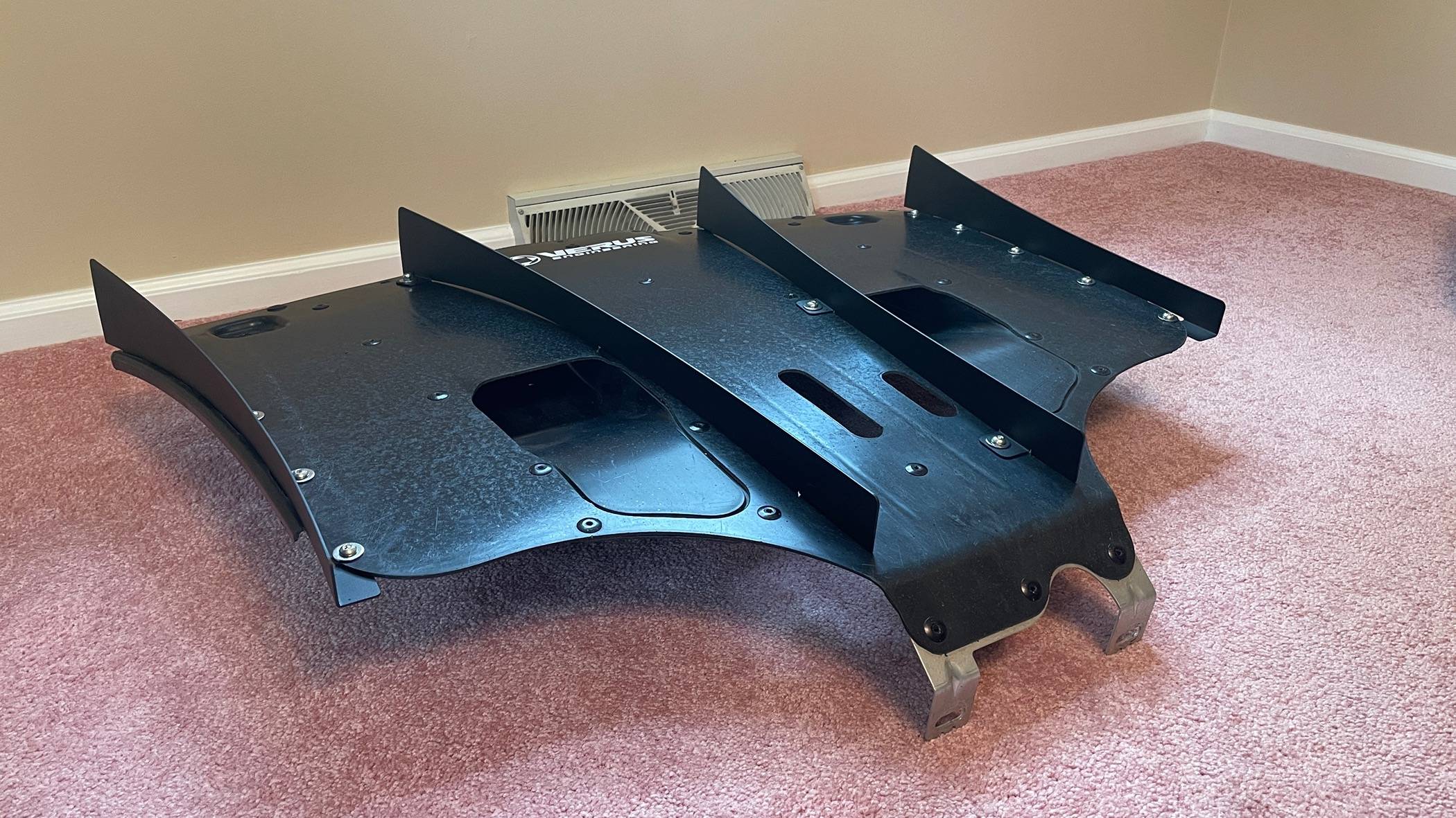

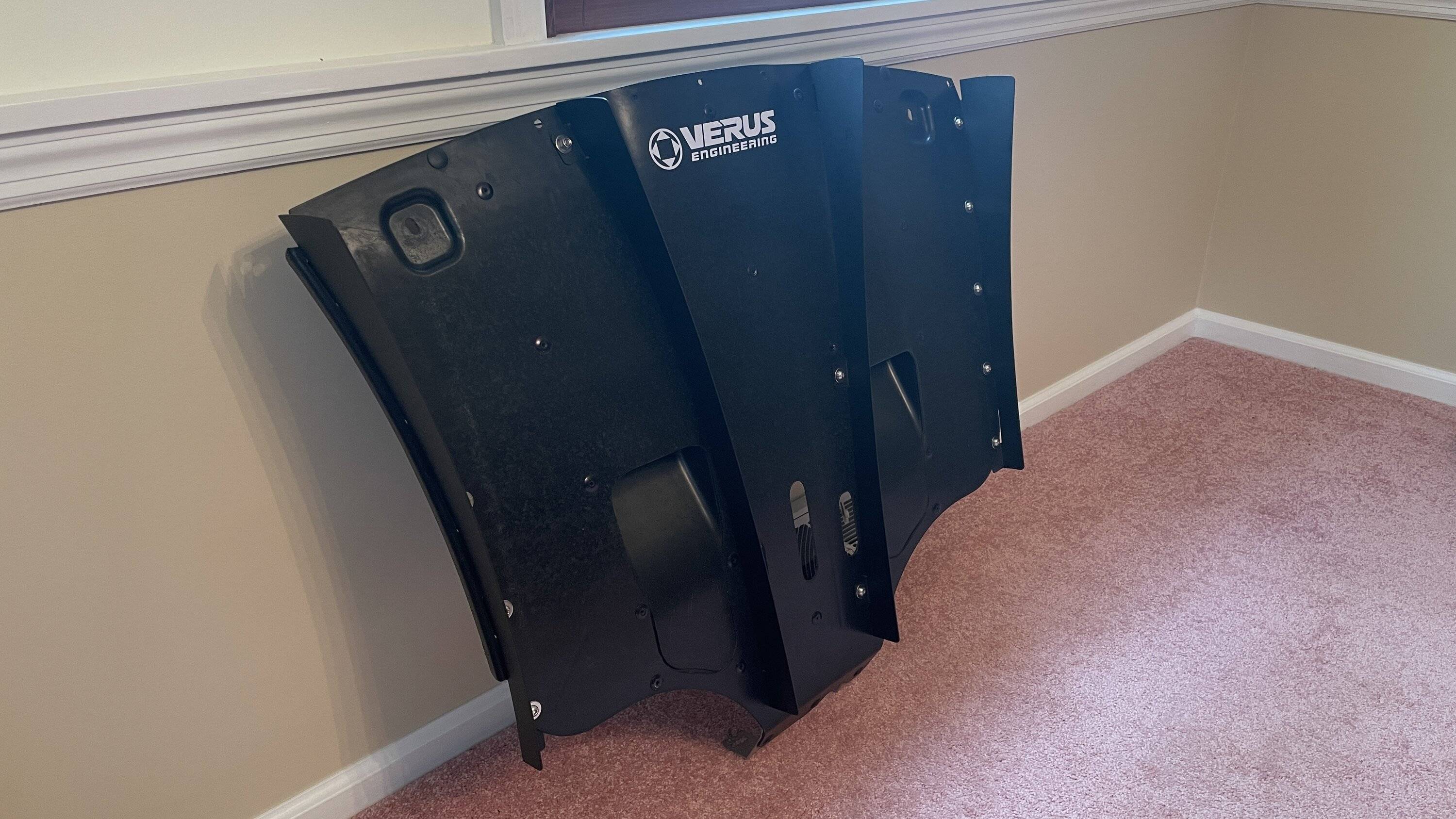

I have been looking to add a diffuser to my 22 Mach 1 and found one on the CAM C thread from a company called Verus Industries. They have a few options for the s550 platform and one I chose is for the GT350. This Diffuser Strake Kit was very easy to adapt to the Mach 1 rear diff cooler cover/scoops. The center strakes have 3 attachment points that use some holes occupied by rivets that hold the cooler ducting and front mounting bracket. The side strakes are bolted on the sides with some minor modification to the cover.

Not at the moment, the balance of the car on track (before this addition) is very close to where I would like it. I still have some sway bar adjustability (Steeda Adj. sways/Adj. end links) Due to the early season rain and cooler temps I haven’t been able to push as hard as I would like in the faster parts of Mid Ohio. The car works very well in the Esses and Madness into thunder valley. Last time out there were weepers on the bus stop before the keyhole and on keyhole exit so I had to go easier than I wanted. I am very much looking forward to warmer temps and dryer conditions in the coming months. The new track surface is going to work very well especially in the rain as compared to last year. Exponentially more grip when wet as compared to before the repave.

Great job and crystal clear video. Why Ford revised the gt350 rear diffuser panel for GT500/Mach 1 is beyond me but your modifications are a great solution. I pointed out the discrempensies to Verus last year when I discovered the same improper fit on my Mach 1 and they were planning to release an updated kit. Coincidentely, Verus just confirmed with me, yesterday, they've been too busy with other projects and they put the Mach 1 strake kit on hold. (Maybe if Dark Horse shares the same diffuser panel, it would open additional market to justify an updated strake kit?) Please provide more feedback on the functional impact of these strakes, hopefully your mods are well worth the effort and aerodynamic benefits.
