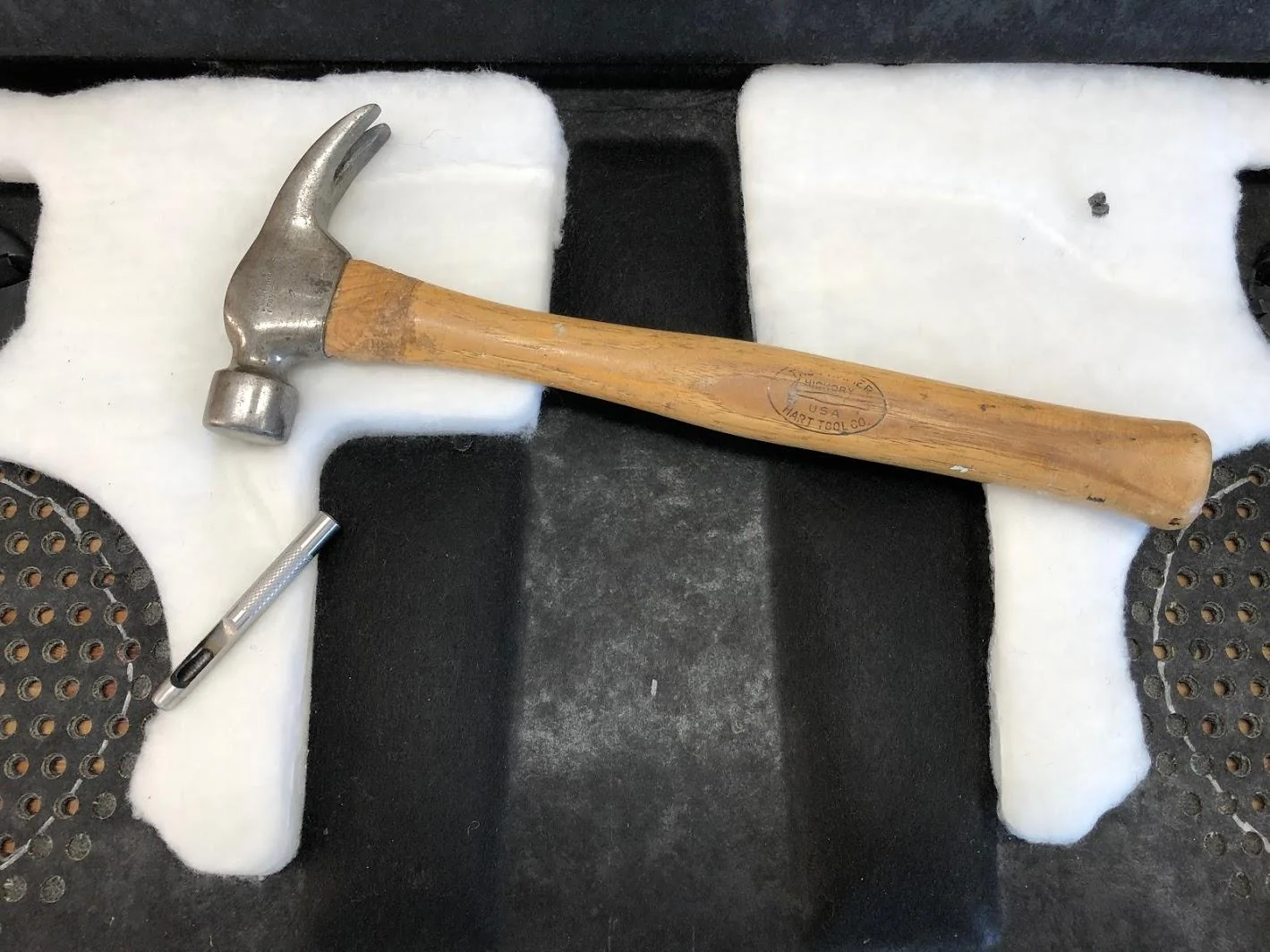

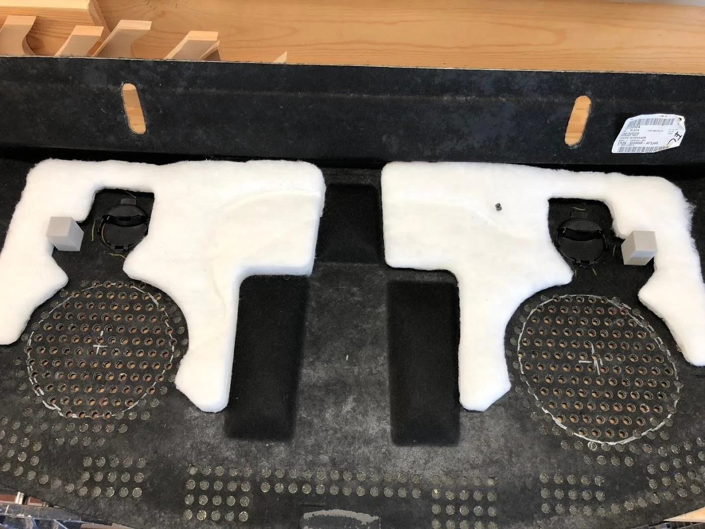

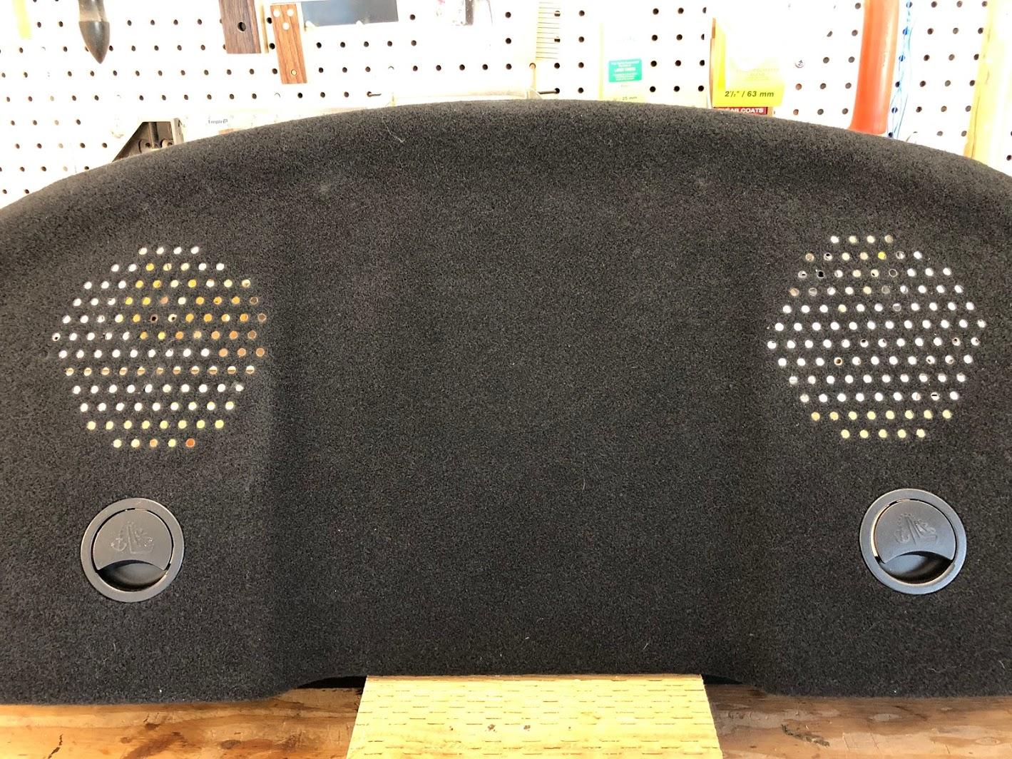

I removed the rear deck lid carpet and perforated it. Simple and the sound is quite a bit more.

What was the easiest way to create the pattern for the perforations that you made? and what tool did you use?

Well, I knew I was going to have to cut holes, so I left the factory speakers in place to do this.
1. I took the cover off, but left the factory speakers in place.
2. Then took some BLUE chalk-line chalk, and heavily dusted the foam ring around the edges of the factory speaker.
3. Gently reinstall the cover. When in place, press down on the cover until it thoroughly contacts the speaker, transferring some of the chalk to the bottom of the cover to create a blue ring.
4. Remove the cover, and the chalk rings will be very light, so I used some paint and a fine modelling brush to draw a more perfect circle where I needed to cut.
5. Use a Dremel with a cutting wheel to cut the hole. Then, use a sanding drum to smooth out the inside edges.
6. I used a thin layer of silicone RTV on the inside edges to prevent fraying of that press board they use for the cover.
7. Then installed the speaker grills.
There's a picture of the rear deck cover on the first page of the link I posted, showing the rings I painted to make sure my holes were in the right place and centered over the speakers.

You can get the rear deck carpet out without removing the rear seat but it’s a PITA and takes longer than removing the seat. Do it right and take the f’n seat out. Personally I hate speaker grills that’s why I bought a punch from Harbor Freight and perforated the carpet.
