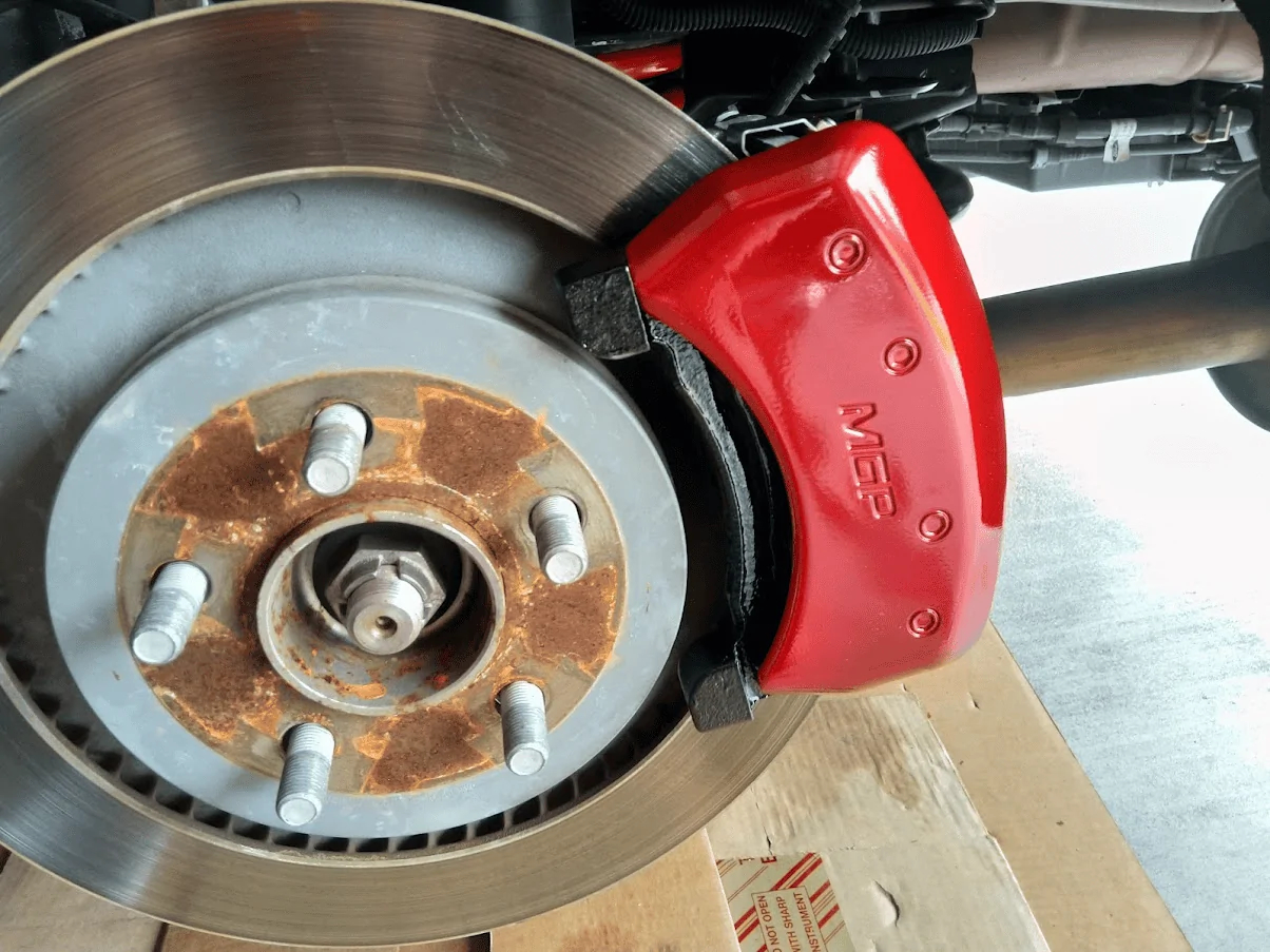

Hello everyone!
So just as a lot of you guys, I'm dreading the look of the rear calipers on my GT 2020 when the front BREMBO calibers looks great!
I looked into painting the calipers, but it both was a PITA job along with the result of just making an ugly caliper visible.
When I turned to covers, I realized that there was a lot of options and with different results and work needed.
My goal was that it should be easy to do myself, it should be fairly cheap and I wanted a solution where it was possible to take the brakes on/off for maintenance without having to cut off or ruin the covers.
This is what I used for the project:
- Caliper covers size large
- BREMBO Sticker
- Graphite grey spray paint (Find something that matches as good as possible - this was what I could get in Denmark)
- Automotive clearcoat (I found something from the same brand as the paint)
- Heat resistant silicone sealant (I found some heat resistant gasket silicone for 250degrees C (482 degrees F))
- Different tools and stuff explained through the guide.
Preparation of the original caliper:
I brushed off any dirt with a steel brush in my dremel tool and afterwards I cleaned it with petrol based cleaning agent and then isopropanyl. I only cleaned the marked area since that was where it would bind.
Covers:
The covers needs to be cut a little to fit since they are universal. I have no pictures of this process but I did it with a fresh box cutter blade and I kept cutting a little, test fit, cut again, test fit, and so on untill it was as wanted.
I took off the screws and fake brake lines. sanded the covers with fine grid for prepping it for paint. Then I painted then with 4 coats of paint and made it cure for 24 hours.
Then wet sanded it with very fine grip the both make the small flaws in the paint go away along with making it better for binding with clearcoat.
On with the stickers - might be the most tricky part to get it straight and looking good.
After the stickers has been added it is time for clear coat.
IMPORTANT! First coat of clear has to be very thin since too much will dissolve the adhesive on the stickers and make them wobble and ugly... and YES!... I did that the first time and had to sand down both covers again and start over, so make sure you're careful here!
Afterwards I glued the screws back on along with the bleed valve. I used epoxy for this.
Comparison:
In the picture the color is more off that real. Have in mind that the front brakes aren't painted and in this picture the caliper is away from light under a fender while the cover hand held out where the light makes it look brighter.
Mounting:
The silicone was added in the caliber as well as on the cover. I used a finger to spread it to make it stick better (on the cover the black lines are markings of where it will sit on the caliber). After spreading it, I added a little more on both parts to make sure it would bond together nicely.
Afterwards when pressing it on the caliper I went to town the tape to make it sit still and correct for a couple of days to make completely sure that it had cured.
Polish and coating:
After it had cured I polished them with 2500 polish compound and then coated them with CarPro CQuartz 3.0. ANd I can tell you that they are hardly picking up any dust and they are very easy to clean!
Before and after:
Final thoughts...
This was an easy project and it requires no special tools or expensive parts. It is not perfect and when you know what to look for, you can easily still see the original bracket.
It could have been done a lot prettier but I had a priority of easy maintenance as stated in the beginning.
I am really happy with the result and I can only recommend to go for it.
If you have any questions regarding this guide just hit me. Due to logistics since I'm in Denmark I might not be helpful with where you're able to find the parts others than the covers and stickers. And even those you might be able to find cheaper/easier than I could here in We-hate-funny-cars-part-of-the-world, haha!
Happy modding!
