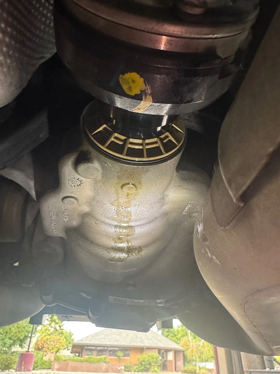

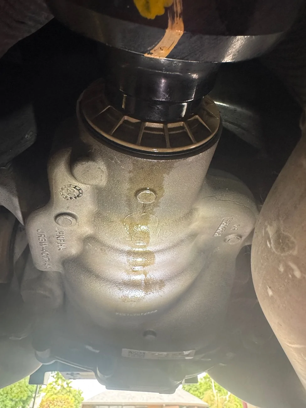

What location would this be and cause this leak I have on my diff

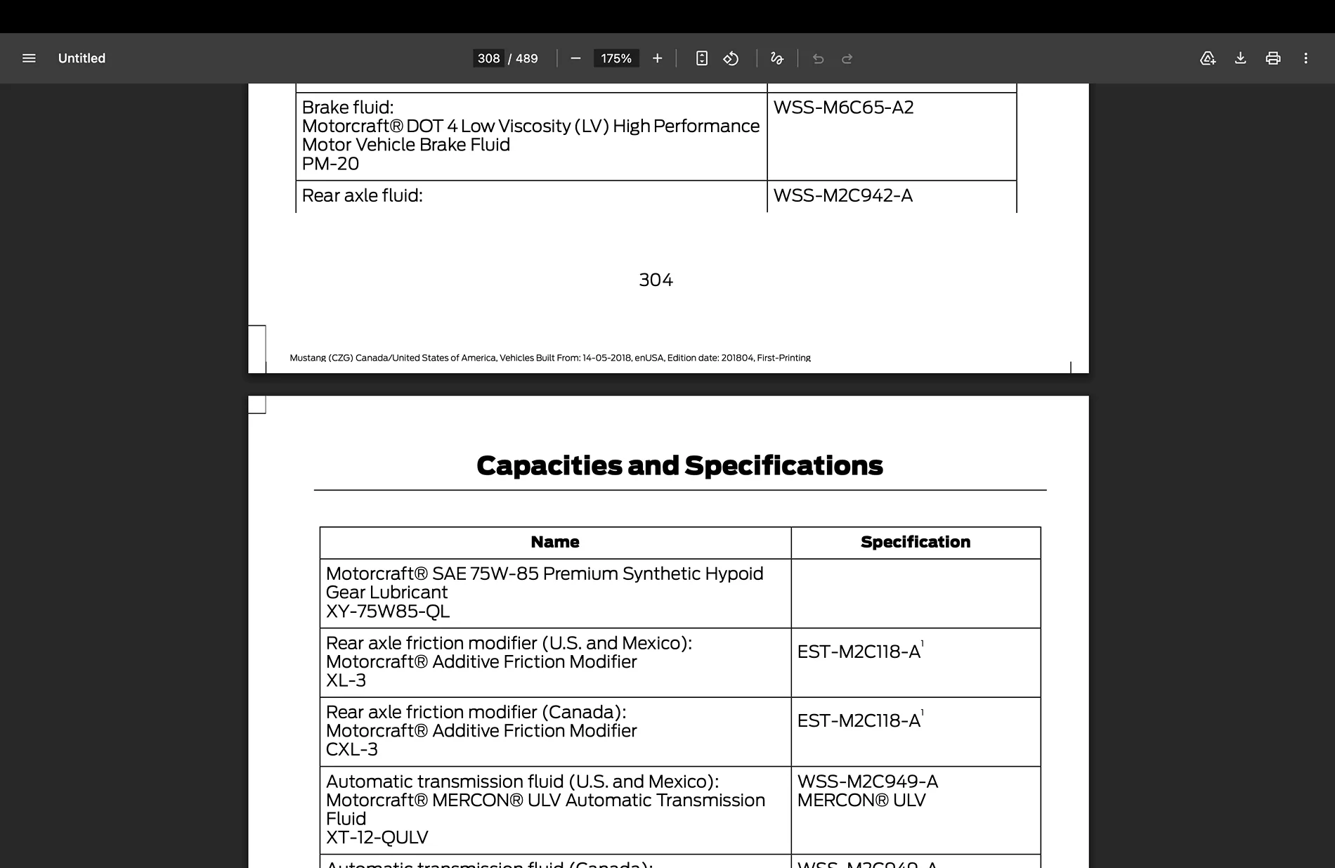

Is there a seal kit that can be purchased or will i have to get all the parts seal etc. separately? Also whats a good fluid to put back into pumpkin ?

I have never seen a seal leak/light drip at 30k.
I recently had the left axle seal replaced with fewer miles. My current thought process is it is not necessarily the seal/s, but the assembly process.
Documentaries I've seen, workers have moments to put-together things I could easily blow several hours on. I feel seals getting nicked, seated unevenly before tightening, etc, could have something to do with. It's just a thought.
Good Luck in the repair. :please:

Yea What’s crazy it a 2020 HHP eco. That’s not really beat on. hell i think it was starting to leak at like 15000 or 20k i just thought it was something she picked up off the highway.
