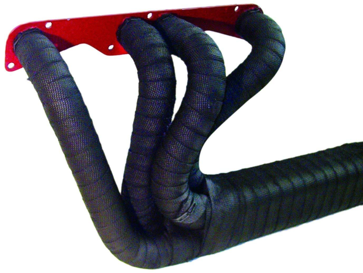

Is there any way to insulate the exhaust piping where they pass by the diff? No need to add any heat gain to the diff or even to the air in its immediate vicinity if diff heat is a known issue here.
