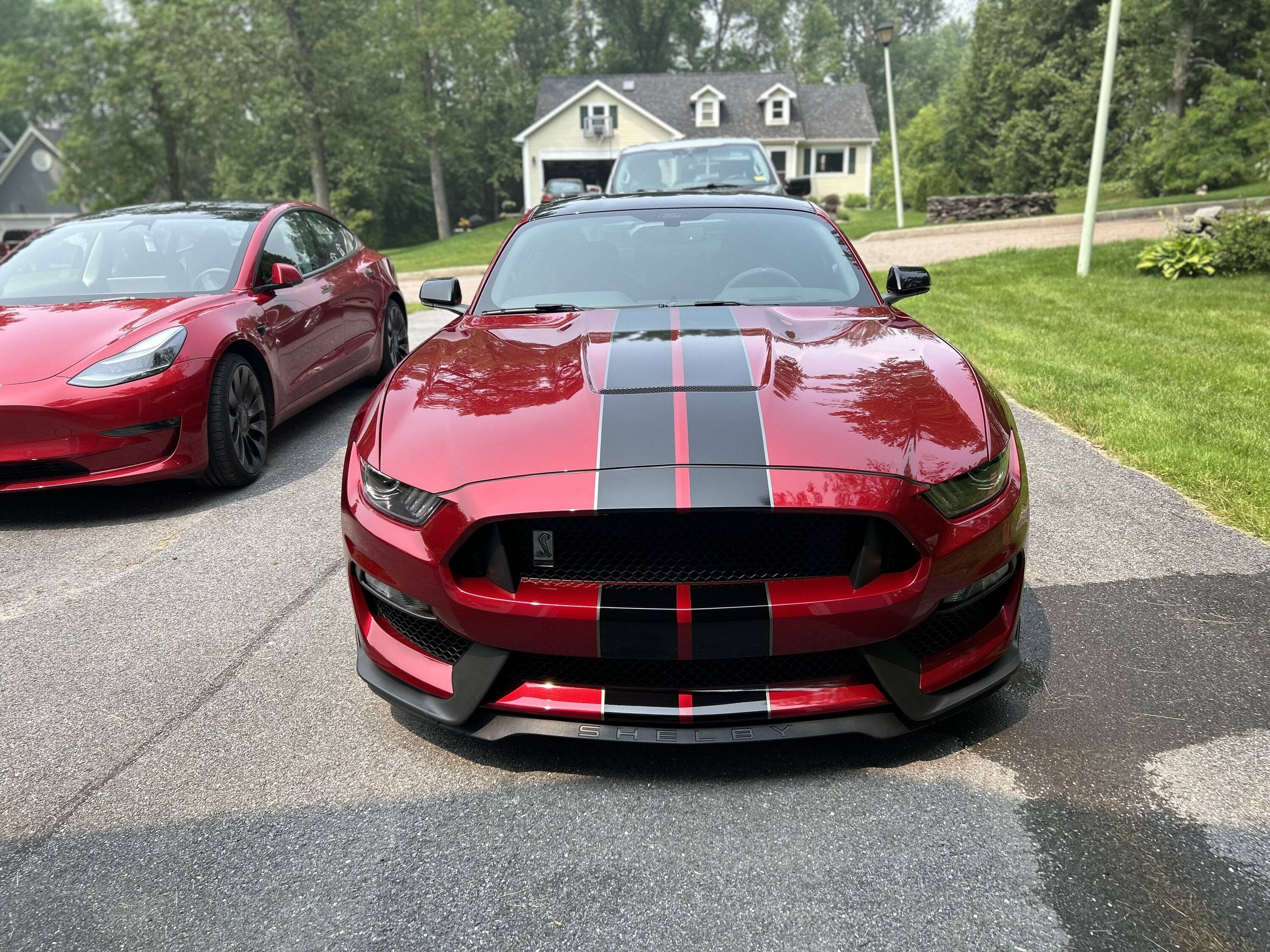

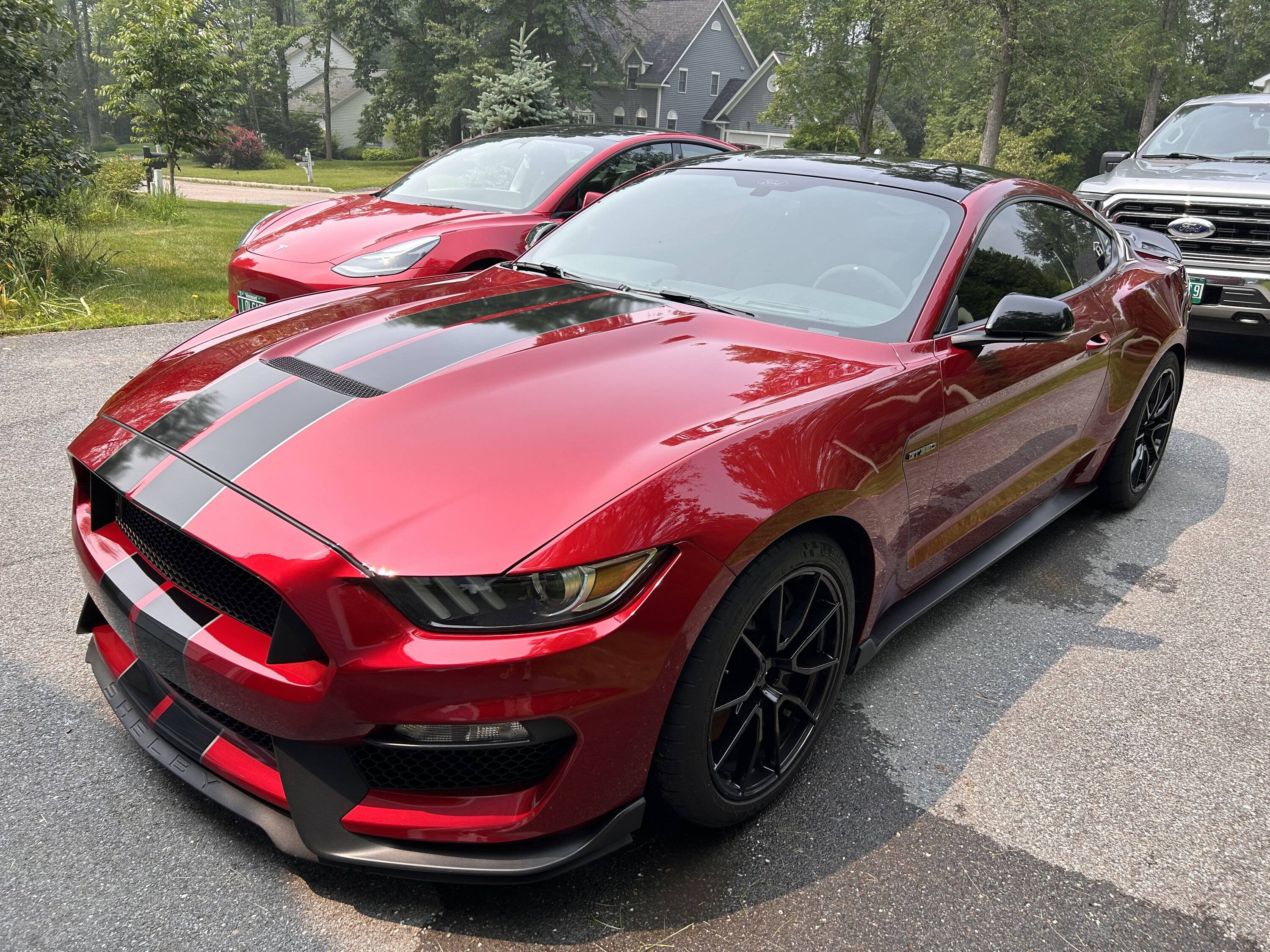

I have a GT350 and the vinyl stripe has some etching from acid rain in it. For the paint I can remove with some buffing, but I don't think I can buff the stripe. I am unsure how delicate the stripe is.
Can U buff the stripe?
