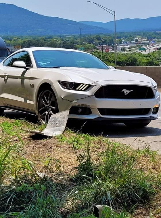

My wife has a totally stock '17 GT. I've recently noticed the a fan is running constantly. Looking at the owners manual, I removed relay #91 and it stopped. I metered the relay but I don't know what it should read. The large contact spades (the load, I assume) read open but the control contacts read .08 ohms. Is that normal?
As an aside, recently a piece of treadplate flew off a truck and wedged into the front bumper. The bumper and headlight were replaced. Could this have caused the problem? It began over a month after the repair.

I just ohmed the relay and another that has the same schematic. They measured the same. I'm leaning toward the likelihood that the harness was damaged when the metal went through the bumper.

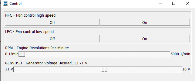

if you have forscan, or know someone locally with it you can control the fans. If you command the low speed fan off and it doesn't shut off then there could be a relay problem. i use the high speed control when sitting in the pits between track sessions.
