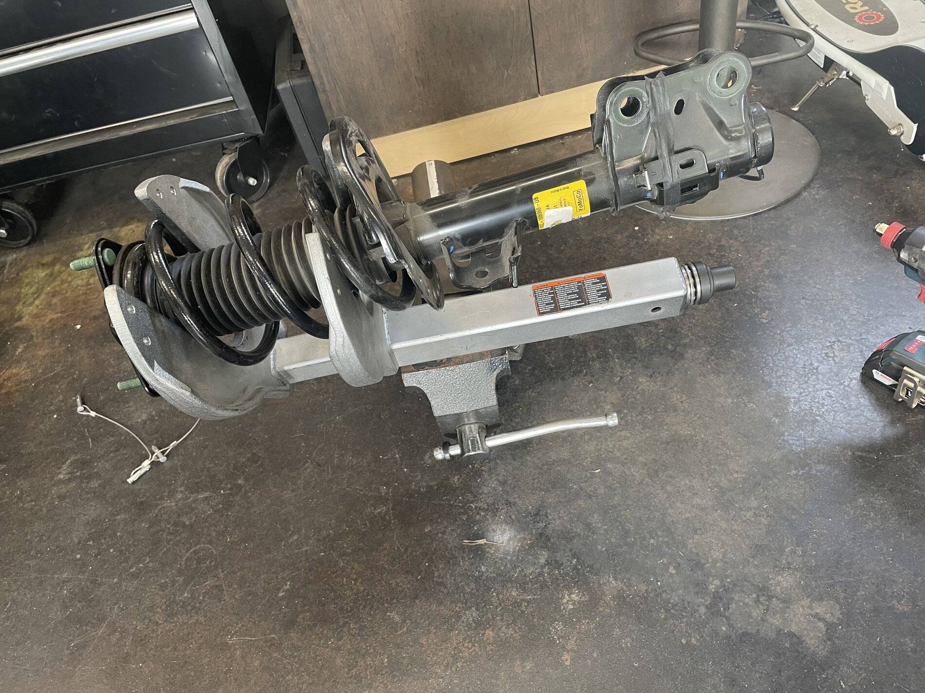

The only local shop I trust is a racecar shop, and they quoted me $1100.00 for installing Steeda dual rate Magneride springs I supply. Another $300.00 for corner-balancing alignment.
So I took it to the most trust worthy, cost effective person I know.
Myself. 😝
Spent like 2 days on my knees, which screwed up my left knee and caused Bursitis. Took me out of CrossFit/Gym for 30 days. First real ever medical issue that’s put me out for a while (pretty healthy).
I’d do it again though, because I’ve now taken apart the brakes/wheels/tires/suspension multiple times now. Really getting to know the platform (new to Mustangs).
Steeda F/R sway bars and Upper strut brace are on the floor waiting to install next.
This free rental from Autozone was a lifesaver. Took me multiple hours to come to the conclusion my old school spring compressors just weren’t going to work.
Myself. 😝
I have a set of spring compressors that look like the picture below. Never had a problem with them. Used on normal, lowering, and lifted springs. Definitely have to take your time and make sure the spring compressor is on both sides and equally compressing weight. If this thing were to come loose or you don't equally compress the spring with how much tension it takes to compress some springs, best case scenario is pain and blood. Worse case is death. Respect the tool, but it isn't hard to use with the proper precautions either.
Regarding what the OP posted, usually shops around here will quote a higher labor price if you bring your own parts. Shops don't just make money off of labor, they make money off of parts as well. You are taking the money off of parts away. Get a second opinion, but don't be surprised if the quote is similar from the second shop.

Is that a spring compressor that Autozone rents ? I've done three different sets of struts with cheap compressors and one thing that would make this job easier, quicker and less sketchy would be a nice, shop level spring compressor.
I have 2 sets of those - 1 modified to adjust Kings while on my 4x without removal. I’m very familiar with them - been lowering cars are raising trucks for over 20 years. Sucks trying to find the exact spot on the spring to place each clamp, then come to find out once you spent all the time going back and forth tightening evenly, you have to undo it and do it all over again because the spring didn’t compress enough. And the center bolt sure bends like hell on King springs.
I’m telling ya, the AutoZone clamshell, worth every minute to drive there and back just for peace of mind. I’m contemplating purchasing one, they’re $200.00.
