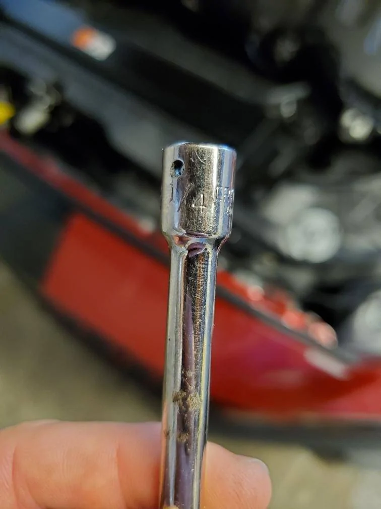

1.

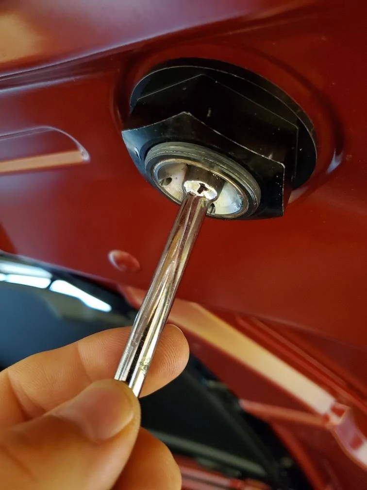

Find a 1/4" ratchet extension. You will be using both ends of this tool to manipulate the mechanism.
The larger end resets the mechanism

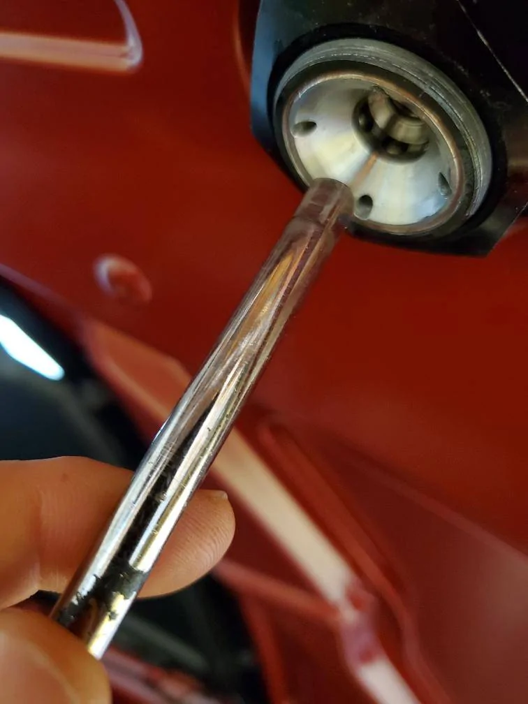

The shorter end resets the mechanism button

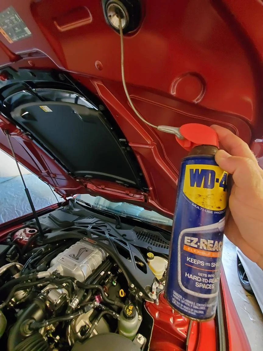

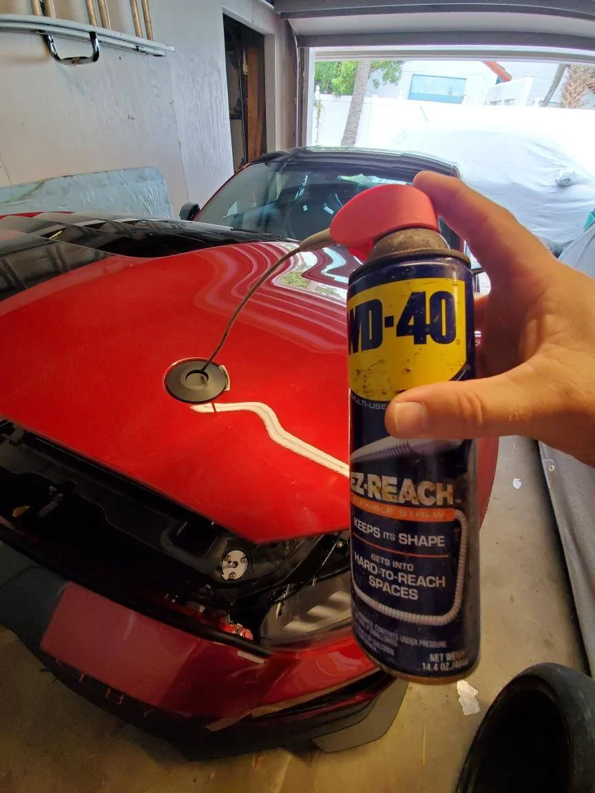

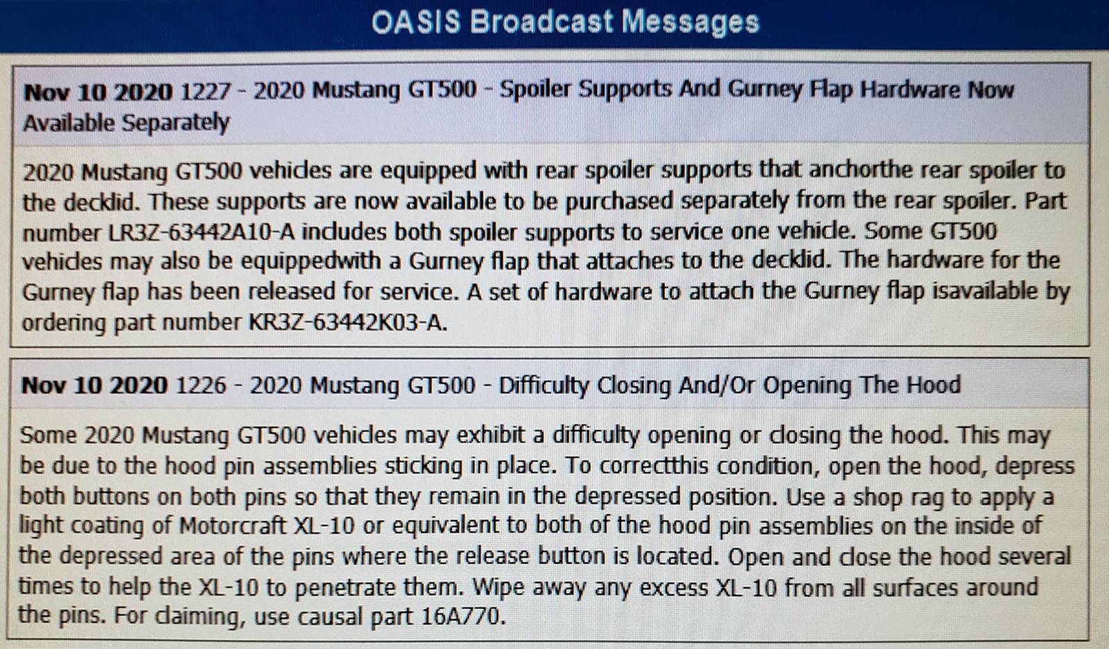

2. Use your choice of lubricant and apply into the top of the depressed button on top of the hood. (the OASIS recommendation is to apply Motorcraft XL 10). The WD40 shown was part of the experimental procedure to establish principle. See the OASIS message below (courtesy of @kilobravo)

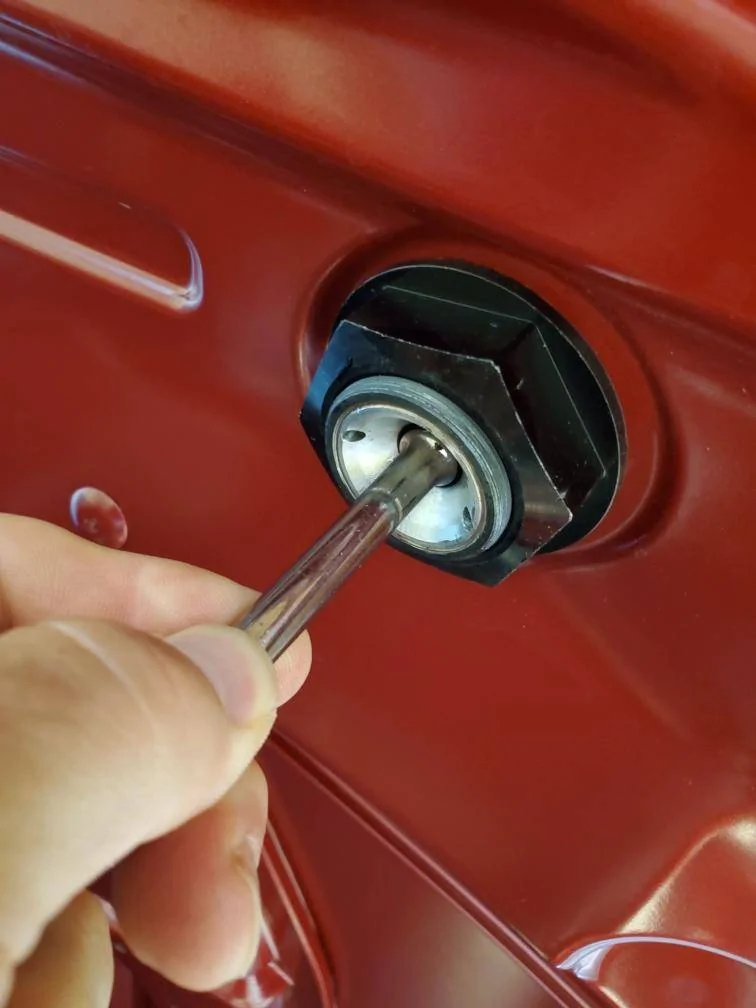

3. Using the large end of the 1/4" ratchet extension as seen in step 1, push it in until the mechanism resets. Then use the small end of the ratchet extension and push it in to reset the button. As per the OASIS procedure, they recommend opening and closing the hood several times. Using the ratchet extension is faster and allows you to feel when the mechanism becomes loose again. See below.
Set in it, then push
ratchet extension pushed in (shown below)
The small end of the ratchet extension will reset the button.
Next, press the top button of the latch in and repeat the mechanism reset.
That's it, keep repeating the manipulation of the latch mechanism until it frees up and becomes smooth. The WD-40 that I used a long time ago is still working great. I think they decided to use the XL10 lube is that it probably will be more persistent over time.

Keep in mind Ford's recommendation is to use XL10 lube.

As always, many thanks for the in-depth description regarding how to deal with sticky pins, Tomasino. I've only pushed the pins on one other car and both seemed to me to be about the same difficulty. Most excellent find on the quarter inch extension, that looks perfect for the job.
But, being a good sailor, I ordered some of that XL-10. As usual, Motocraft is mighty proud of that silicone lube. :cool:
