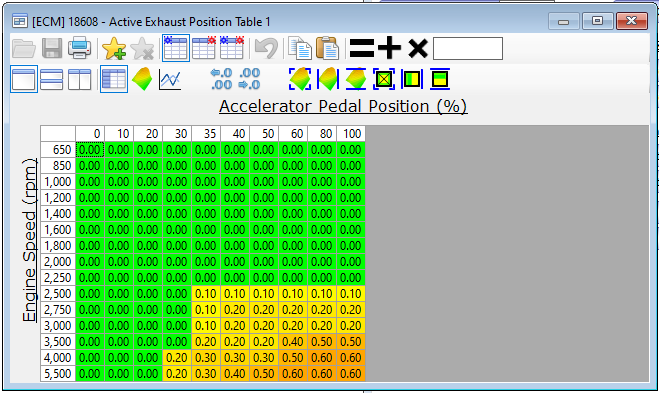

Am I understanding it correctly that if you have exhaust in quiet mode, the exhaust will open up as you get on it ? If so, is there a certain rpm or what triggers it ?
Leigh_bullitt
Feb 12, 2021
67
797
242
Spain
Mustang Bullitt
Yes it’s throttle % x Rpm related
This is what the Quiet setting on a 2019 Mustang GT looks like in HP Tuners:

Yeh I had mine tuned differently in quiet mode. It opens sooner on mine. Great on the highway. Suddenly opens when overtaking.
Would there be a negative effect to a table change that keeps it closed? Essentially trading power away for a quieter exhaust? Just so the OP could comply with the noise restrictions at this track.
Not really
Their is not enough back pressure to cause any concern

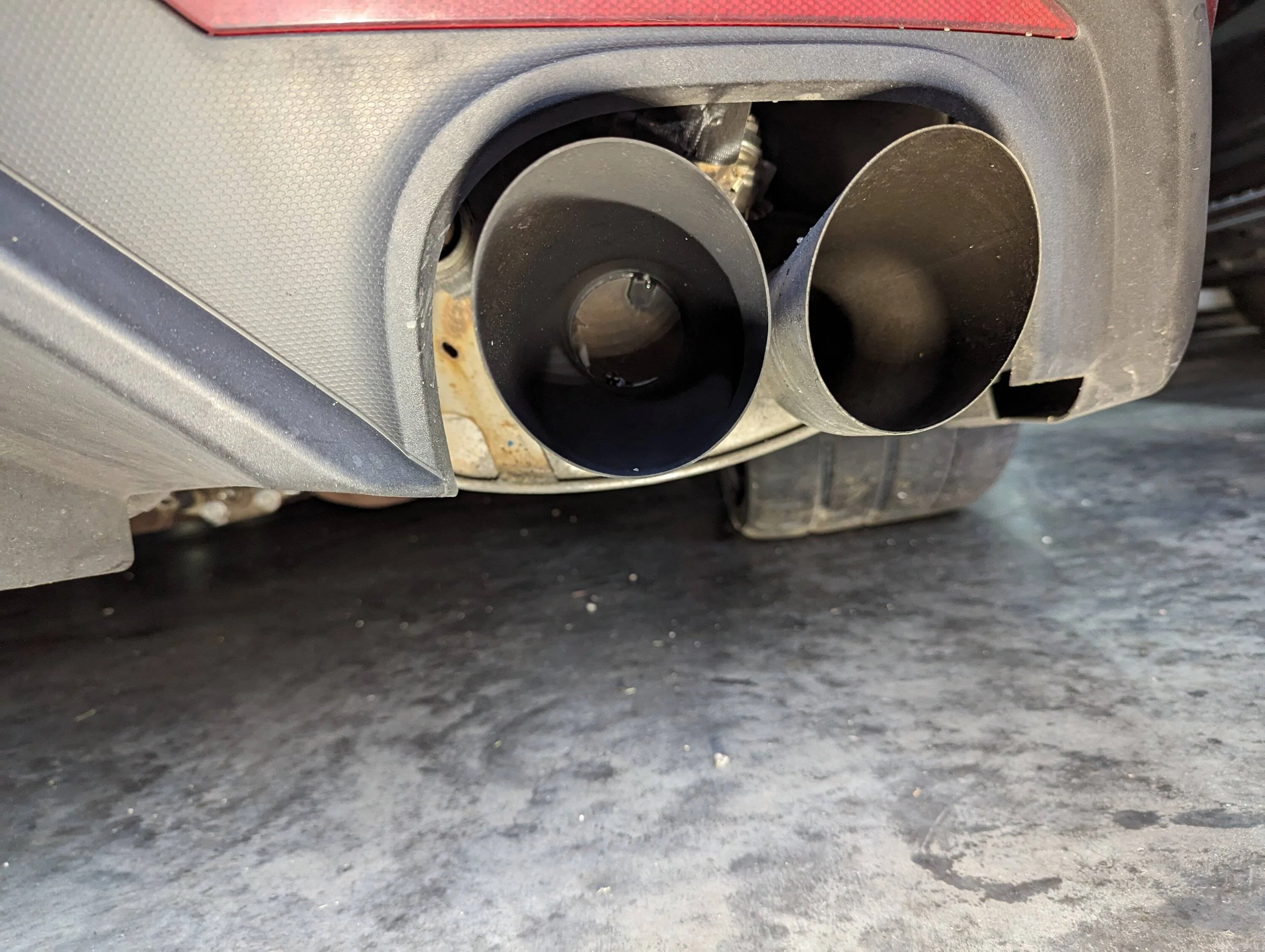

Here - once and for all - I promise this isn't 20 minutes long video when I talk about what active exhaust is, why it's great or not, what the fuse does and so on. It is a minute long.
Car is in quiet mode, valve is closed, I pull the fuse (car will show Normal mode and likely exhaust mode selection unavailable at start up) and valve stays closed.
All added picture of a closed valve with car running and fuse pulled with flashlight (since it's kinda dark in the video).
Same thing worked on friend's Mach 1.
@Turbeau @Leigh_bullitt
Love this option versus having to fab some sort of add on pipe or modify the exhaust. If they yell at me at Laguna in “quiet mode,” I’ll go this route for sure. Thank you.👍
