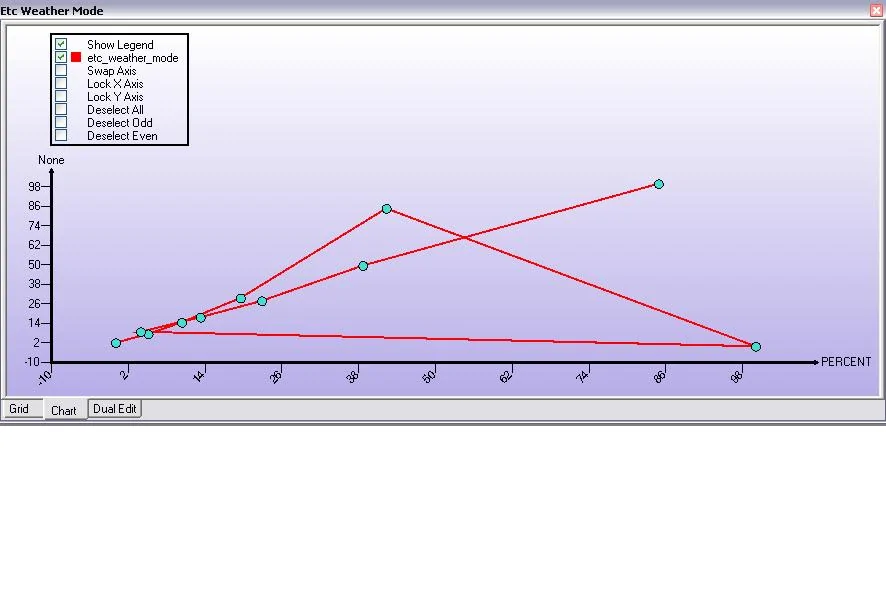

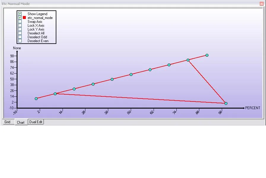

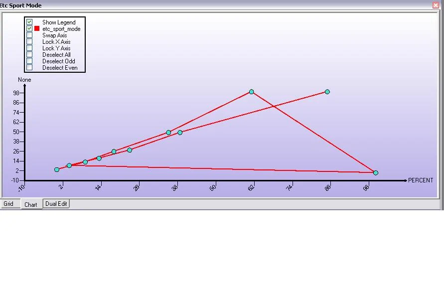

Here are the graphs from sport, normal and weather. As you can see those adapters do the same thing as tuning it with regards to feel, the throttle body only opens to a certain angle, how fast or soon it gets there is a factor of moving the points to the left.
