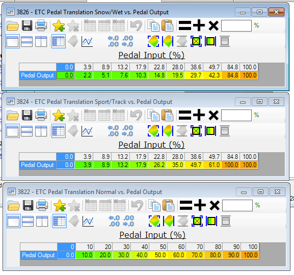

Here are the tables you could ask your tuner to modify. Top one is snow/rain, middle one is sport/track and bottom one is normal. Note how it converts peddle input to peddle output, so if you were looking for a more aggressive peddle you could make it ramp up to 100% faster. Don't let your tuner tell you this shit can't be done.
