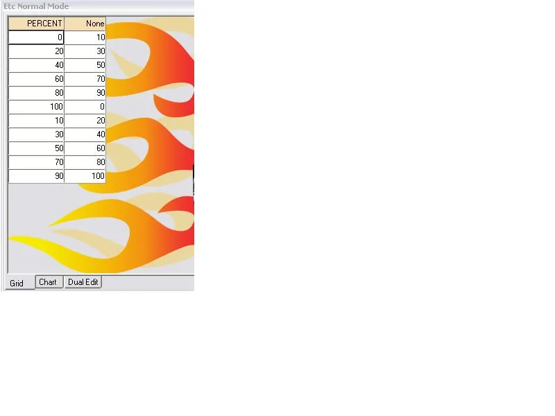

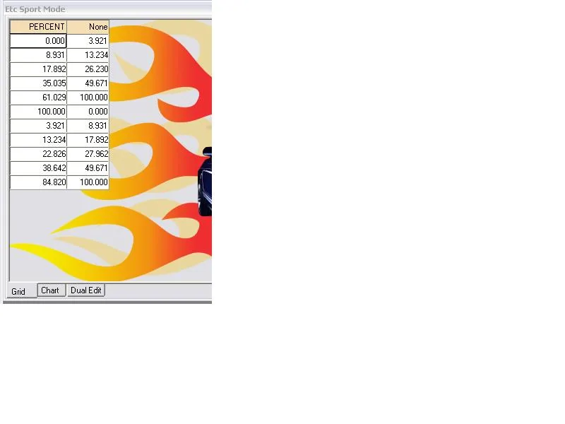

just for reference, heres the difference between normal and sport on the PP Cars.
if you have a tune or tuner, you can have the sport mode applied to your normal non PP etc
Are you sure it's just PP cars or are you talking about Premium cars? I have a Premium non-PP but have Normal, Sport +, Track and Rain/Snow. I can definitely feel the differences in throttle response between them. I had assumed that would've been the same.
Side note, would you happen to have the same table for the Track mode? Curious how different that might be.
Dolsvt00
Sep 21, 2015
151
43
Charleston
15 5.0
Track is the same as sport, rain snow is less than norm. I guess i should have said pp/premium, base cars don't have the sport table at all in the tune.
