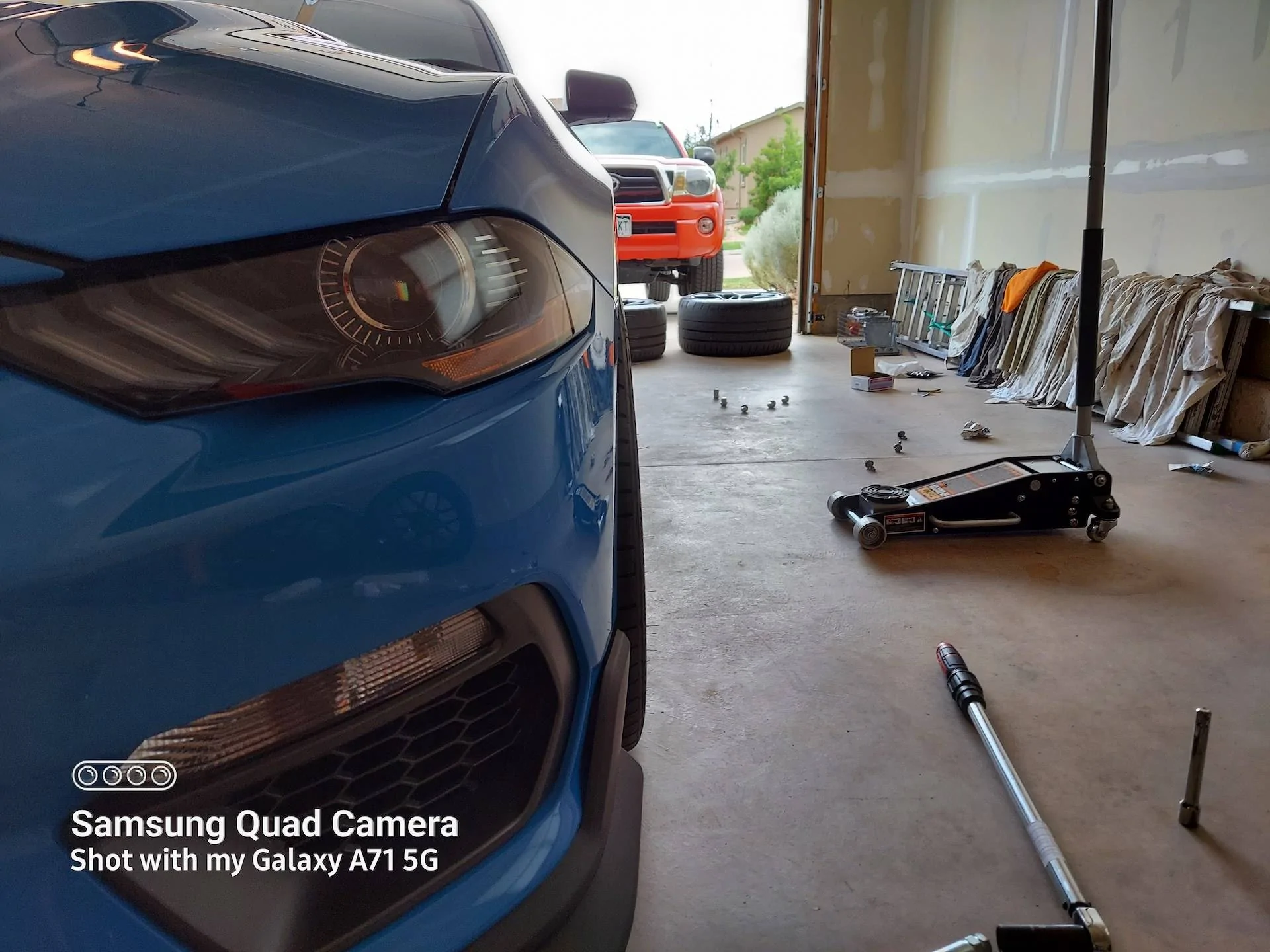

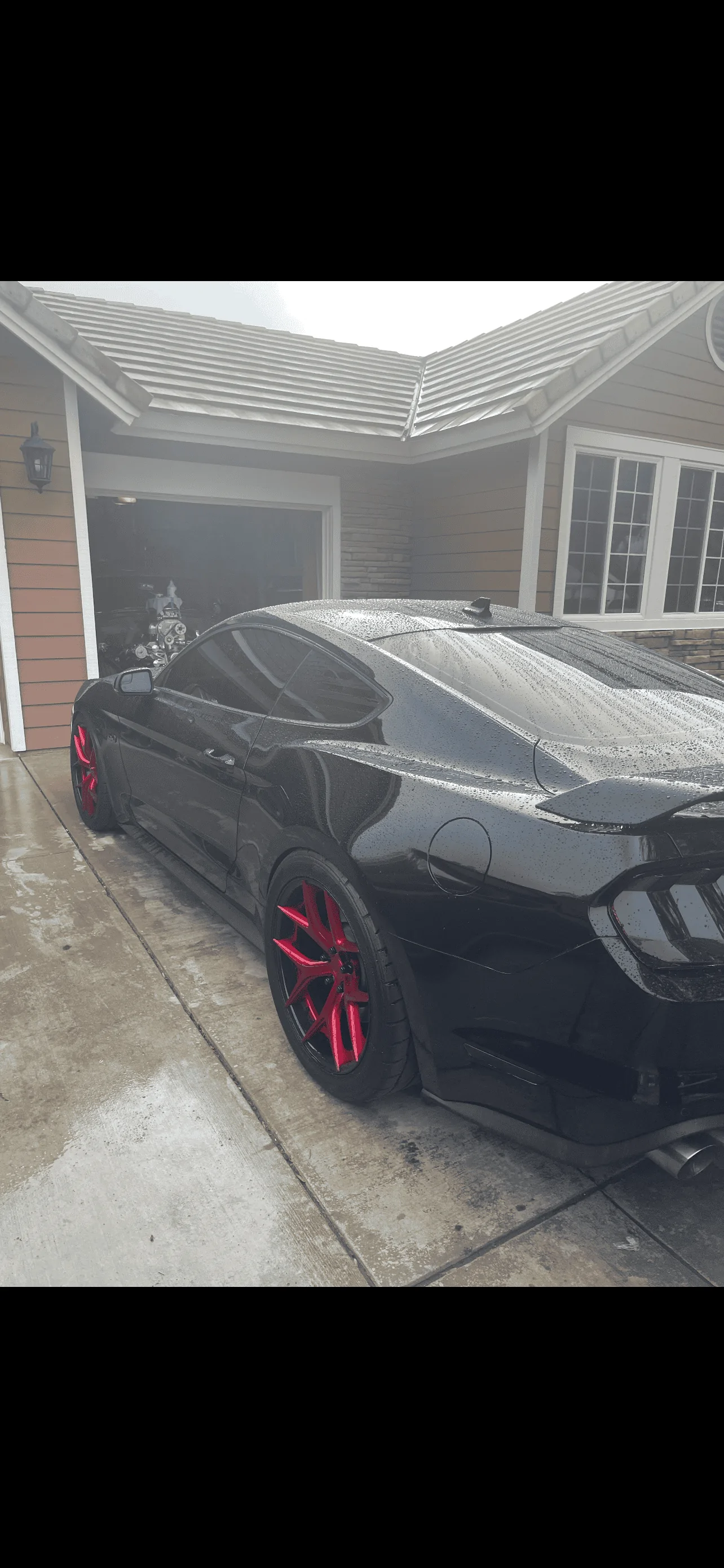

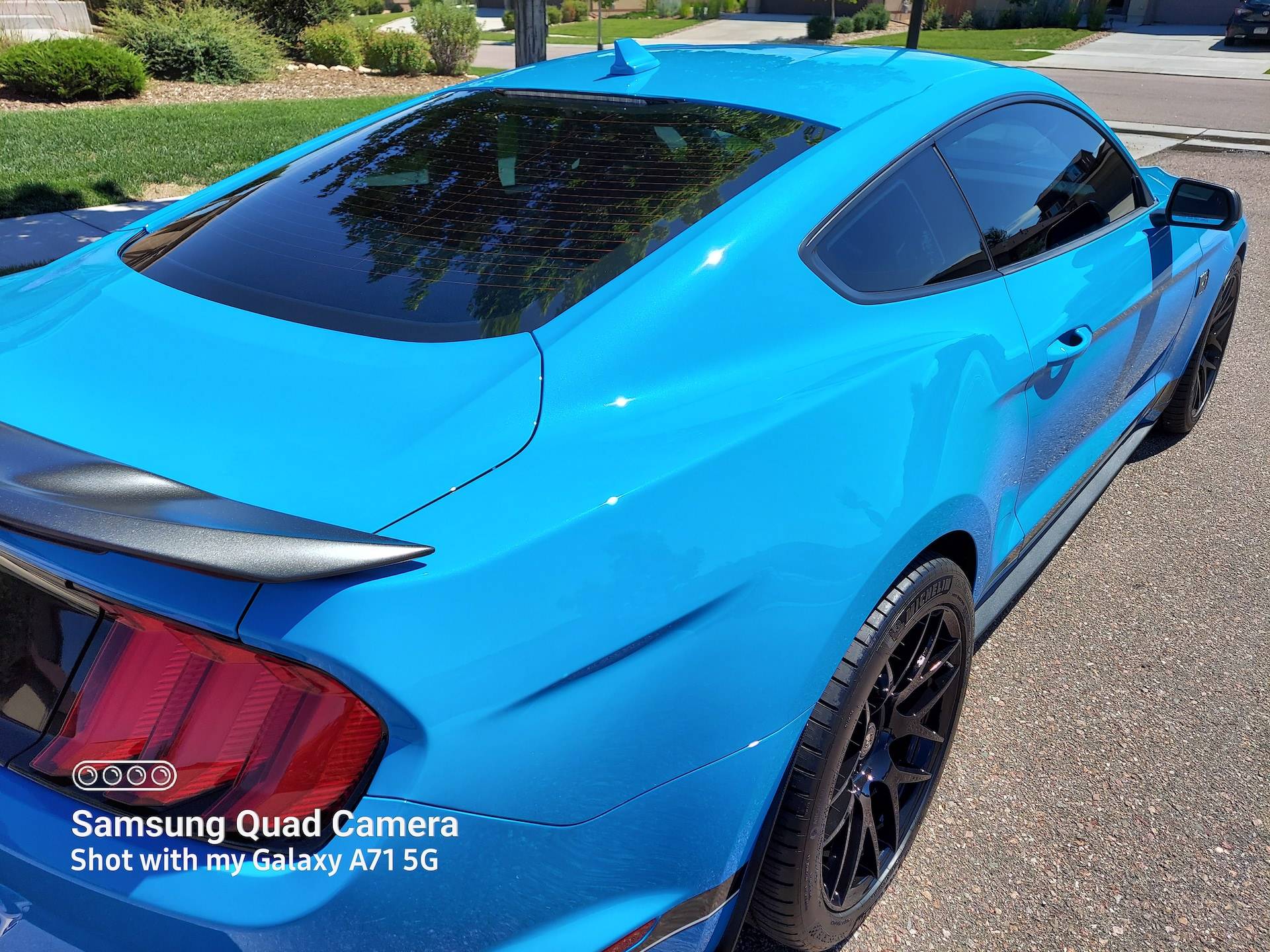

with a 10" front on 285 they will poke out a bit. Now are you wanting your rim flush, or the wheel. You can get it to be flush with a bit of camber. I have 9.5 ET35 on 235 with a spacer and i poke just a tad bit. My rears are 10.5 ET40 on 305 and im poking. So i think you might want ET40 to get closer to flush with your fronts. The pics of my setup, my rims sit flush with the body not my tires. Oh and my front wheel wasn't straight... I see that now. But you should check out the fitment industries website and browse their gallery of mustangs. All types of setups and offsets and tires. Even tells you if they sit flush or not. Give it a look... Good luck

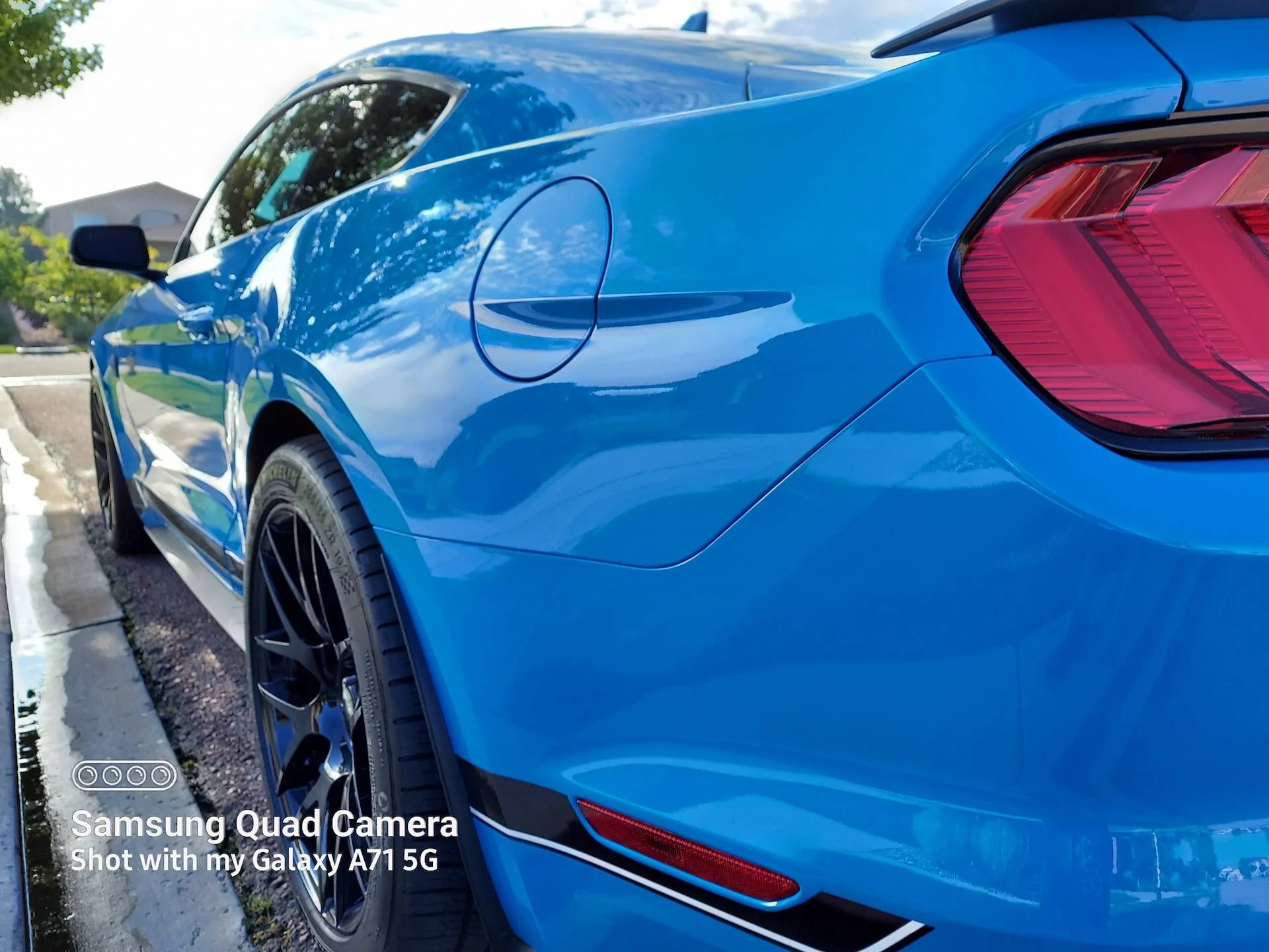

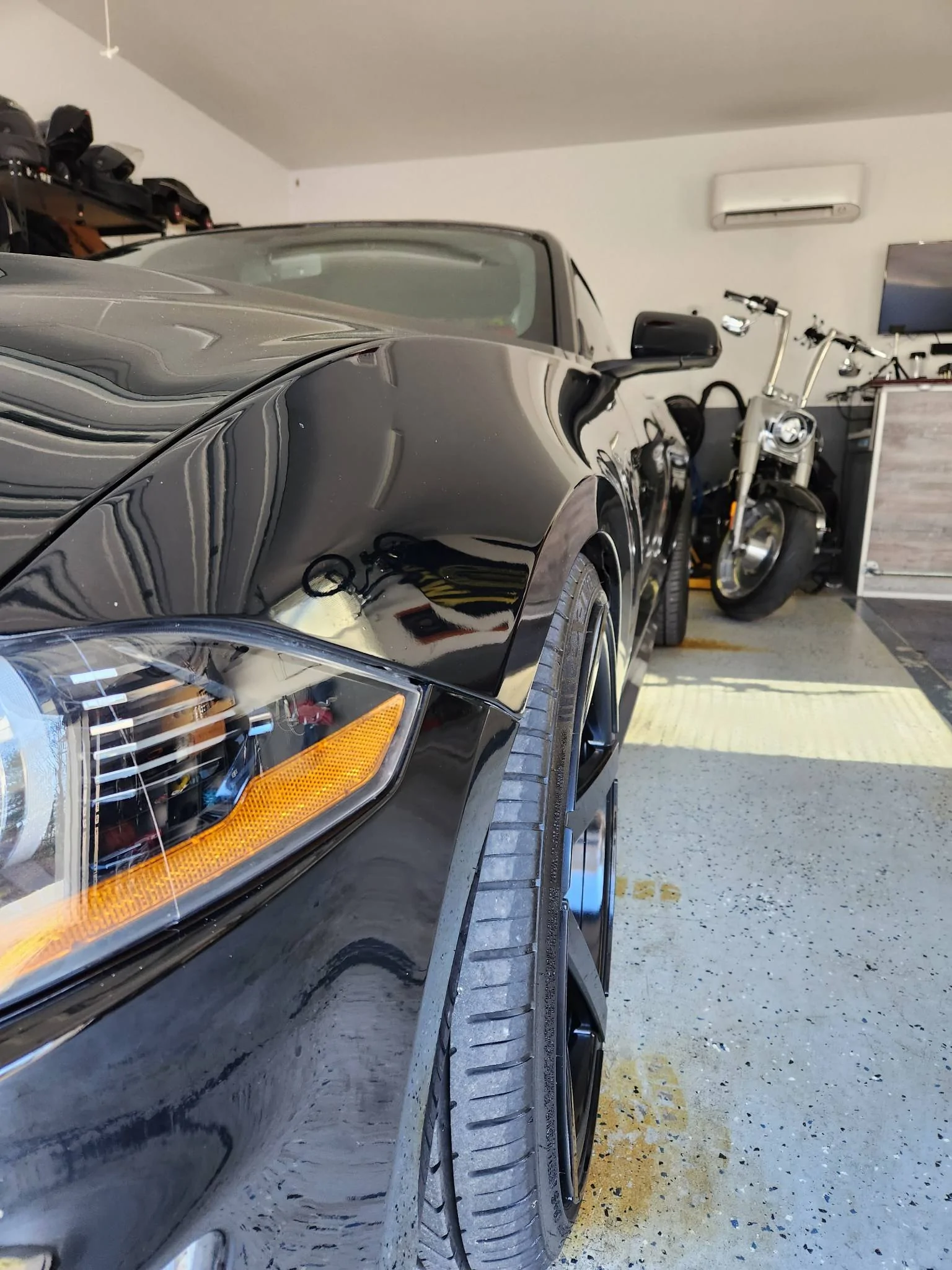

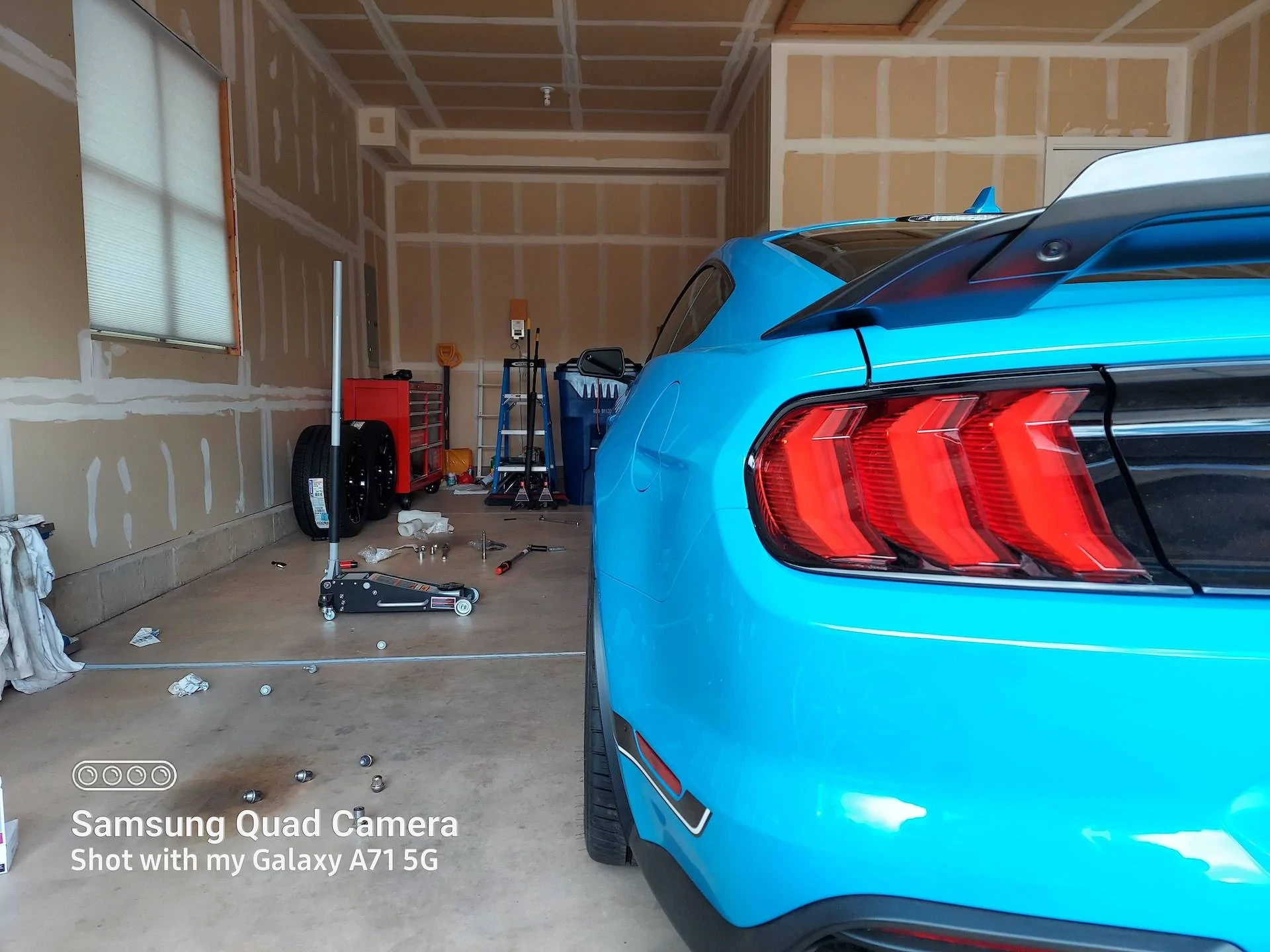

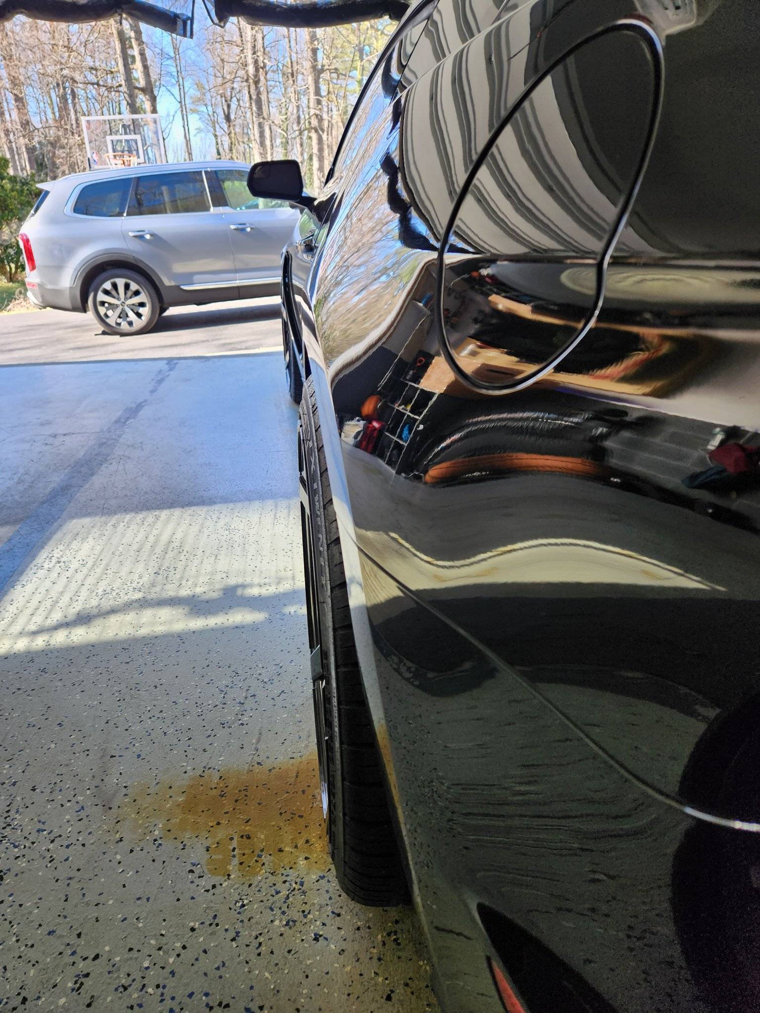

Attached are photos of Skye. I'm using 19x10, +35, square, 285/35/19.
For the suggested rear, I'm concerned about your offset: +35.
If sticking with a +35 on the rear and expanding that to a 19x11, I believe the tire will extend inward and outward another 1/2 inch, or 13 mm.
As a reference, the factory Mach 1 HP rim, rear, is a 19x11, +52.5 offset, 315/30/19.
Unless you'll be making rear suspension changes, I think you need to adjust the rear offset to a larger number.
