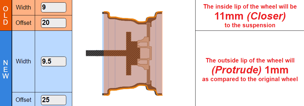

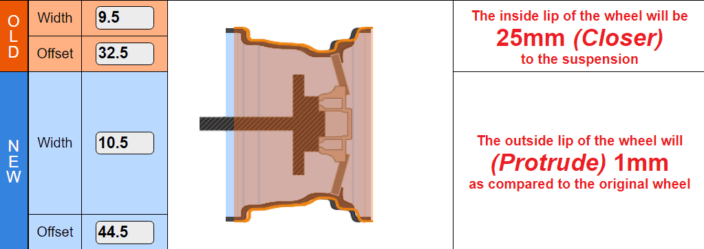

Here's a visual of the purposed fitment:
-FRONT-
-REAR-
Is this visualizer available on your website?

That’s perfect, thanks a lot. Now I don’t have to do the math.
