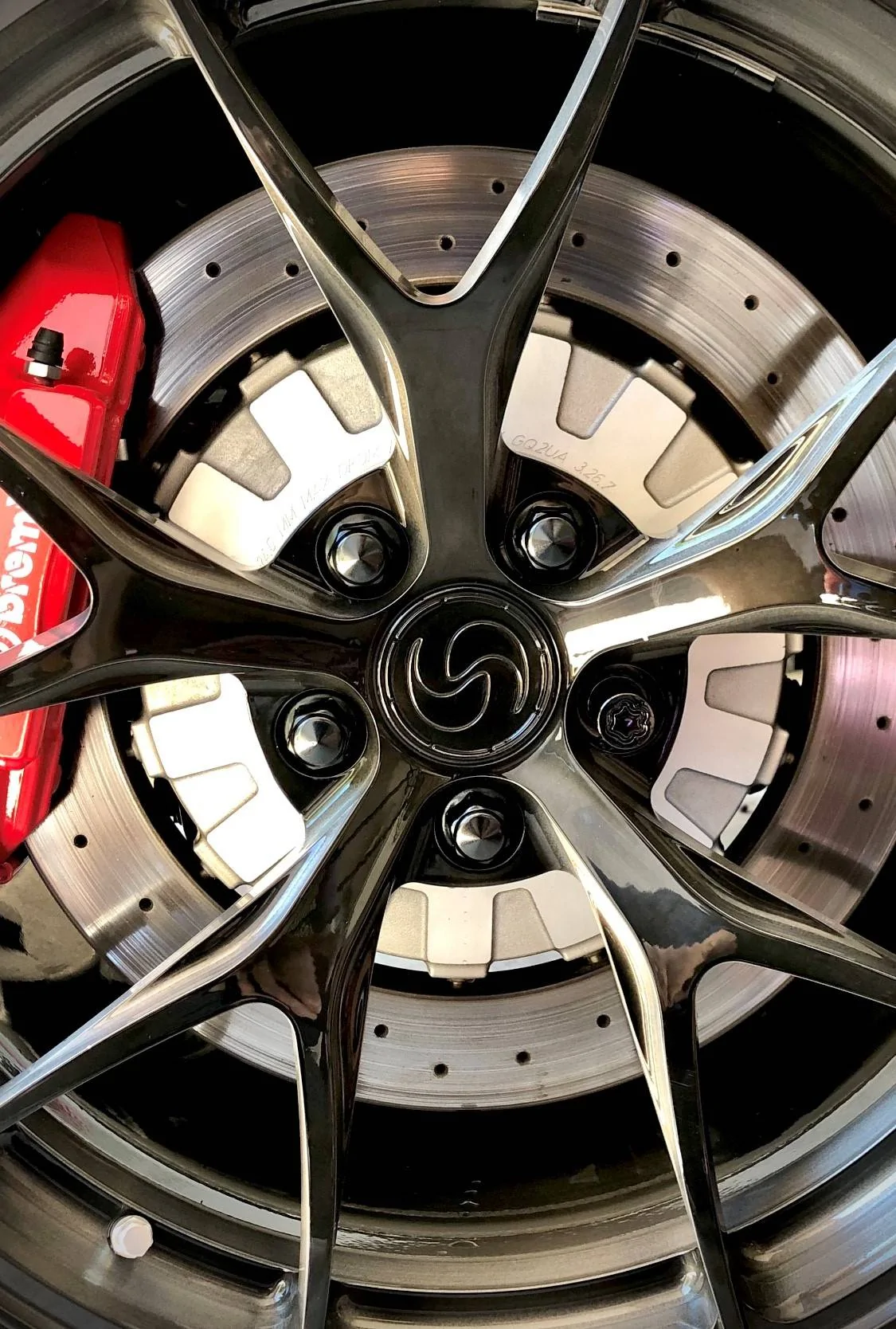

There isn't an advantage per se, but some lugs weigh less than others. Titanium lug nuts cut a small amount of rotating mass due to the how light they are, but that comes at a high cost with $.
When I switched out for aftermarket wheels, I went with the Ford Performance Black Lug Nuts, which are what we already have but in chrome. I also used McGard Black Tuner Wheel Locks 25116 for a sprinkle of safety and they handled the high torque settings just fine.
As long as you're not letting the kids at Discount Tire go at your lugs with the impact wrench, they should last quite a while. Also make sure the lug seating on the wheel matches the lug style you plan to use, ie., conical or ball.

I us a 21mm and it fits like a glove.
I'm also pretty sure the nuts are supposed to be metric. Probably part of the reason why @460Fred has had some issues is using the 7/8" instead. The socket is loose because the 7/8 is more than a mm too large.
However I do agree with Fred that the factory lugs are junky. I just bought new lugs for my GT because I noticed that several of the existing lugs are deformed and it's getting difficult to get the metric socket onto them. Also, I think a silver lug on a black wheel looks goofy.
