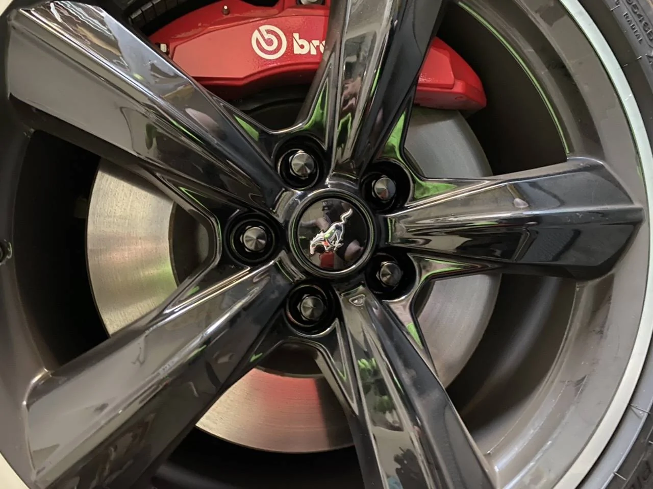

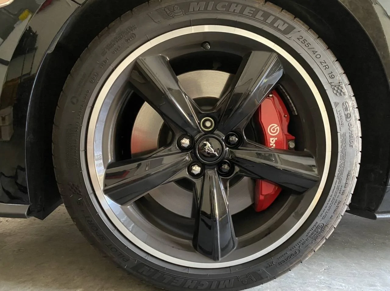

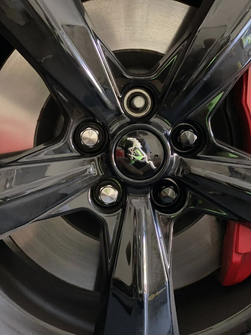

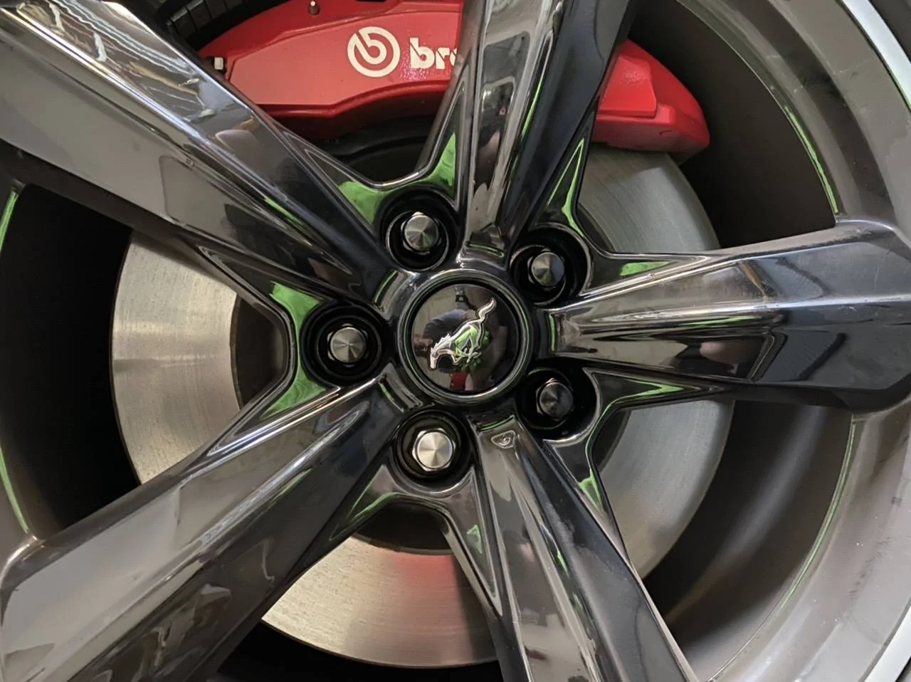

Exchanged the stock chrome lugs for FP black lug nuts. In my opinion they look much nicer than the chrome lug nuts, especially if you have back wheels. A good quality torque wrench, and 21mm thin-walled non-marring socket is all you should need. Hope the before and after pics help those who are thinking about replacing.
