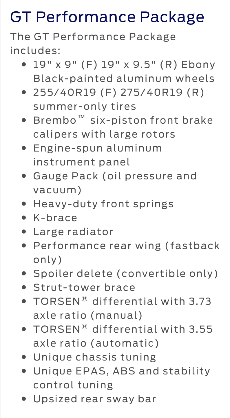

I just traded my 2021 for a 2022 Grabber blue metallic with performance pack. I know that it comes with some upgraded items on the vehicle such as brembo but what else is upgraded.
Does the suspension come upgraded and would be considered OK? or does it need to be beefed up a bit. What about sway bars, shocks, etc...

PP includes the brakes the strut tower brace and the extra guages in the center stack. I believe the sway bars are a little bit beefed up as well. Also the tires are larger (255 40 and 275 40 staggered). Not sure what else. Mine is a PP with magneride.. Congrats on the new ride. I've got a GT Premium PP in Grabber Blue metallic as well.

PP1 car here. The front struts and rear dampers are a slight upgrade over base models. But that's not offering much. One of the first things I did suspension wise, was change out the rear dampers. They did not control the up and down rear movement and made for a bumpy experience on the street. I changed them for the Ford Performance track dampers. It made a huge difference. You can stop there and be happy with how it handles. I was craving a bit more a year later, so I also did the the front struts, lowering springs all around, and the rear cradle lock-outs.
The PP1 also comes with Michelin Pilot Sport 4S tires which are fantastic tires. The downside is the rims are way too heavy.

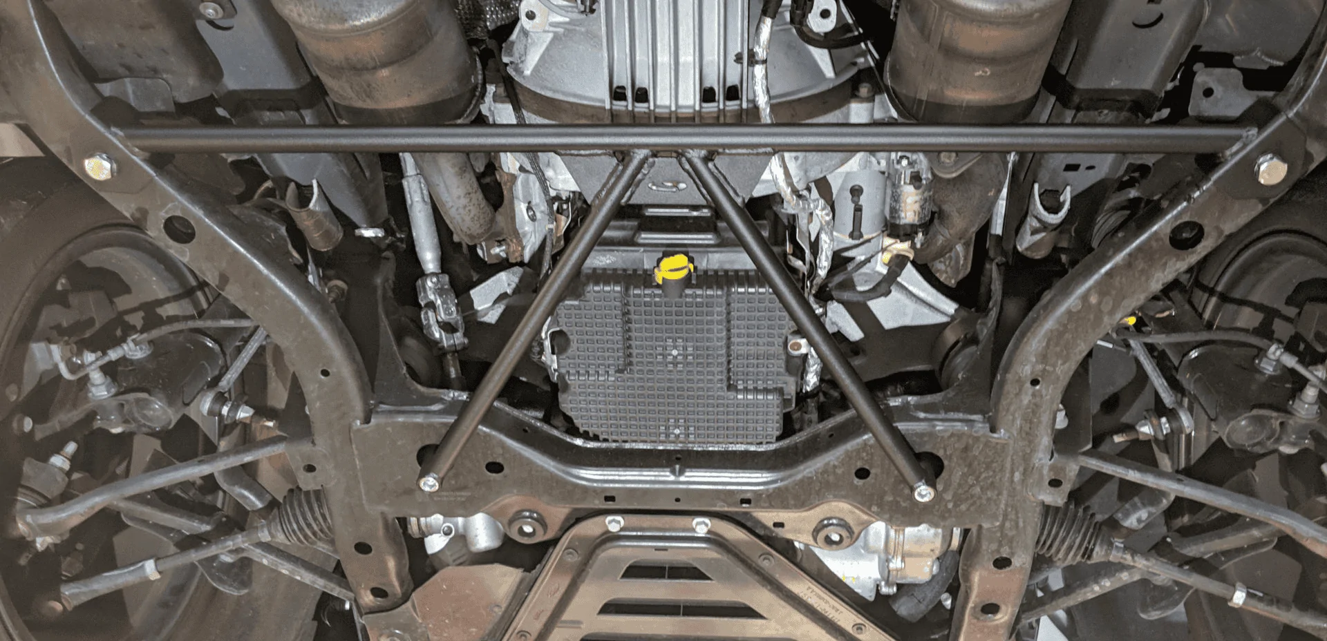

Did you notice a difference with that brace ?
StangTime
Apr 16, 2019
81
3,594
4,094
Ontario 🇨🇦
Todd
19' GT PP1 Manual
I can't answer that because that's not a pic of my car. I don't have this brace. But general consensus from others is yes, it helps in the turns.
