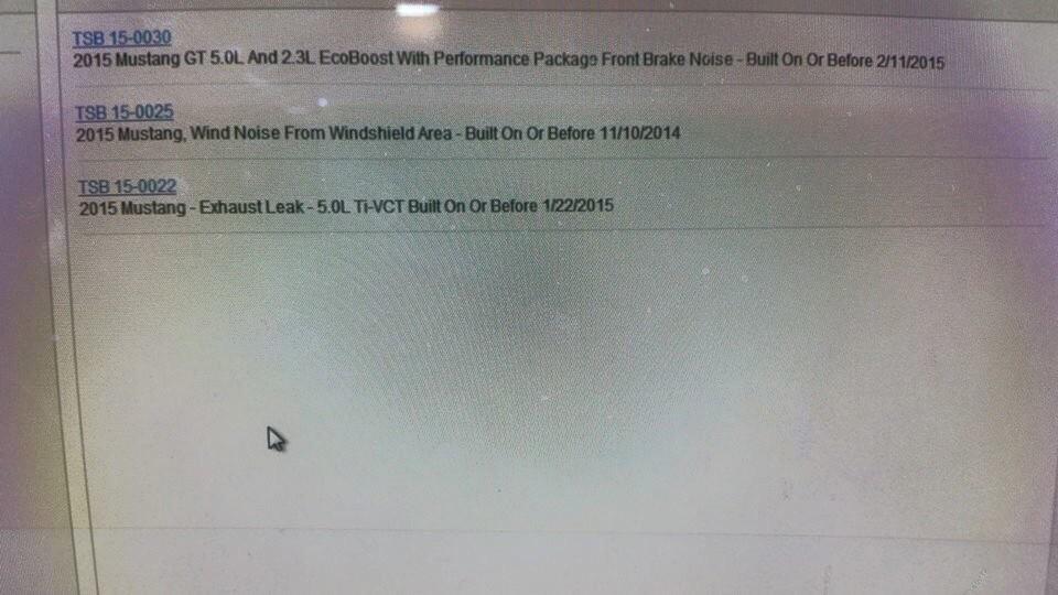

Spoke too soon. Got the PP brake rubbing noise, and am taking it in Thurssay for the TSB
You do realize that the TSB does not cover the GTPP, right? It's for the EcoBoost PP and the non-PP GT. Those 2 cars have the same brakes.
To summarize:
V6, Non-PP EcoBoost = same brakes
EcoBoost, Non-PP GT = same brakes
GT PP = unique brakes
The title of the TSB is poorly written and vague, but the important thing to consider is that it only contains 2 part numbers - one is the rotor, and the other is the pads. If the TSB applied to both PP models, as some people think, it would need at least 2 more part numbers - because the GT PP rotors are an inch larger in diameter and the six piston calipers use different pads than the 4 piston non-PP ones.

My service advisor isn't so good at advising I guess. I'll doublecHeck with him Monday

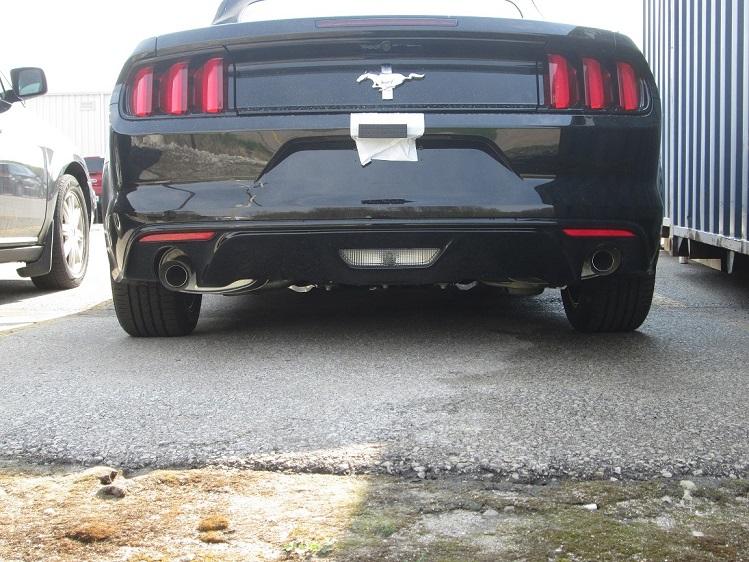

I was kind of the same way as the stock muffler was hanging down on the driver's side, but since I had my magnaflows in reserve I scored the car perfect.
