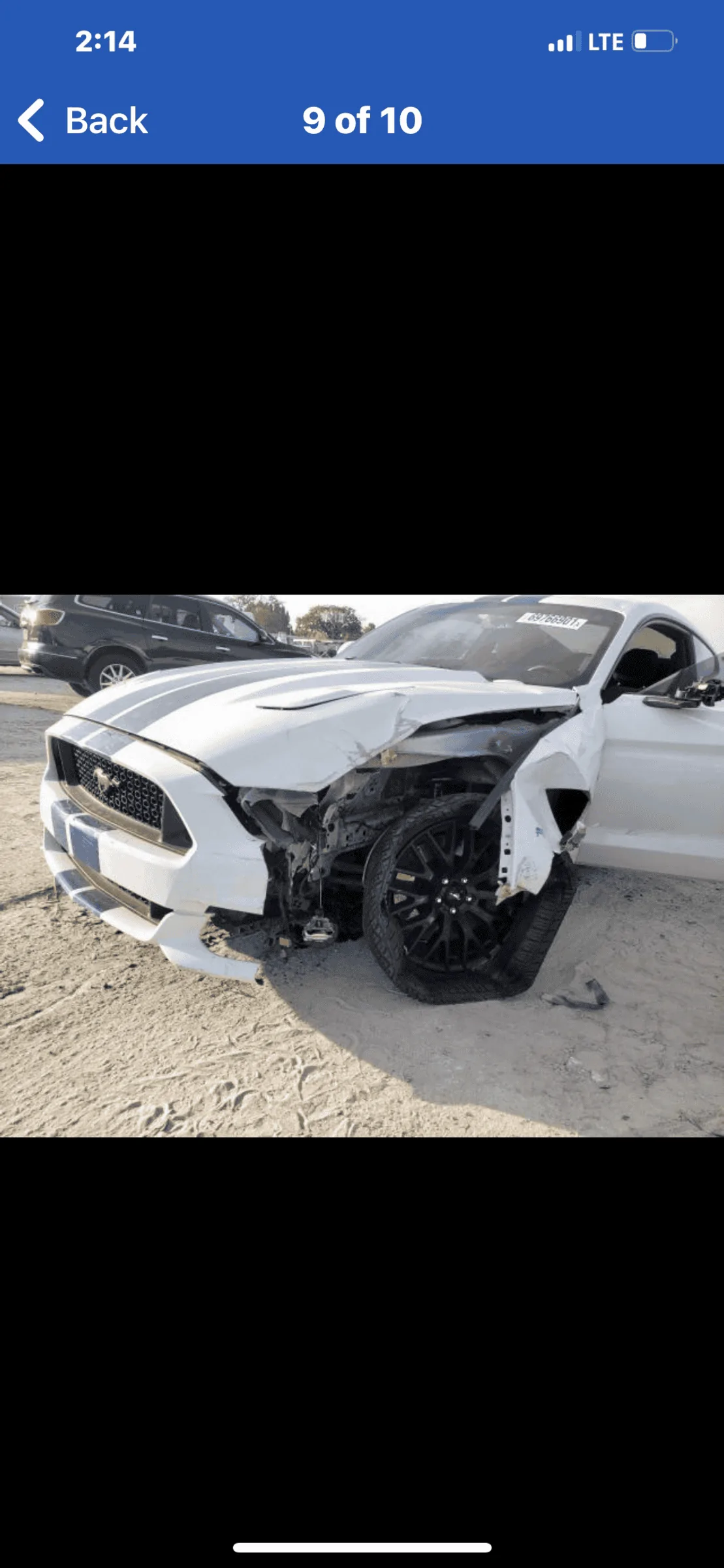

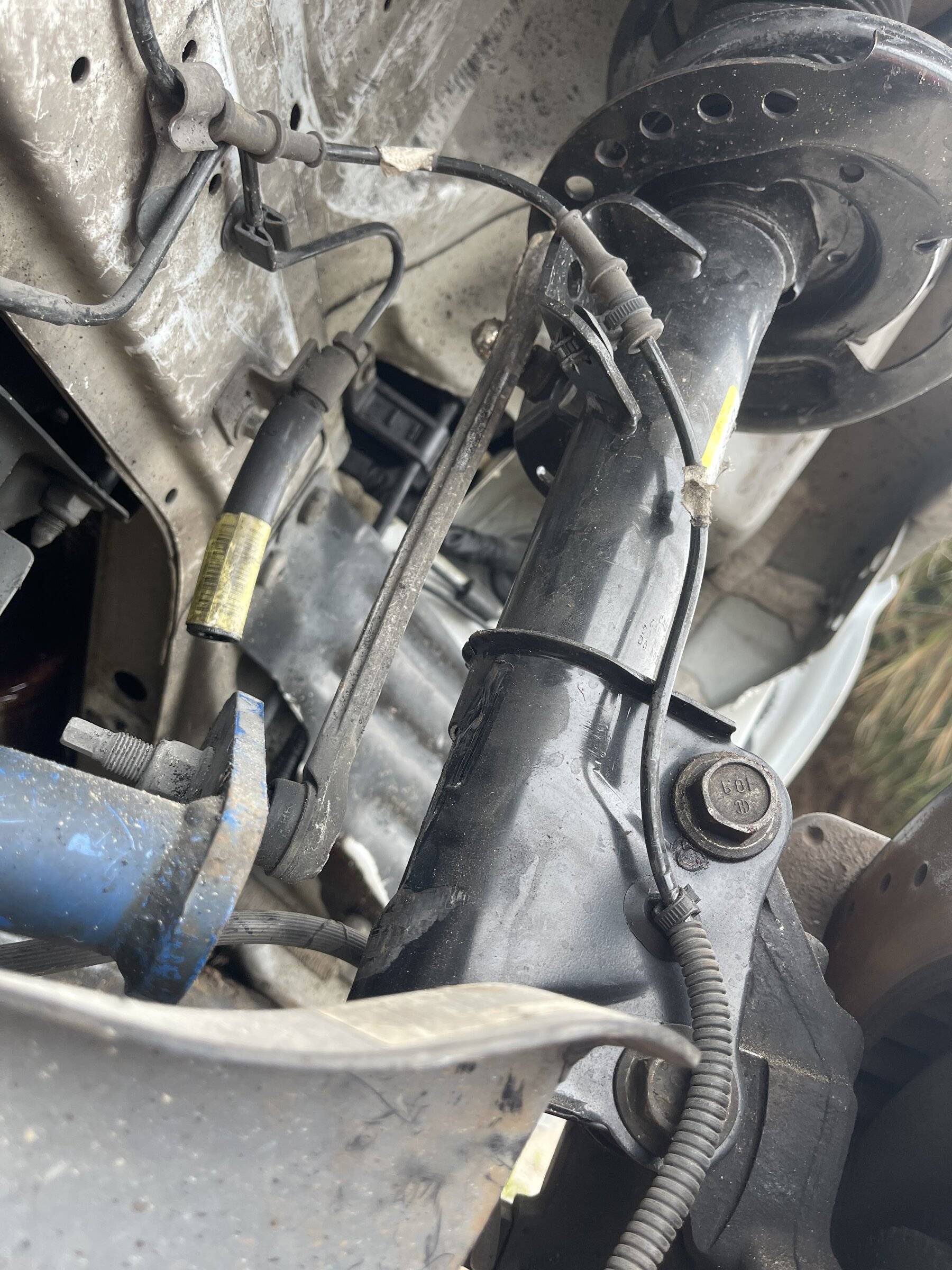

I bought a project to work on. It was hit hard on driver side front. Nothing got into the frame only the front wheel suspension has been affected. I know that the lower control arm is broke and the rack is broke. I haven’t had time to get it up on my rack But it’s losing oil on that same side very quickly. With all the panels on I cannot see but I’m curious what I’m gonna find. Any guesses. I should have the car up on a rack next week but I’m wondering where might be coming from. Oil lines ? Does the rack use motor oil. I wouldn’t think so?

I hope it works out well for you. Got any pics of the car?
