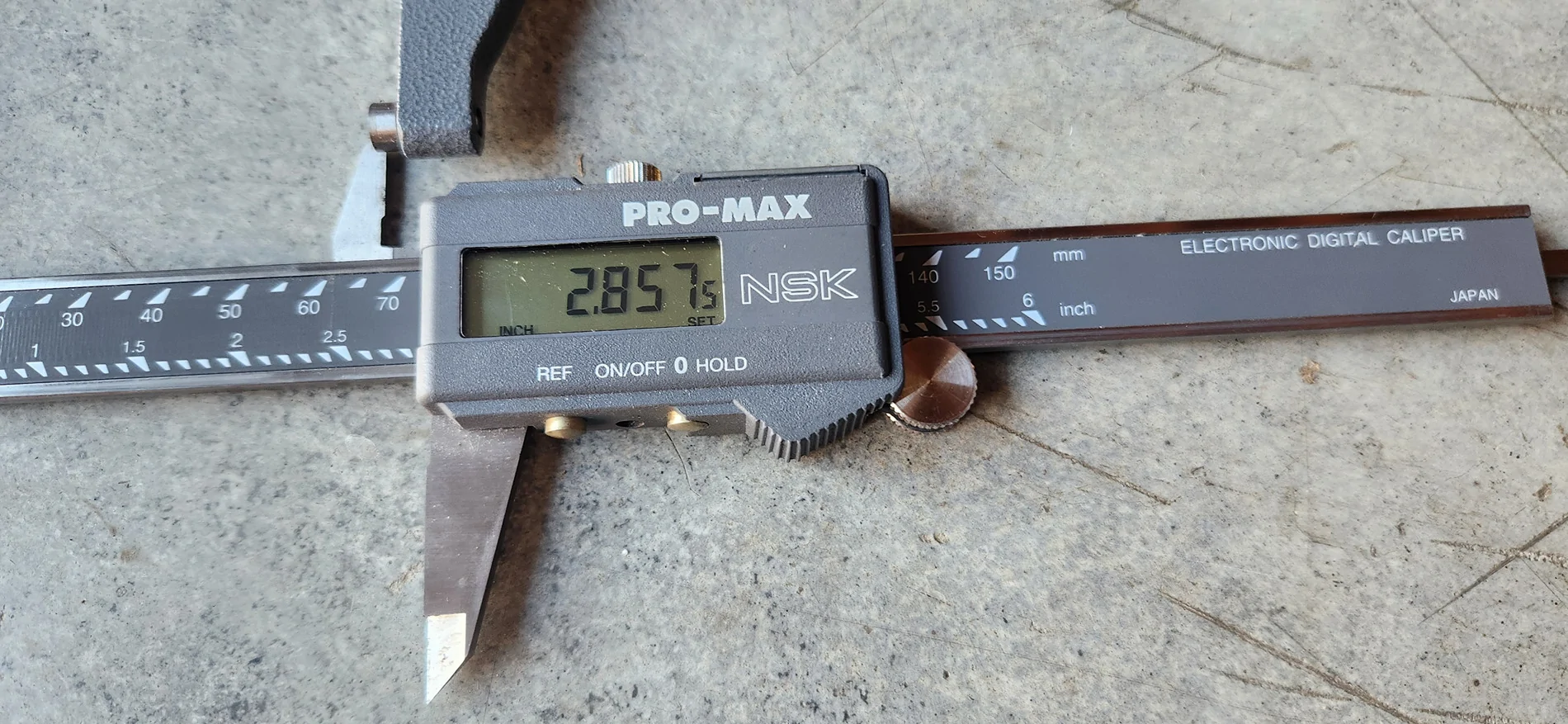

Ford doesn't list the effective pulley diameters but they can easily be measured with the belt off. You measure at the tallest point of a given rib, not the round portion at the front of the pulley.
So here...
Not here...

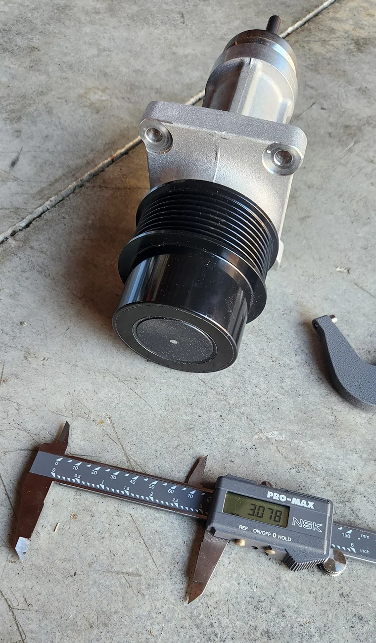

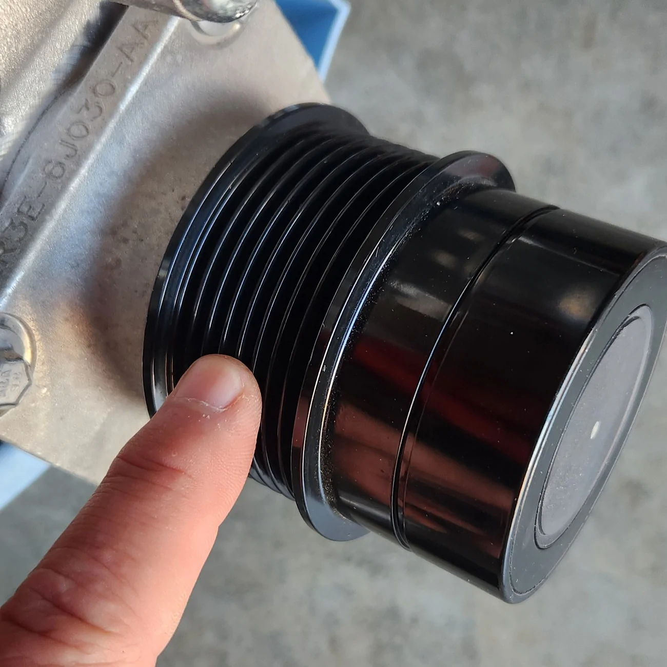

I have an extra factory GT500 shaft/housing/pulley assembly so I pulled that out of the box and measured.
So, factory '20-'22 GT500 pulley diameter comes in at 3.078". The Raptor R is slightly smaller at 2.857". Note that my unheated shop was an icebox, so Seinfeldesque shrinkage is to be expected when measuring anything in there.

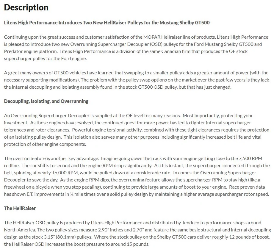

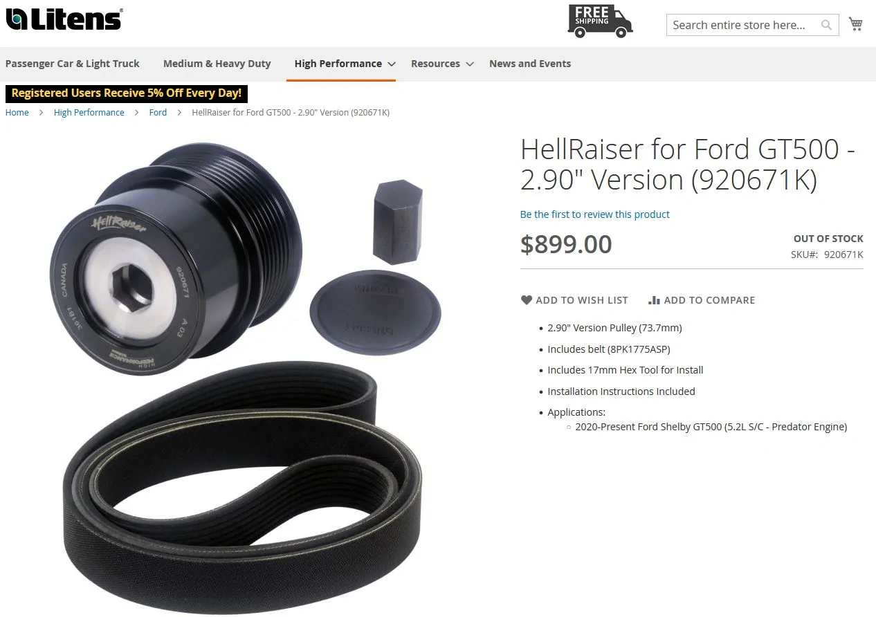

Note that Litens' aftermarket side offers a 2.9" pulley (and a 2.7"), effectively the exact same thing as the R pulley (forgive any cosmetic deviations therein) but it isn't exactly inexpensive.
Problem is, you can't buy the Raptor R pulley alone from Ford - you pay for the assembly. So the shaft and housing come with it. The respective part number, NR7Z-6J022-B, has a suggested retail of $1,694 as of April, 2026. Crazy. May as well buy a whole takeoff blower at that point!

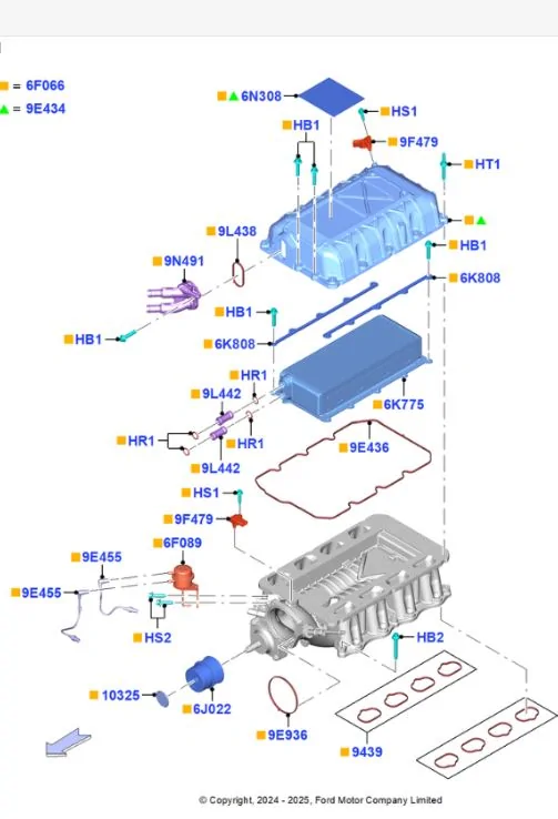

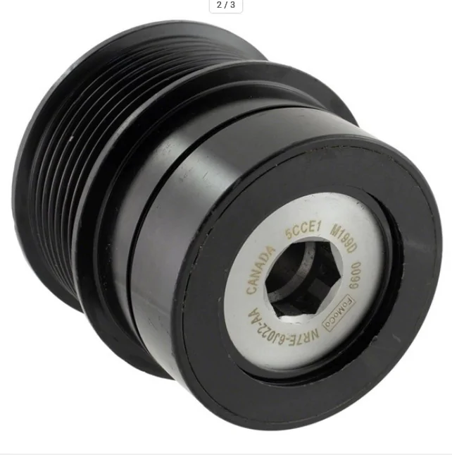

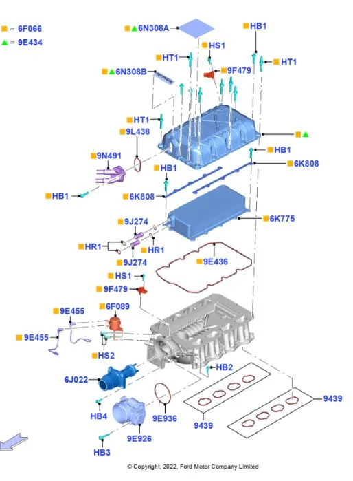

So I wondered about the GTD and the DH SC. Could they be using the R pulley or possibly an even smaller pulley? Ford shows, for what ever reason, the pulley being offered for sale by itself, and most importantly, they show some photos of it with the cap off such that you can see the engineering number! The GTD listing from Ford...
Note 6J022

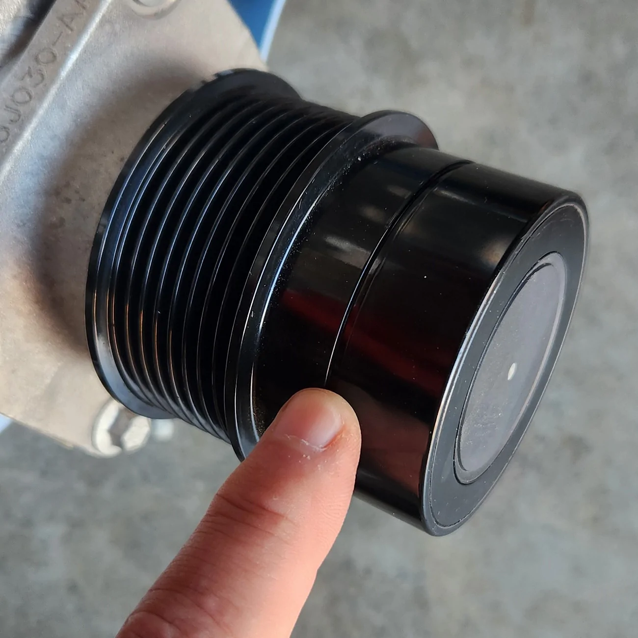

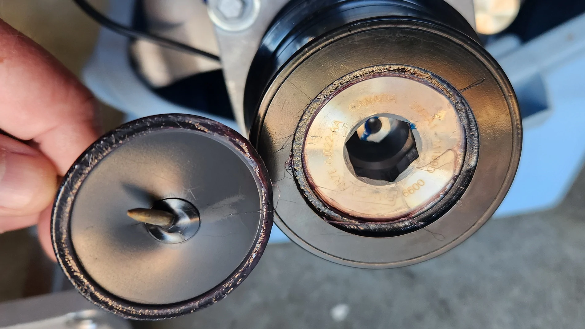

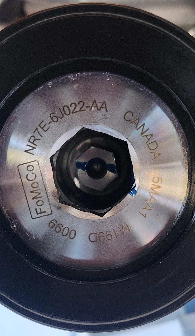

So you can see the engineering number (which is not the part number) as NR7E-6J022-AA. Armed with that, I popped the protective cap off of my R pulley to see what the engineering number was...
Son of a bitch...the GTD is using the exact same pulley as the Raptor R, a ~2.9" pulley. Ford's Raptor R price $1694, Liten's price $899 and the GTD pulley price from Ford is $456.36 (all prices are retail). All the same Litens pulley from each. So hurry on down to your Ford dealer and negotiate before they wake up if you want a 2.9"pulley that can be decoupled. GTD pulley part number is NR7Z-6J022-C.
I had a number of conversations my my Ford Parts guru about this today. He went through the Bill of Materials for some known Dark Horse SC VIN's and verified that the SC will use the exact same 2.9" pulley as the Raptor R and the GTD as well. Part listings are still not up for the DH SC so the only way to delve deeper is by using a VIN and then searching through the HVBOM.

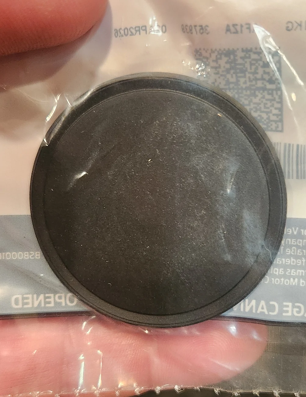

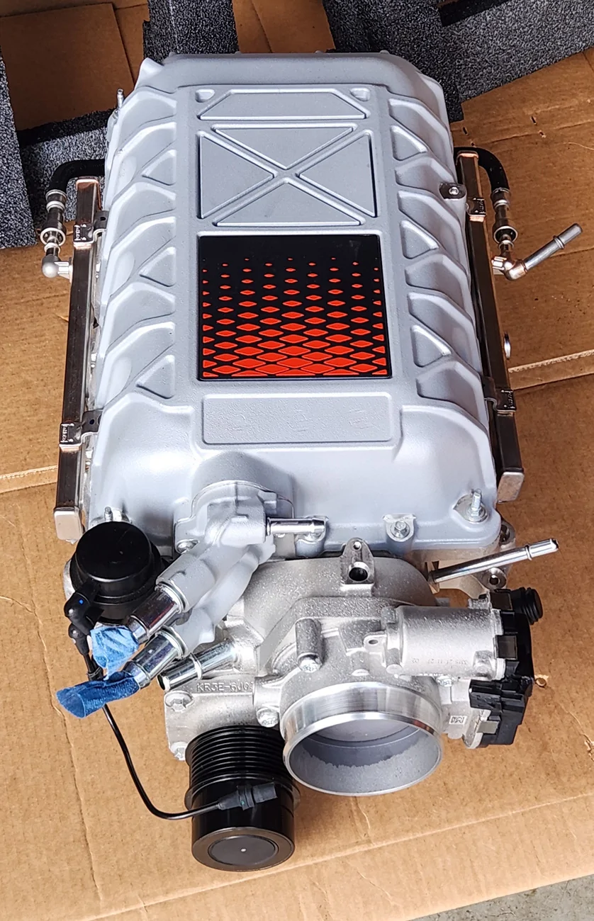

I know many of you have been losing sleep over the fact that the cap/plug for the front of the supercharger pulley not being available for purchase. Visions of corrosion being welcomed in or worse yet, a Ford tech spotting a missing cap and deducing that you just voided your warranty by sneaking in a smaller pulley for more boost. Fear not my fellow gasoholics, with the advent of the GTD, Ford has finally made them available through Ford Service as a separate item.
Why did I buy two, you ask? I'll answer that after my blower gets ported (Kong) and I go to reassemble everything!
So this whole time, we could have been buying this from Ford as an Alternator pulley dust cap?

They measured .007" larger. I see everyone comes up with a different number, I'd like to believe they all know what they are doing such that it is temp and tool accuracy responsible for any deviance.

If you then look at Litens' 2.90" pulley product page, you see they list supplying an 8PK1775 belt which crosses to the original factory belt, an excellent match if you are using the GTD/DH SC/Raptor R pulley.
TLDR: I can use the stock belt.
