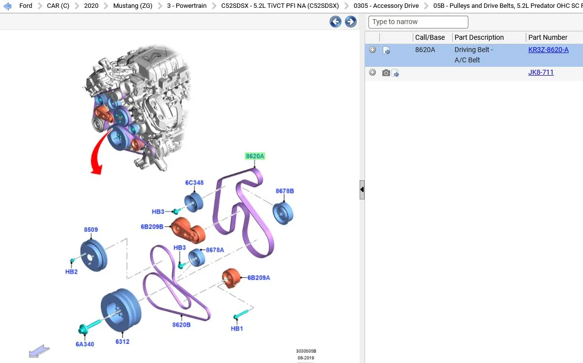

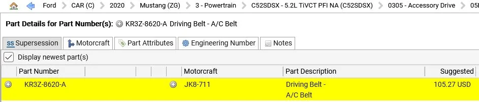

Here's the stock factory listing for both Ford and Motorcraft...

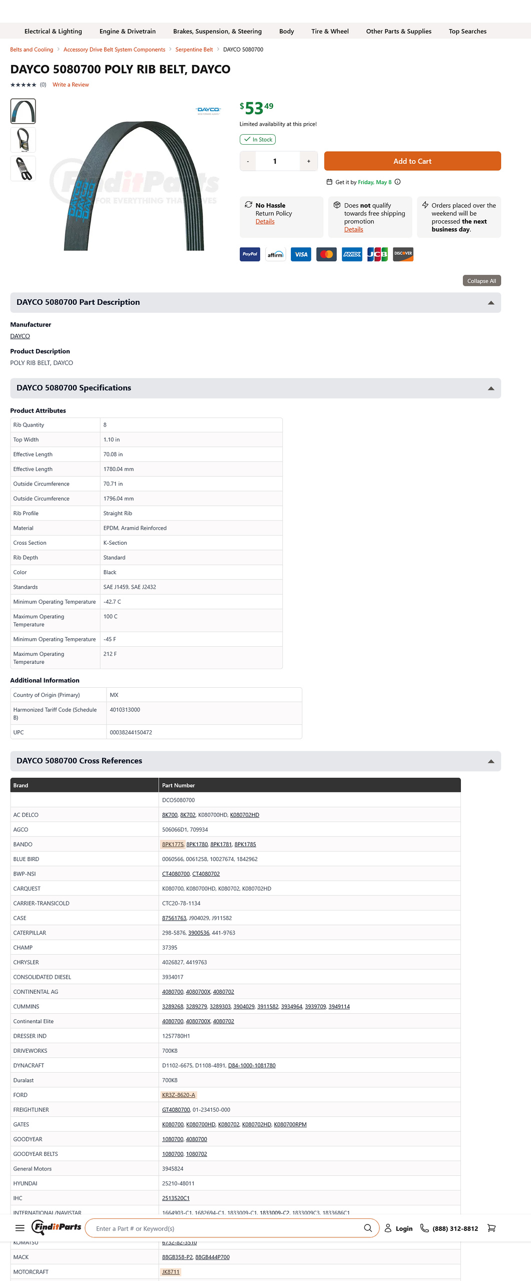

Here's a cross to a number of aftermarket belt part numbers. I highlighted what I show up above plus a listing from Bando for an 8PK1775 belt...

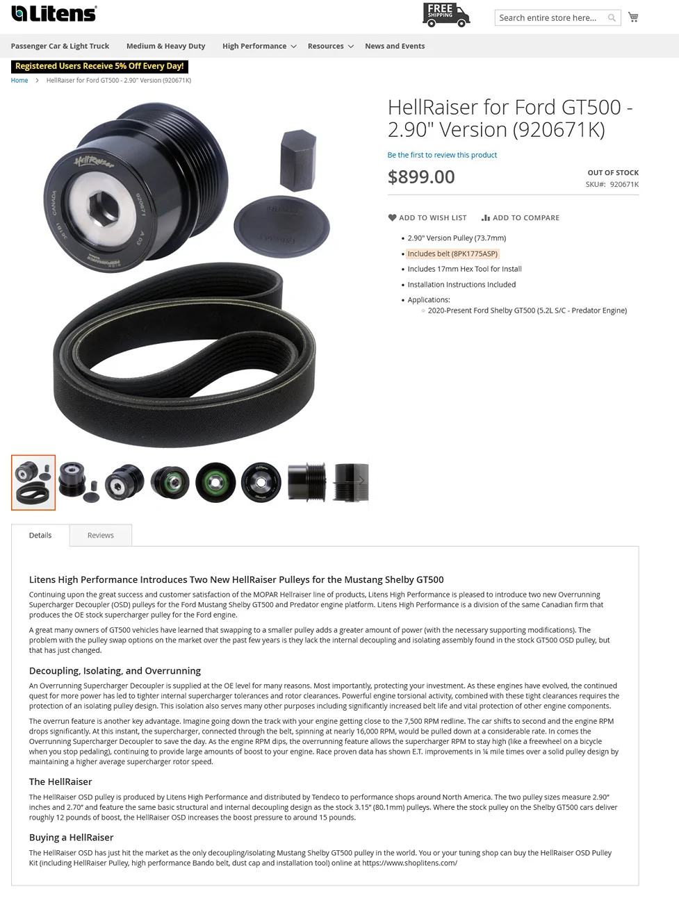

If you then look at Litens' 2.90" pulley product page, you see they list supplying an 8PK1775 belt which crosses to the original factory belt, an excellent match if you are using the GTD/DH SC/Raptor R pulley.
TLDR: I can use the stock belt.
