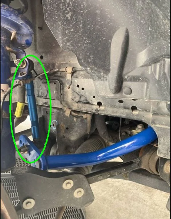

Roadsign
Feb 5, 2020
130
96
2016 Mustang GT PP
Not my photo, taken from the web.
Just remove 1 side. This will 'deactivate' the sway bar without allowing it to hit any suspension components.

Golgo69
Golgo69
Dec 11, 2021
419
305
Maryland
Herb
2019 BULLITT
You would think that bar would jump all over the place if you take that off.

blankman
Apr 30, 2024
39
416
257
CNY
2023 GT
You disconnect the end link to the sway bar and just zip tie the end link up. I did the same when i was diagnosing a clunking noise after installing new suspension. It won't hurt anything, just a PIA to re torque those bolts, at least for me it was.
