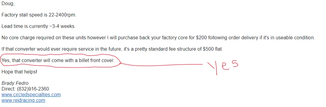

Circle D Representative just emailed me back answering my question's about their converters.
