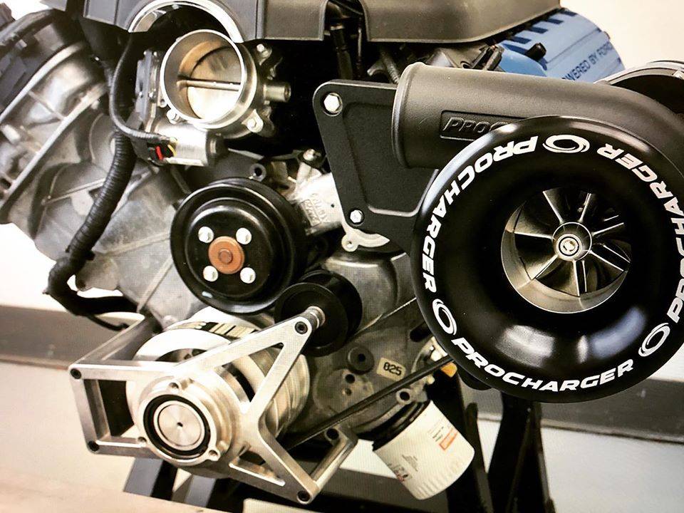

For those interested in this kit... be prepared to relocate your alternator and potentially lose your a/c. Note: This is my belief of what will be needed. I also believe you will have issues with the front sway bar. Procharger has not stated this to be a fact yet.

MFP Austrailia posted last night a sneak peak of the procharger crank support so they will be releasing theirs soon through lethal performance irrc. Also got a response from procharger that the front sway bar will need to go and aftermarket balancer is needed. ex ATI(7.65"or 8") or Innovators(8")@brutespeed.

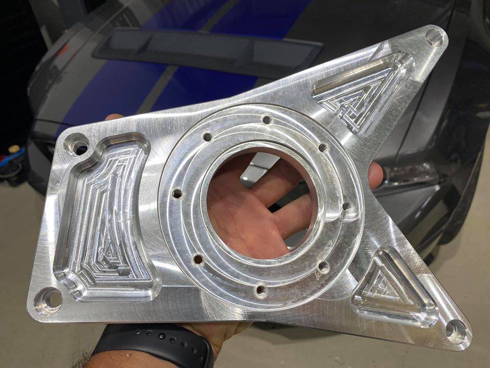

MFP's released image for quick reference:
65305712640_o.jpg?_nc_cat=100&_nc_sid=110474&_nc_ohc=E2VvQ5cJ44kAX9chEjg&_nc_ht=scontent.ffcm1-1.jpg

So front sway bar needs to go... anyone find out official info as far as A/C and alternator?
I can't say 100% but I'm seeing the a/c and alternator should be spared. I am going to follow-up next week on my order and see if the instructions have been written. If someone beats me to this, please share.
