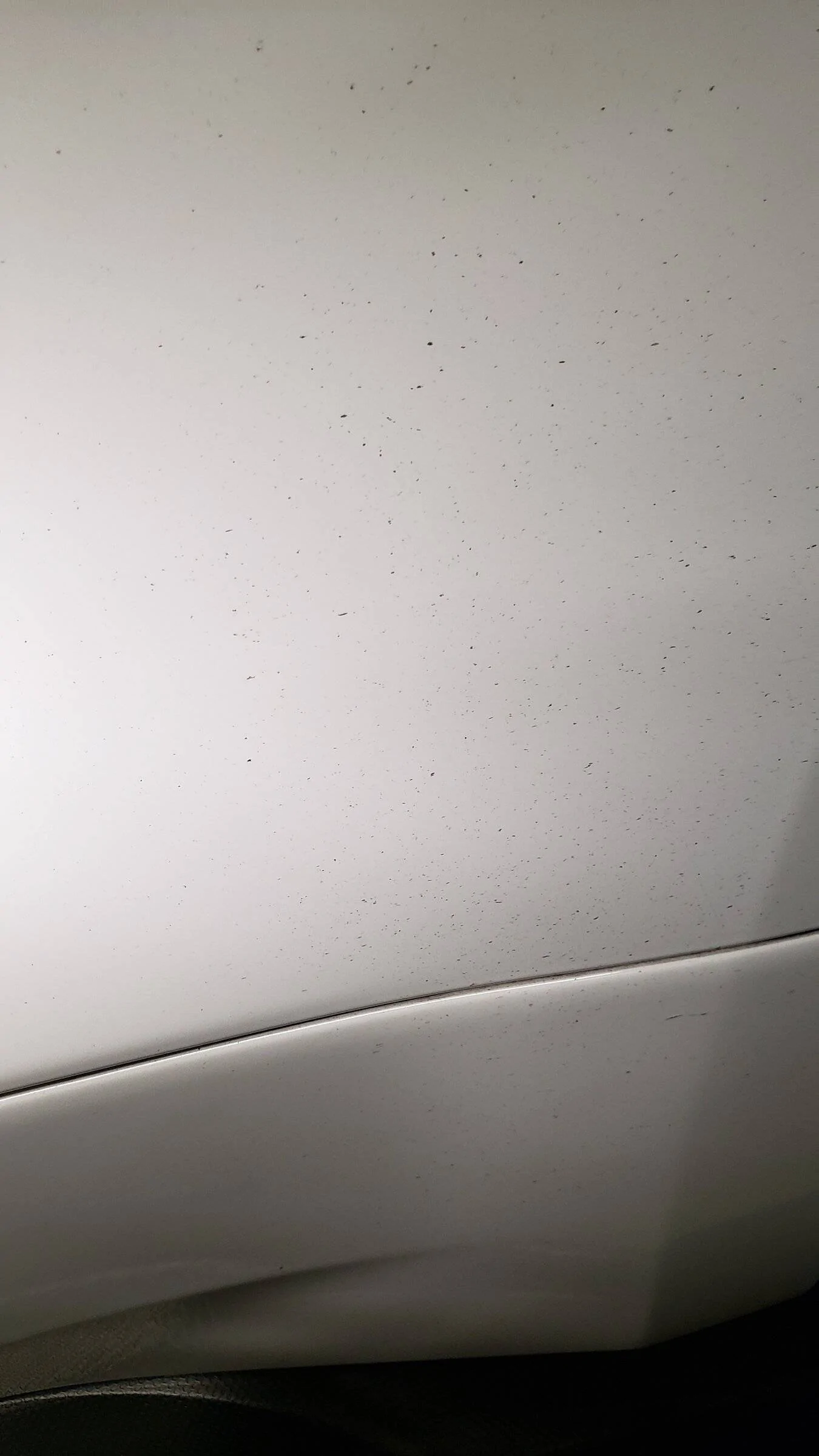

Here's what that area looks like on the Rented Mule (this is the driver's side) after 16k track miles at the Ford Performance Racing School. The area in front of the rear wheel and on the lower cladding is covered in pock-marks and chips - the rest of the quarter panel is fine.
