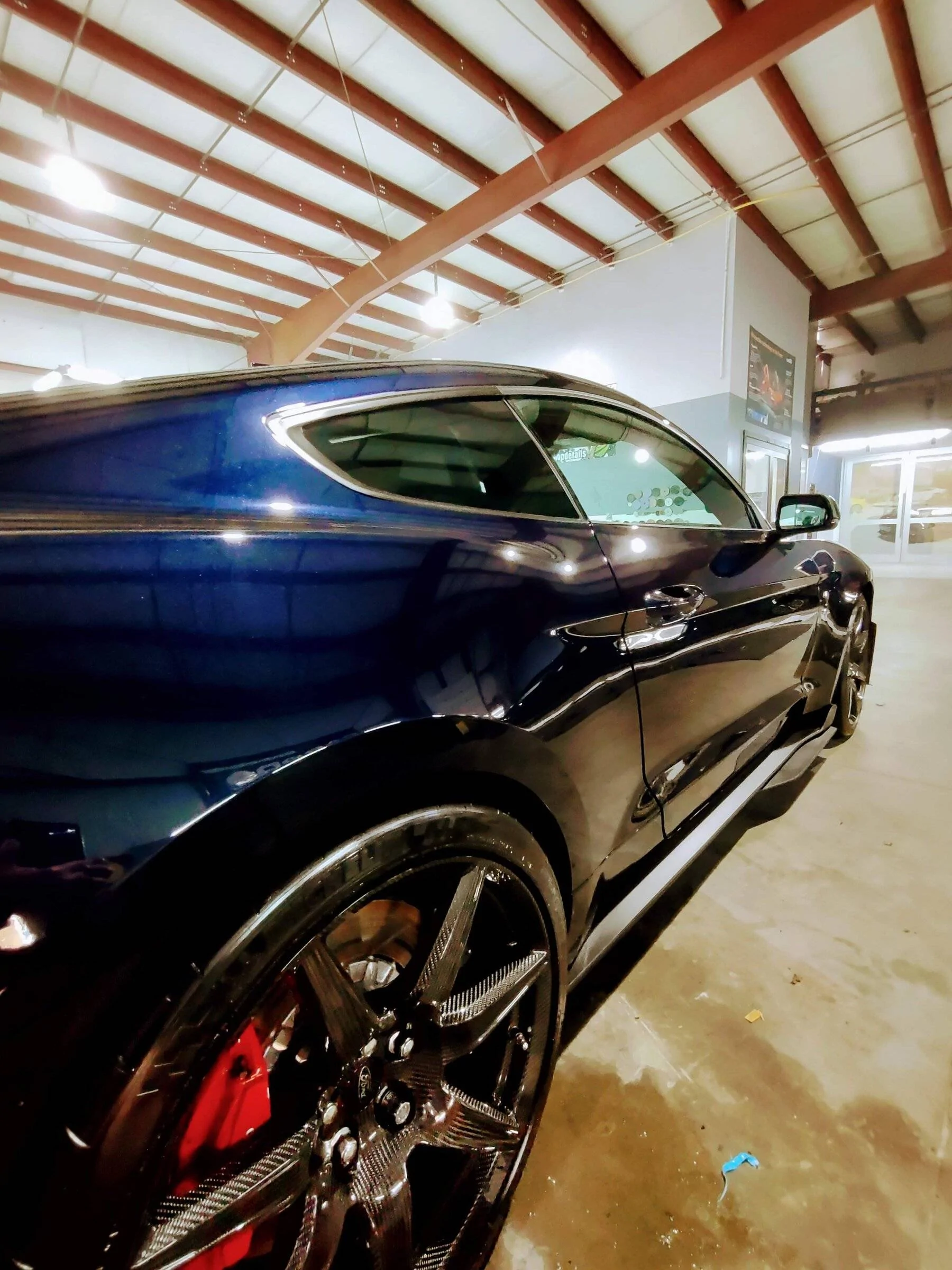

i nearly fainted when a shop near me quoted me these
Xpel PPF gloss 6,500$
Matte PPF xpel 7,000$
