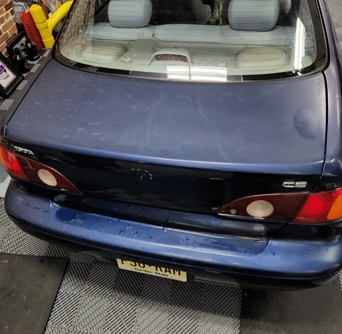

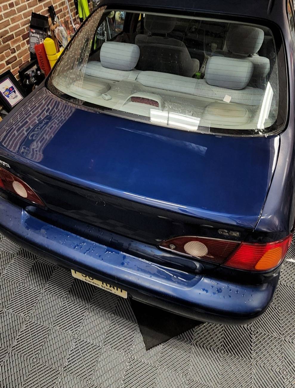

To the point about the paint needing to be "perfect" prior. Here is an example of how much the newer films cover imperfections. That's just film on top of oxidized old paint. Imagine how good it will look on a decent paint. If you can afford it, and you're keeping your car, go for it.

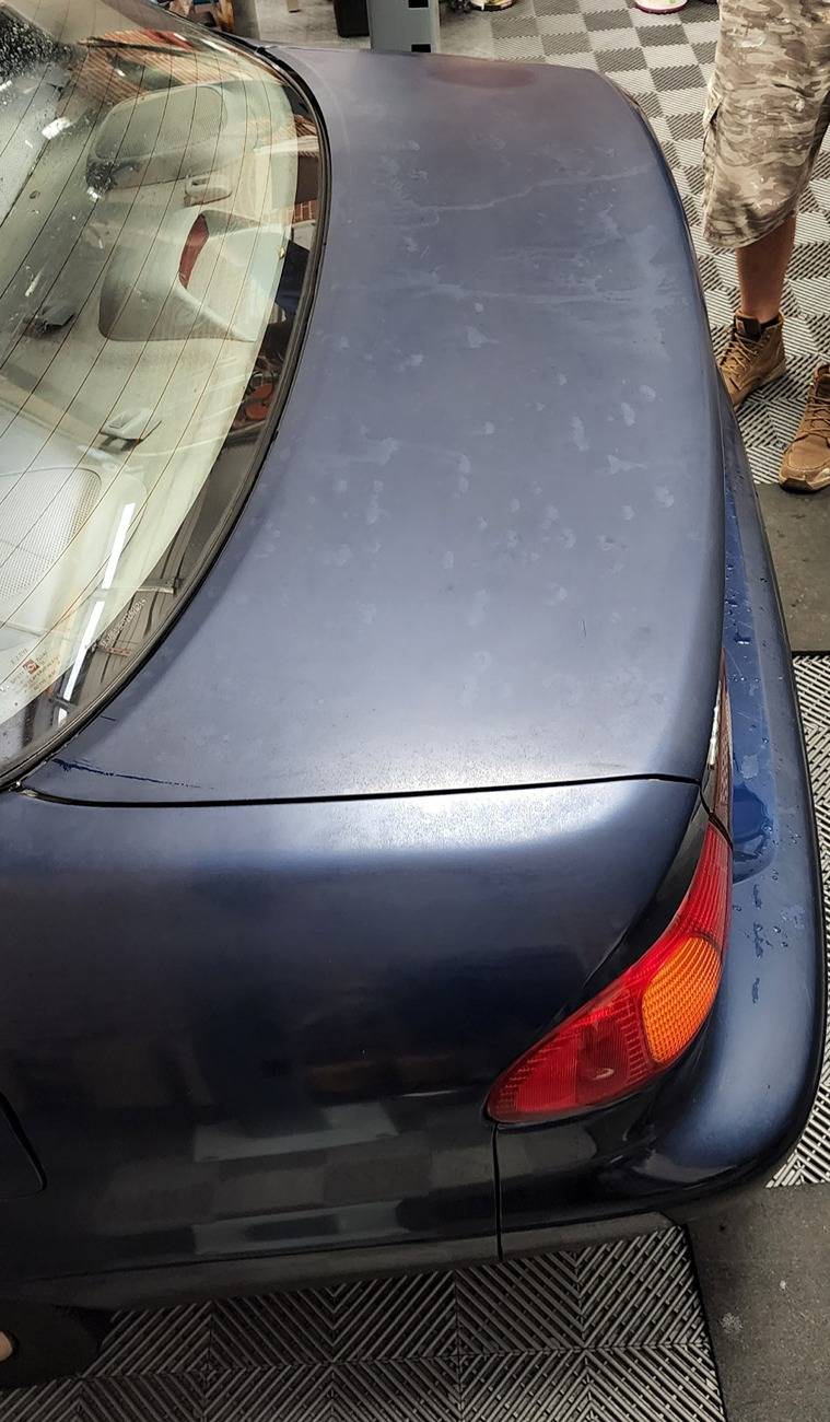

With no PPF on it, in 5 years... your car's paint is going to look like this...

Lol. Oxygen and UV! Keep that paint sealed people.
