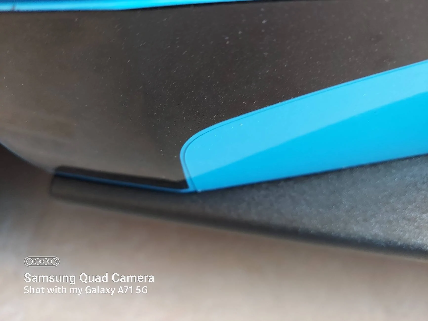

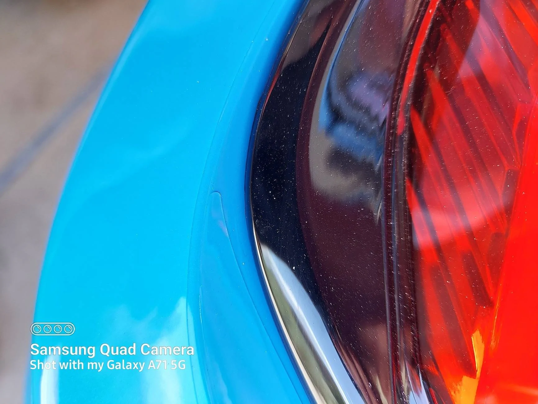

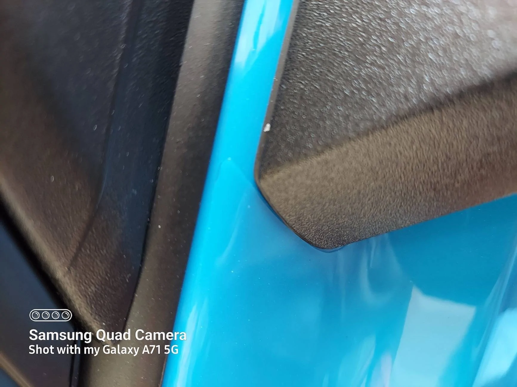

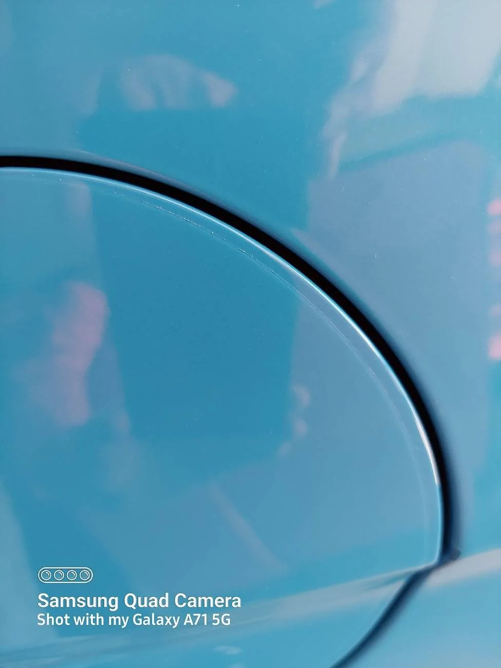

I'm attaching some photos of what the end result can look like, using the pre-cut, plotter method.
Removing door handles, mirrors and trim can be done. In my area, it's quite expensive, much more so than an regular install. Typically done on high-end cars, CFTP GT500 level, Porsche GT2/3, etc.
As to comments of discoloration and cracking, the current generation of products are warrantied for ten years. Ask the installer about the product brand and warranty.

@Skye you bring up another good topic; precut pieces that leave an edge visible, or completely wrapped edges. 🤔
While I highlight the lines in the photos above, what I did not show, is at the panel edge, like where the door edge meets the jamb area, or two panels meet, there's a touch left over, with some tabs; this bit wraps over and protects the panel edges. Don't ask me how they tucked the edge in-between the door and the fender :question:, but they did. Patience. A lot of patience.

There’s various tricks to that trade, that’s for sure. The really good installers can get edges wrapped in the most difficult of places. Even in spots where edges can’t get wrapped, the good films are almost undetectable unless you’re really looking for them.
