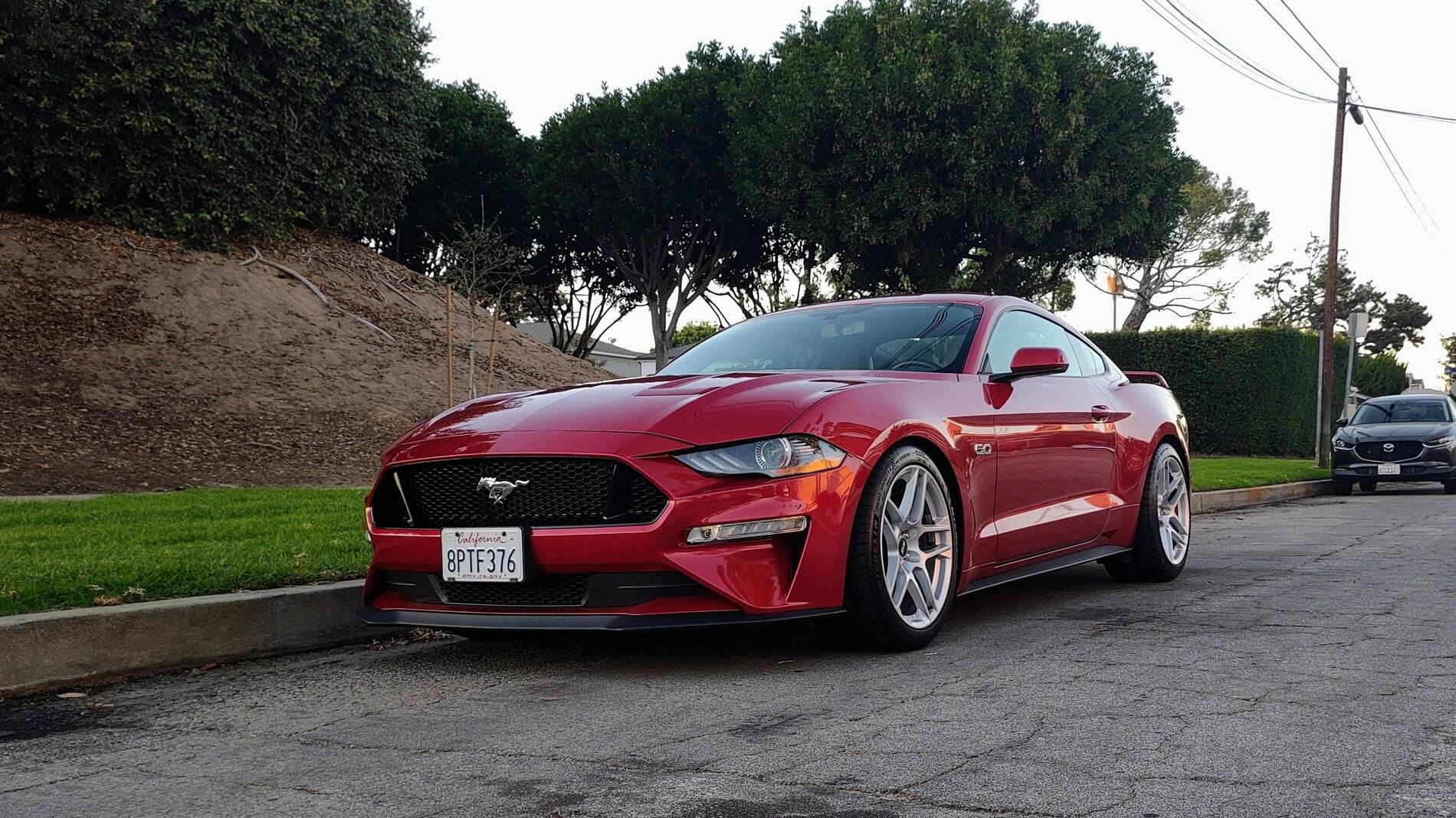

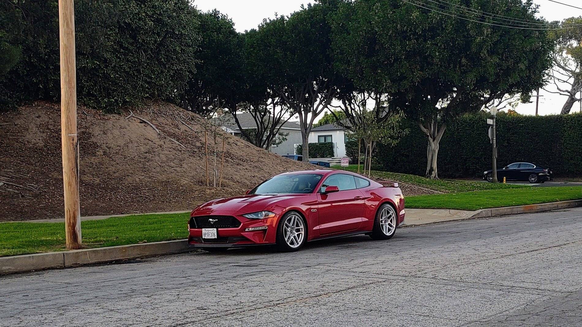

I think you are on the right direction. I am running the Ford Racing Track kit and this is an excellent well thought out kit even if you don't do the Steeda alignment. My 2020 PP1 car with the Ford Racing Track kit has very little axle hop, I do plan on doing some items to it in the future.
One thing you didn't mention is wheels and tires. Going to a more aggressive wheel and tire setup is a huge plus for these cars. A 3800lb car with just 255s up front is not the recipe for outstanding handling. You don't have to go to expensive either. A set of SVE wheels run around $1k, they are wider, lighter with a more aggressive offset and accommodate wider tires.

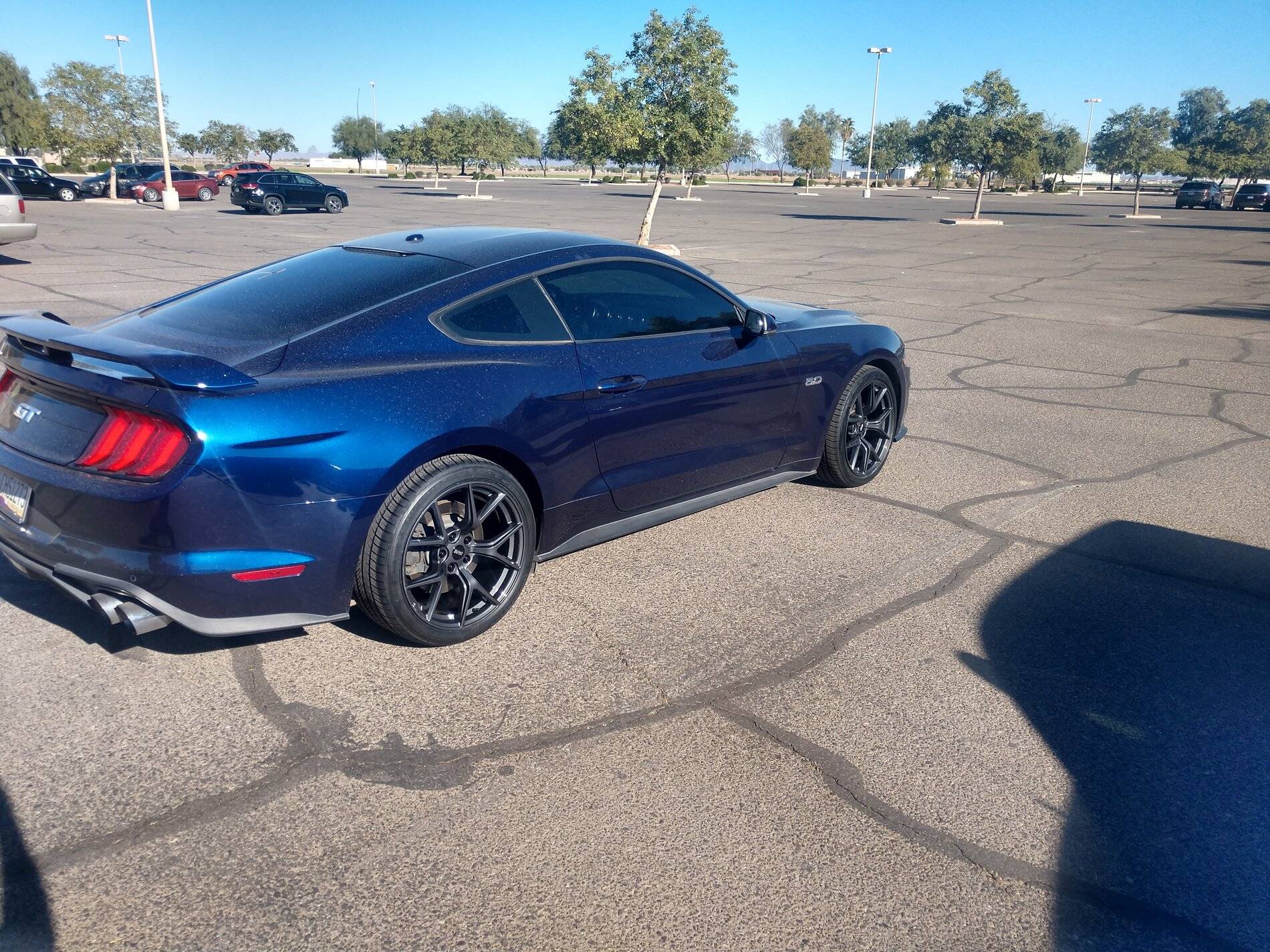

I actually JUST put on SVE SP2's (went 19x10 all around with 275/35/19, since 285 /35 is apparently out of stock indefinitely....)
Tires have already made a huge difference I'm just looking for the "next step" so to speak. Also trying to address this wheel gap:
Unfortunately your new tire size increased the gap because they are shorter than stock size.
