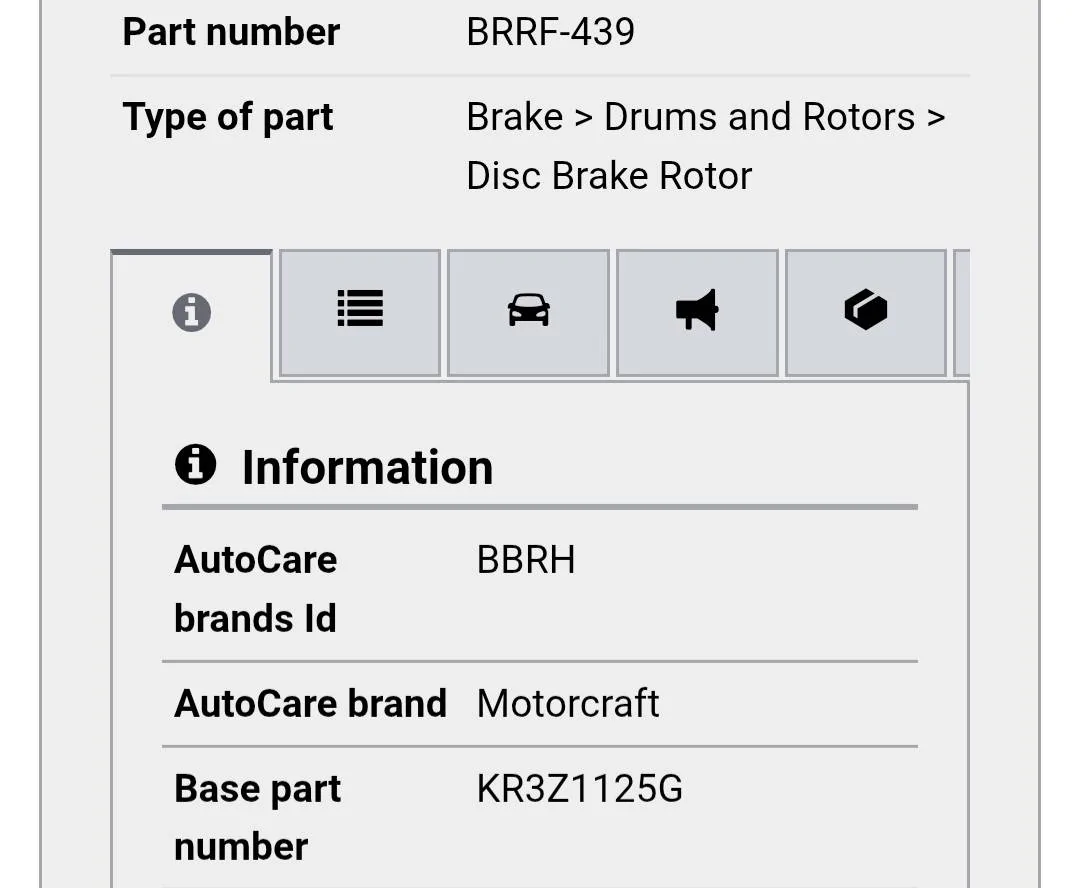

Gotcha, i'll buy the OEM rotors. Anyone know the difference between the Motorcraft model and the OEM model?
For front rotors, the OEM model is KR3Z-1125-G right, what brand is that? and the Motorcraft one on RockAuto is MOTORCRAFT BRRF439. I thought Motorcraft was OEM...but they seem to have different prices online as well.
What is the difference between KR3Z-1125-G and OE replacement BRRF439
RockAuto Motorcraft: https://www.rockauto.com/en/moreinfo.php?pk=11174121&cc=3444743&pt=1896&jsn=4301

yeah usually the motorcraft and the OEM part numbers are the same price and the same part.
