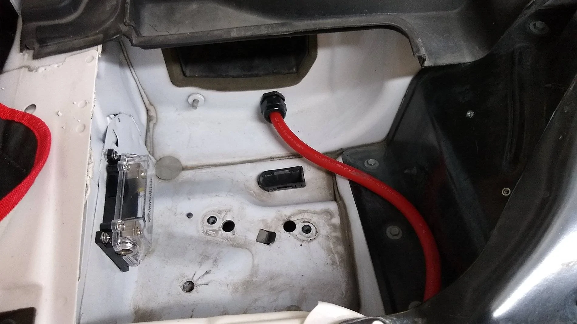

Here's my old thread from when I installed my subwoofer and amp. I've since flipped 180-degrees and installed a full system, but that's not the focus here. You will either need a Line Output Converter (LOC) of some kind or an amp that takes high-level (speaker level) signals. You'll tap into one of the rear deck speakers and you're good.
https://www.mustang6g.com/forums/th...at-install-long-post-heavy-pic-warning.78694/
Since then I've learned that it's actually better and easier to run the power wire behind the battery box, like this. I have a monster-sized fuse holder, so had to put it in this location b/c it wouldn't fit anywhere else safe. There are easier placement options for a smaller fuseholder.

Since then I've learned that it's actually better and easier to run the power wire behind the battery box, like this. I have a monster-sized fuse holder, so had to put it in this location b/c it wouldn't fit anywhere else safe. There are easier placement options for a smaller fuseholder...
I see you like those strain relief bushings too :) I ran my power cable the other route but didn't know about those bushings then. Maybe I could use one still where it comes through the inner fender

Those Fastronix bushings are simply the best thing out there IMO.
https://www.amazon.com/gp/product/B0841QYB7T/ref=ppx_yo_dt_b_search_asin_title?ie=UTF8&psc=1
They are stout, well-made and have a rubber sleeve inside that clamps completely around the wire. Very pleased with them. A regular, thin rubber grommet can easily pull out of the hole when you're pulling the cable through, but this thing doesn't budge once you tighten the retaining nut a couple of turns.
