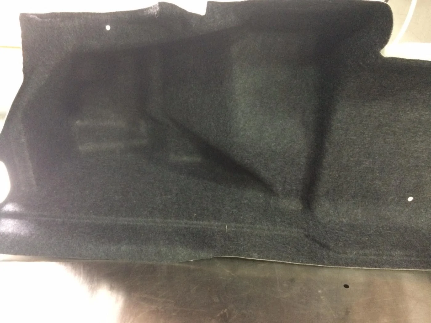

I removed the interior driver side carpet of the trunk. It's fairly straight forward if you have the right tools. This molded piece of carpet was used as the mold for the box.
The entire interior of the molded piece was lined with blue painters tape. This and other similar videos can walk you through the steps of how to build a fiberglass box:
[ame]
If you can find a bond breaker between the tape and your fiberglass that makes the tape easier to remove from the box later, that would be great. Perhaps cellophane? I didn't know of anything to use, so my box looks a little "MEH" on the sides because the tape stuck to the fiberglass resin, but it isn't usually visible, so no big deal.

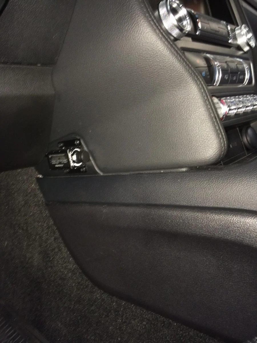

Power: I ran the power line from the battery through the firewall. If you remove the battery and the battery box, there's easy access to the firewall to drill a hole and USING A GROMMET, penetrate the wall and run the cable down the passenger side of the vehicle. Just make sure you don't drill into anything important. I used an existing ground point at the rear of the vehicle where all the tail lights ground to the body.

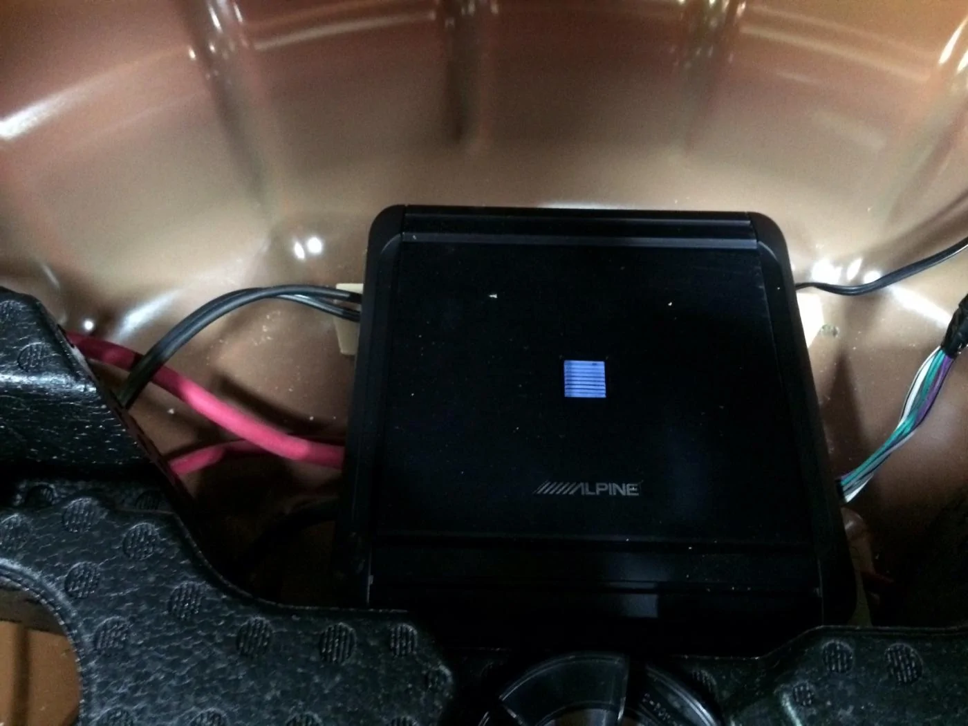

Signal/Remote: I tapped into the rear speaker cables behind the rear seat to get the signal as well as the remote turn on for the amplifier (the Alpine amp turns on and off when it senses a signal coming into the high inputs). It seems to work well.
Amp: The amp is installed in wheel well because I don't have the spare. I'm running it at 2 ohms through the dual voice coil subwoofer.

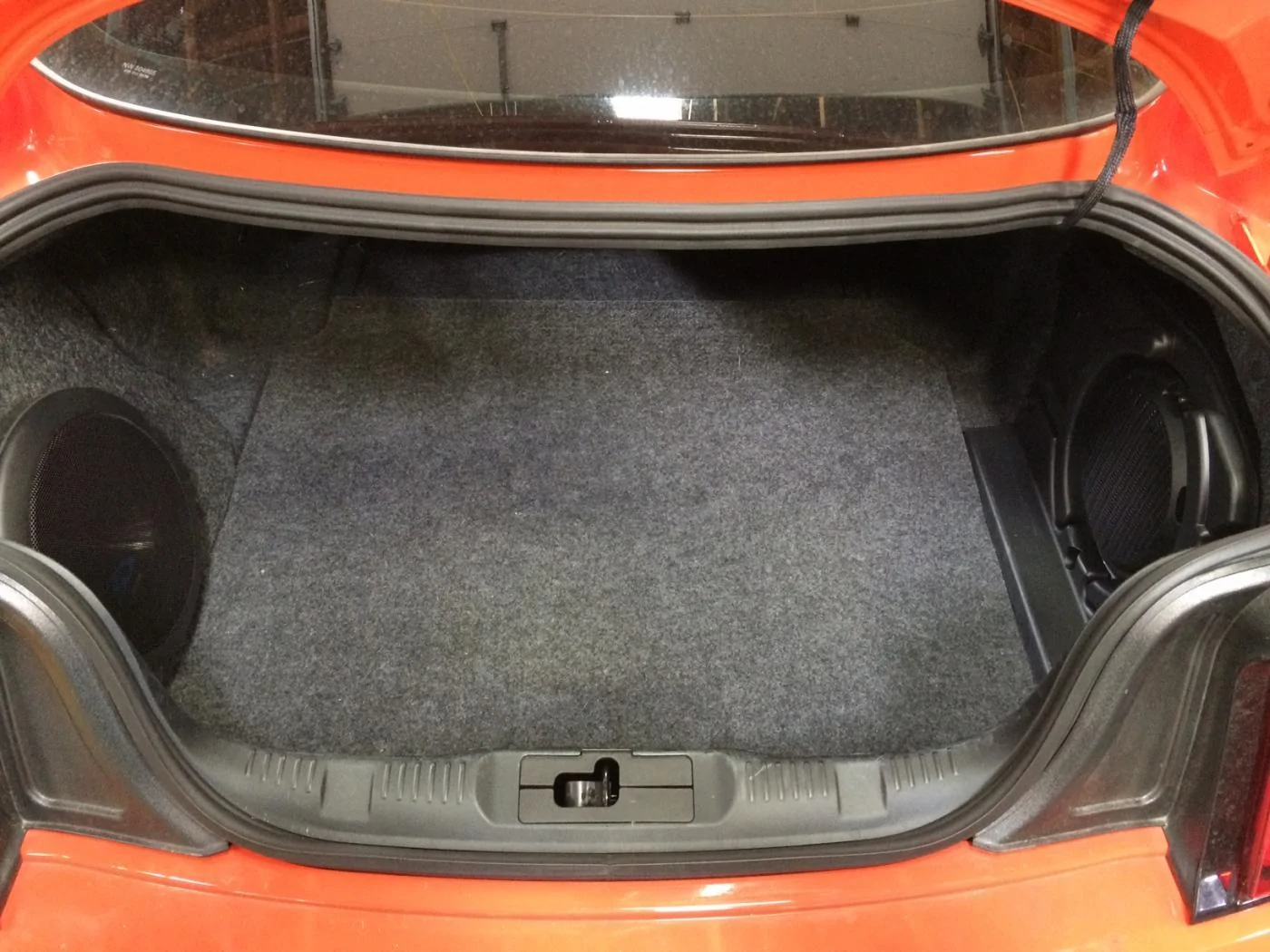

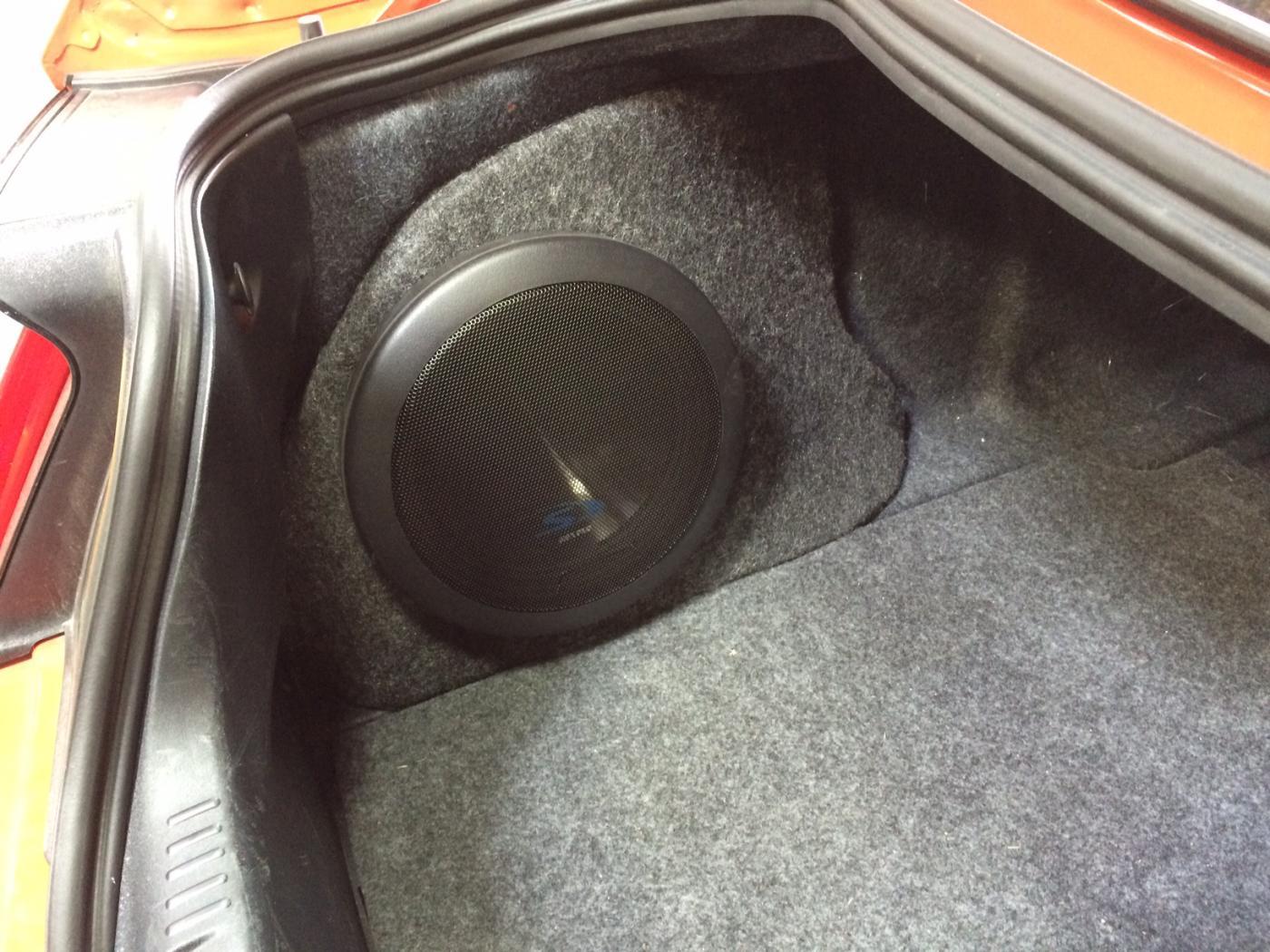

Because I made the box for the driver side, I was able to keep the stock 8" subwoofer in place. Attached photos show the system installed. This thing sounds great. I tested it out with the song "Turn Down for What" by DJ Snake and Lil Jon, and it's REEEEAALLLL nice. Low, loud, and almost obnoxious. Thank god for that bass knob so I can adjust it from the driver seat...
