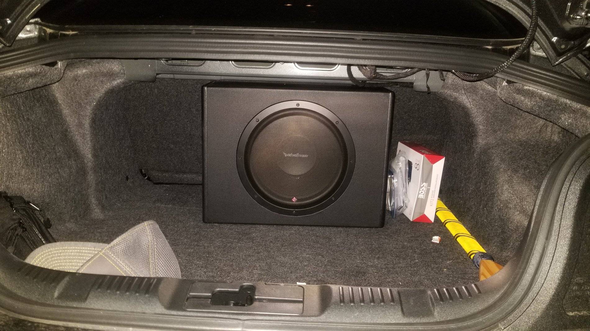

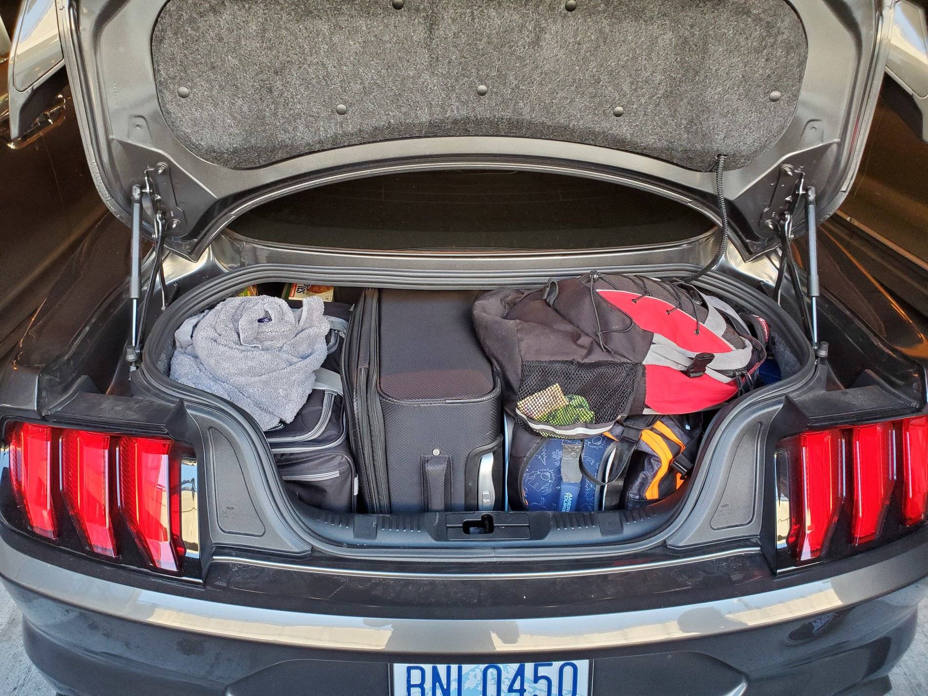

Does anyone have pics of the sub in their trunk? I want to see how much space is left after the sub is in place
Dusten
Jul 25, 2018
827
589
Conway, Wa
Dusten
2018 Ford Mustang, 2001 Ford Lightning, 1968 Ford Mustang
The second picture is my trunk with luggage for me and two kids on a 9 day road trip.

He's looking for picture of the rf12 sub that this threads about
But nice setup
I see that now. Lol. Wish I could find the thread I was intending on replying to. This is why I shouldn’t post after a six pack.
bpalmer753
Feb 11, 2020
Arlington
Brandon
2019 Mustang GT PP
haha thanks guys. I might go with this zenenclosure box this guy on here is selling. We'll see what he sells it for. Nice set up ^^ and I can't believe you can fit all that luggage in there Dustin

Gotta do what you gotta do lol. Kids and I drove from DC to Seattle. Me, an 11 year old an a 7 year old
