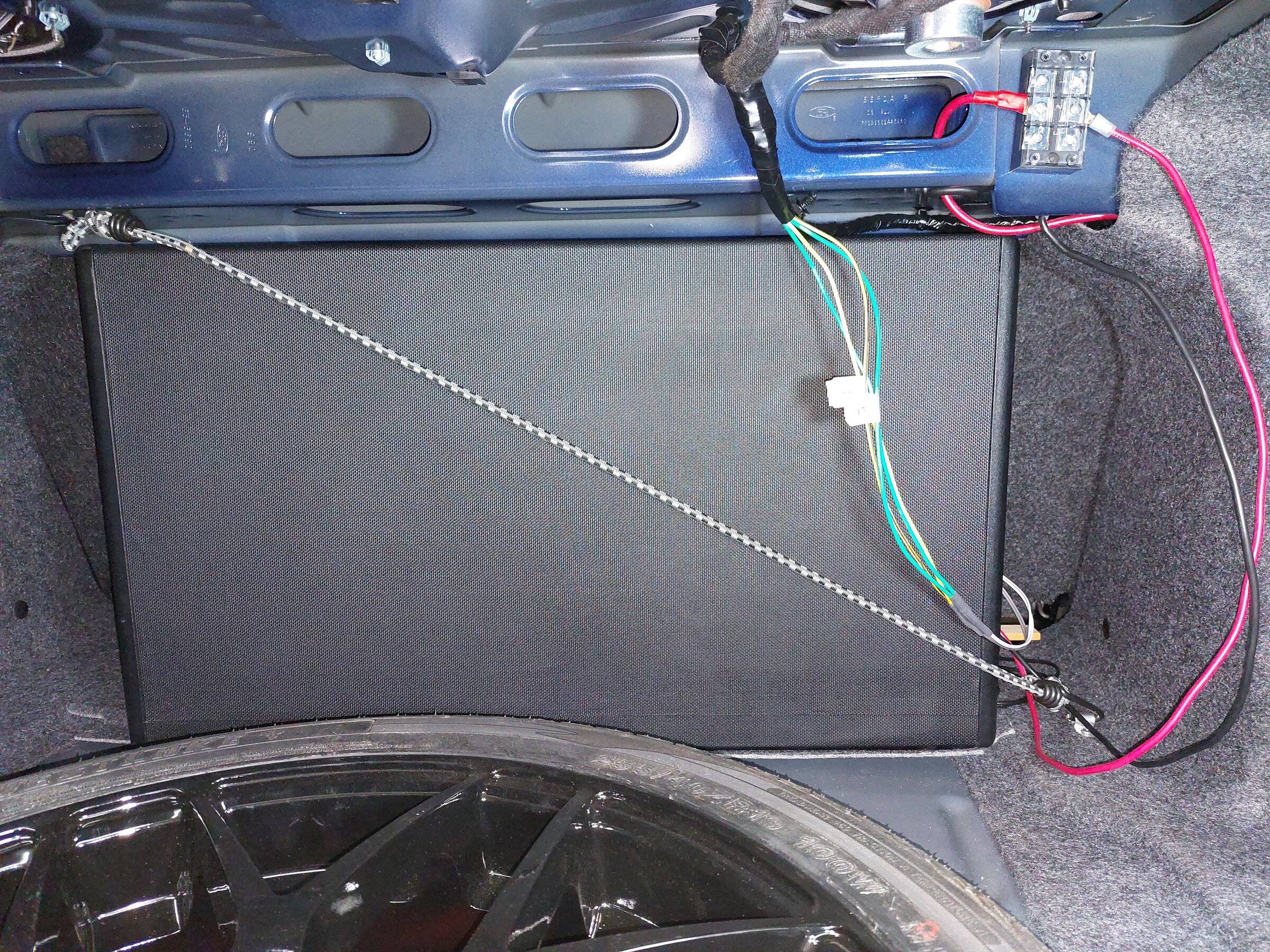

This is a rockford fosgate 12" 300w but there are many similar. as you can see I wired inputs to the rear speaker harness right above the sub. I ran 50amp feed back to a buss above sub and wired from there. Things I like about this one in particular is each wire group is on plugs, so I can pull 3 plugs and remove sub if needed. One of those is a cord to a dial mounted up front to fine tune output on the fly, I don't know they might all have this feature. Watch dimensions when buying as this one just fits in under metal framework for speaker tray above. The bungee cord is backup for spirited driving but it doesn't seem to move around at all. I'm not the guy going around rattling windows but this is plenty loud even for my 26 year old! Jim
