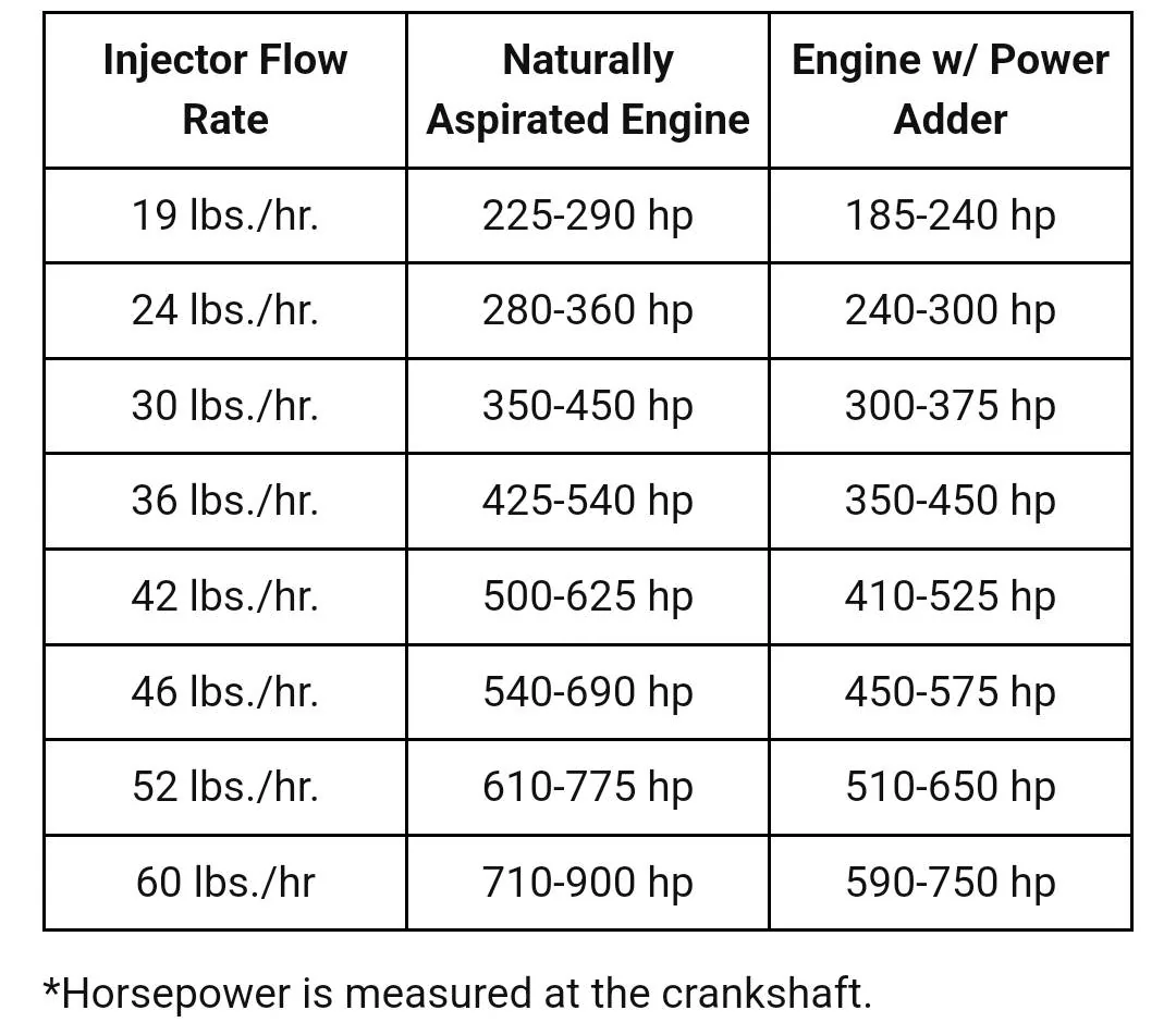

Anyone know what is the power limits on the 47lb injectors running 93 pump gas? I’m doing some upgrades on my 17 Roush Phase 2 with a VMP 67mm twin jet throttle body and PMAS intake along with VMP custom tune.

I think anything above the Phase 2 will likely require larger injectors. I went to a VMP custom tune after the Phase 2 (original 47’s) and Brenspeed installed Deatschwerk 95lb injectors for the upgrade. On a 93 tune I’m right at 700rwhp. Not sure there is a cut and dried hp limit but both Brenspeed and VMP required larger to go to the current hp level

Your call. I wouldn’t. If you’re like most this won’t be the last tune. I’d just go ahead with the ID1000’s or DW 95’s or similar. Give you some nice room for growth. Mathematically the 47’s are tapped out where you’re at. The 56’s may get you one more upgrade.

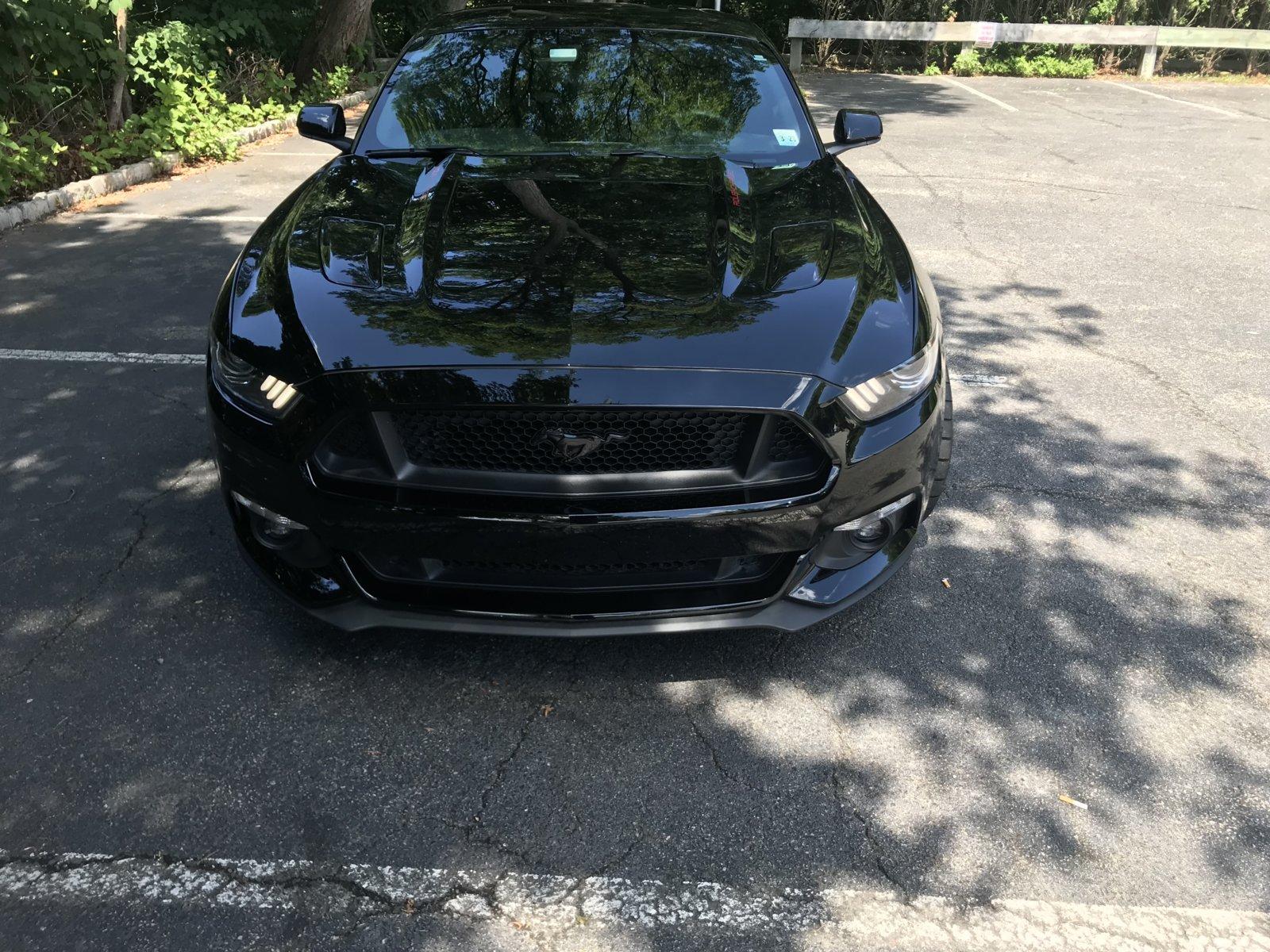

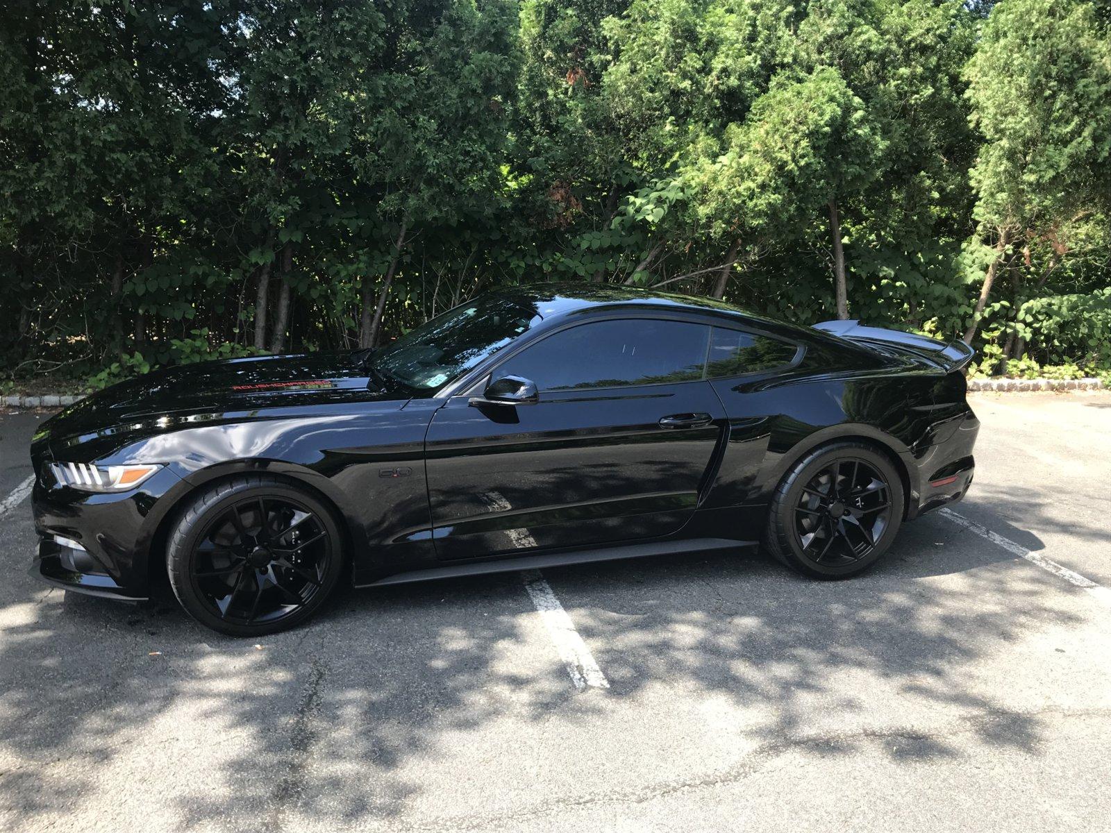

Ive been going back and forth with VMP about the upgrades they will be installing on my 17 Mustang GT Roush Phase 2 and they said no need to upgrade the 47lb injectors that came with the kit. Below is my car and set up an what is getting installed.
2017 Mustang GT
- 6 Speed Manual
- 3.55 Gears
- Roush Phase 2 Supercharger
- 80mm Pulley
- 60mm Throttle Body
- 47lb Injectors
- Boost-A-Pump
- Roush Axle Back Exhaust
- Steeda H Pipe
- BMR Rear Vertical Links
- BMR Rear Cradle Lockout Kit
- VMP Remote Custom Tune
- HP Tuners Ngauge
Here is what VMP is installing....
- VMP Twin 67 Throttle Body
- Pmas Supercharger Cold Air Intake
- RR14YS Silver Spark Plugs
- Dyno Tune
Looking forward to getting around 680whp on 93 pump gas.
