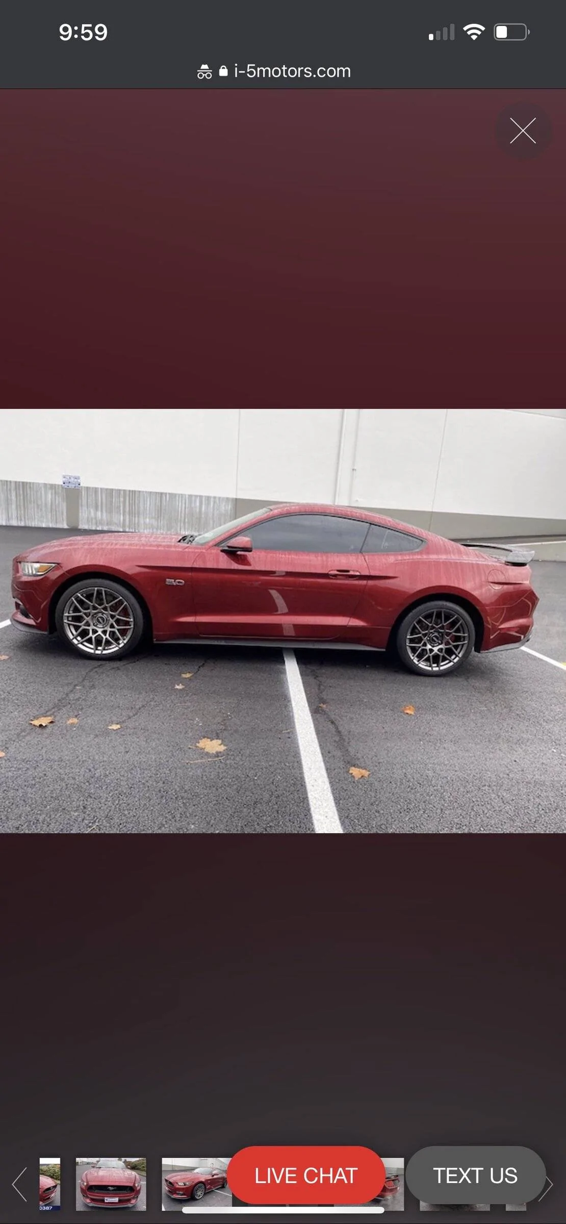

What should I be seeing power wise with these bolt ons.
5.2l Manifold
Catless long tube headers w/ full 3.5'' exhaust
Airaid CIA
87mm throttle body
Been told this car is 500whp with just the exhaust and tune which I find hard to believe. Just purchased the car a few weeks ago and looking to see what I should expect with adding these mods. Thanks
