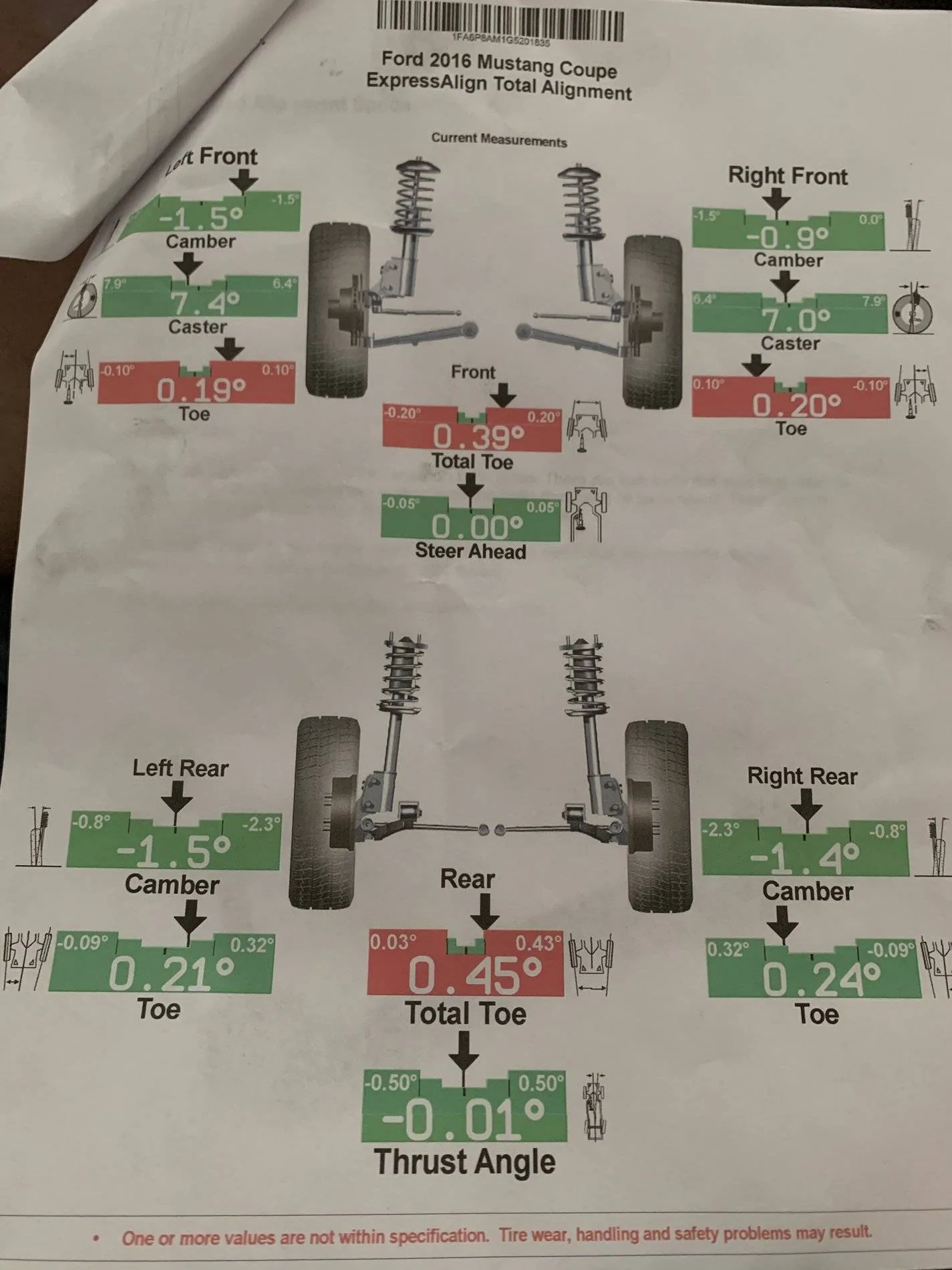

Installed a set of Eibach Pro Kit springs and I'm wondering if I need to get some camber bolts to correct the front camber. According to Eibach, alignment specs should be:
PRO-KIT Camber = -1.0 deg
PRO-KIT Caster = 7.5 deg
PRO-KIT Toe = 0.2 deg
Let me know what you think. Thank you.

Yep, camber looks great. I’d leave it alone. Toe on the rears for sure need to come in a bit and the front (personal preference) need to come in a bit as well (.06 per side or so).
NightmareMoon
Nov 22, 2015
7,131
6,417
Austin
2016 Mustang GT PP w/ Voodoo
Agreed, your camber basically fine. -1.4 is very street friendly. Yes, like BlueMustang says, a little more toe in would be recommended for safe predictable handling. 0.2-0.3 total toe IN or 0.1-0.15 per side.
Your front toe is ever so slightly toe out, (so the car may be a little light in the steering wheel and quick to turn), but not a big deal. Some people like that. If you want a relaxed self-centering highway drive with a heavier on-center feel you could go slightly toe in. Zero front toe is the factory spec and also the best for tire wear.

Do I need to buy rear toe link adjustments in order to get the toe dialed in? I already got an alignment and this was the best they could do. If so, is there any cheaper alternatives? I think they are around $250 for a pair.

No, shouldn't. It will give you way more adjustment though as the toe and the camber go hand in hand.
If for some reason you want them anyway I suggest BMRs.

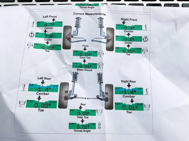

Time to update this thread. Just got another alignment and I gave them Eibachs recommended specs. Eibach says .2 degrees toe for front and rear. Is that total toe? If so, they didn’t specify that. Am I ok to run this setup as a DD?
@Bluemustang @Racerx009 @Norm Peterson
cyclonetron
cyclonetron
Aug 2, 2018
352
205
Tennessee
Patrick
2016 Mustang v6
Absolutely not...
For a street car, you want 0 front toe or very close, erring on toe in if not zero.
The rear needs to be halved.
Im rescheduling to take it back in on Monday. I’m just going to have them align it to OE specs.
