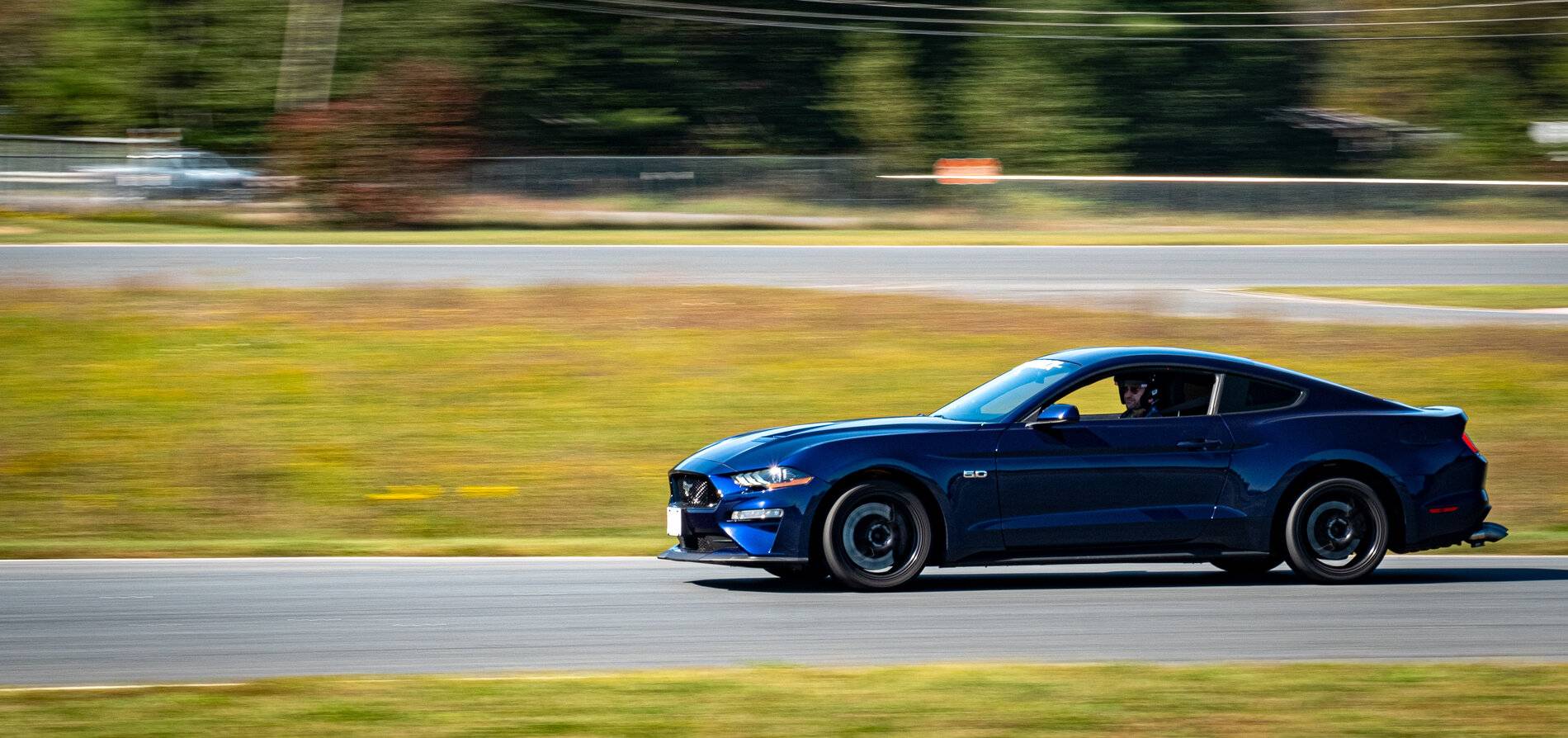

yep. More pressure is needed. The photo doesn’t lie.
Also, lol your business face. Mine isn’t much better.

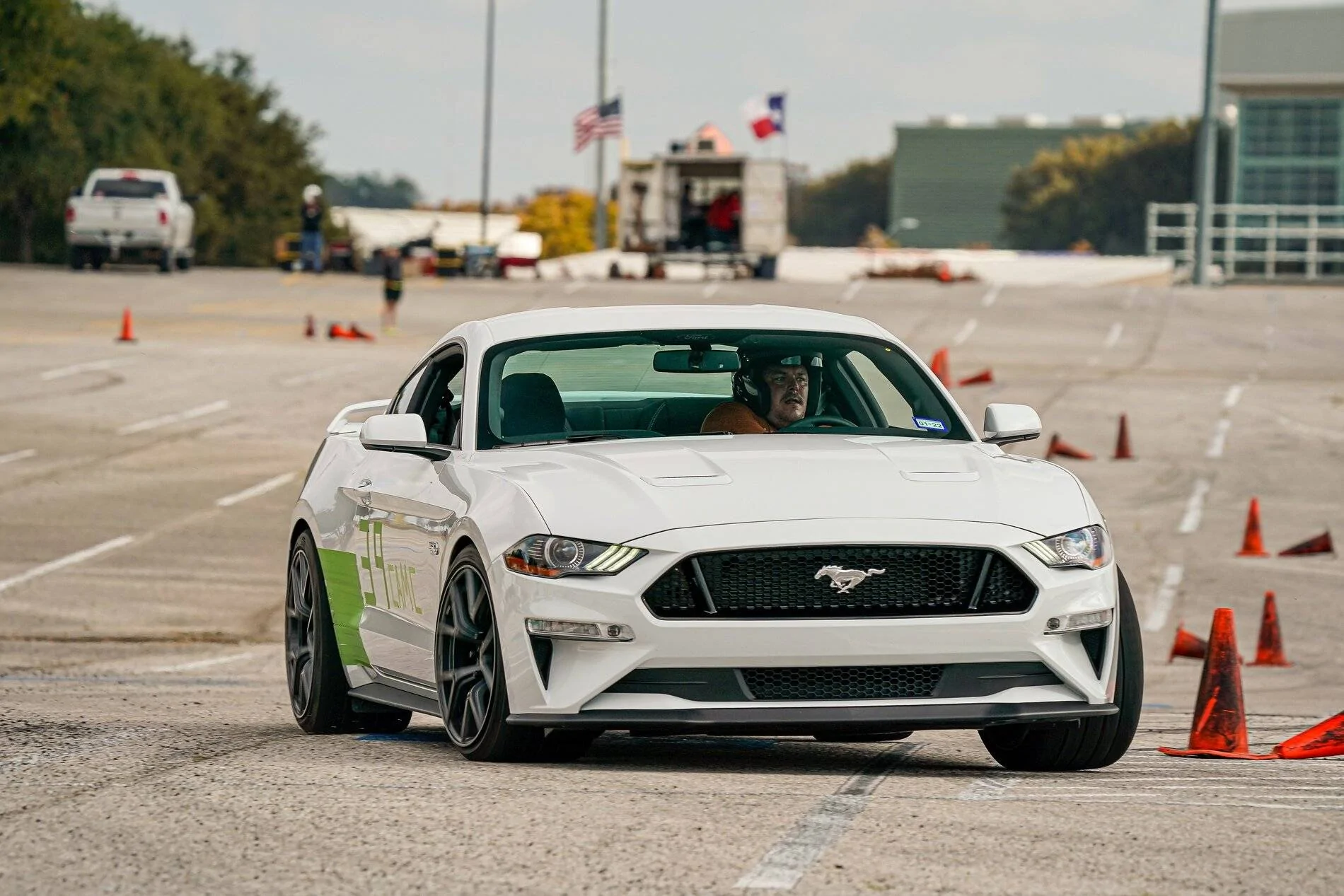

Got a pic of my car rolling the sidewall over..
I think this shows 32psi hot was not nearly enough..
Oh yea, this is even worse than mine. The more your drive, more you will be able to feel the sidewall flex - especially with all the mods you have that take rubber bushing compliance out of suspension.

I’ve heard the A052s do need significantly more pressure due to soft sidewalls.

Tire pressure is definitely low. I'd start with 32 cold, but since Auto-X runs are quick, you might need more, as long as it doesn't get above 36, as mentioned. Your pattern also shows abrupt transitions; try to be smoother. But tight turns are brutal on car tire edges, so you might wear them out on the outside first if, you do that often.

Looks like it wants more camber to me. In my experience you want more camber in autocross than for the road course.
