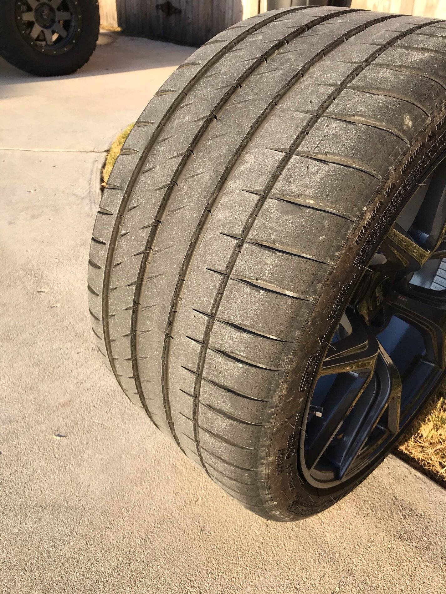

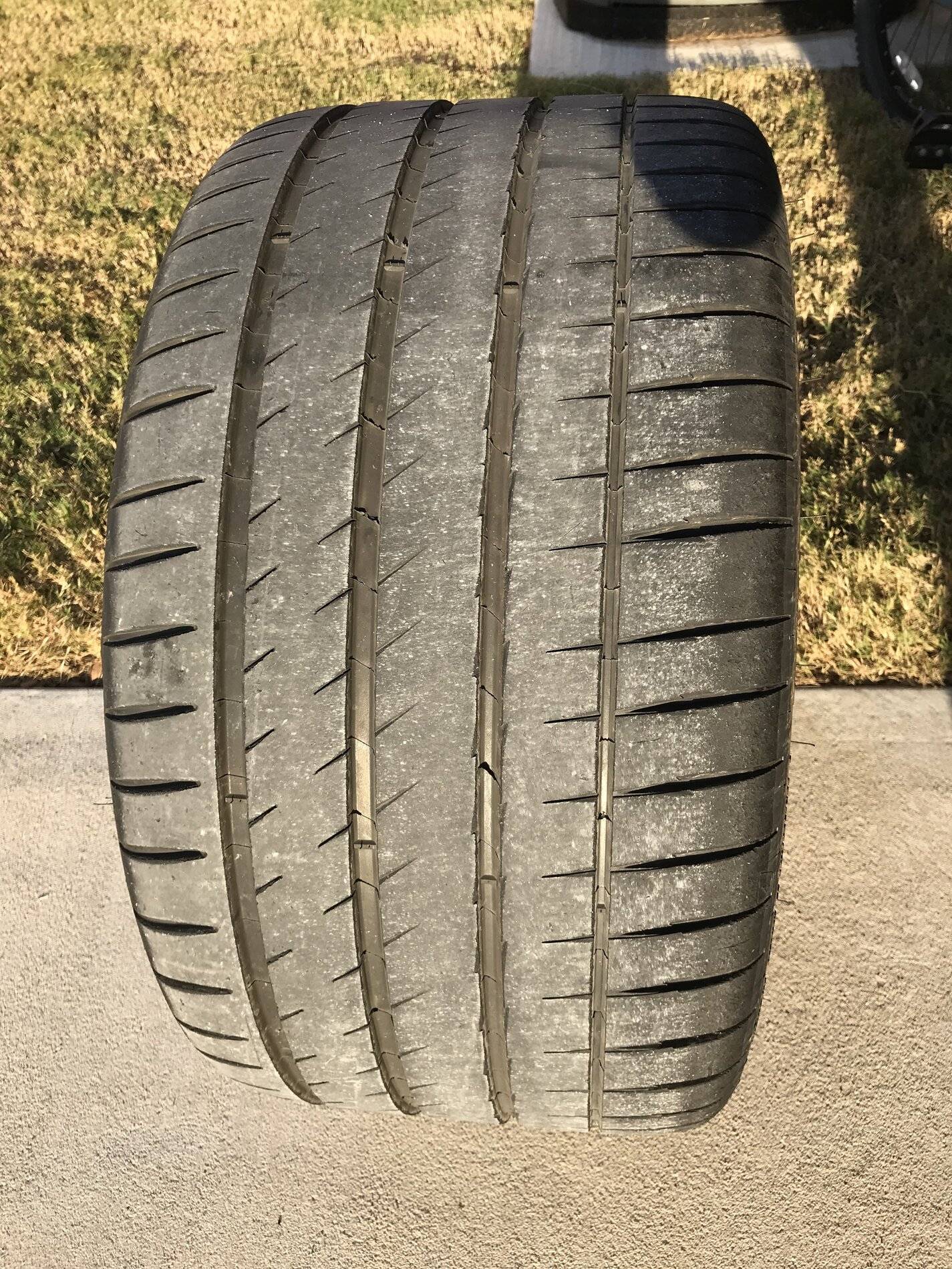

I'm hoping to get some input from those of you more seasoned coneheads about what my tires are telling me here.. I have my suspicions that I ran too low of a tire pressure..BUT I'd love to get some input from those with a little more experience.

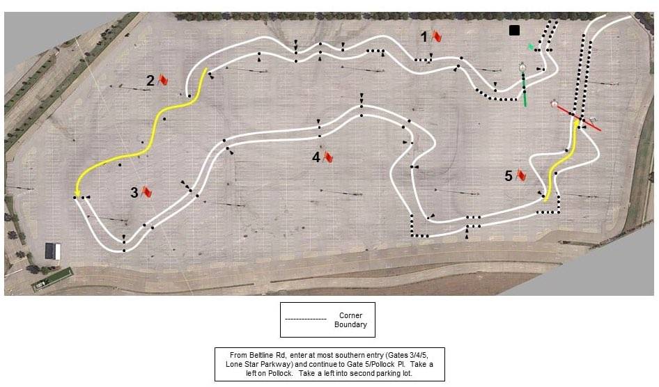

The course was FAST and FUN! With the course being as fast as it was, I was a little too aggressive and over drove the car quite a bit. The car was vastly improved from what I can remember from my first event in a stock car. I was much more comfortable driving the car at/near the limit which contributed to an inflated confidence to over drive the car. Surface is a rough and rocky covered asphalt. I understand it has the nickname "gravel pit" from the locals..

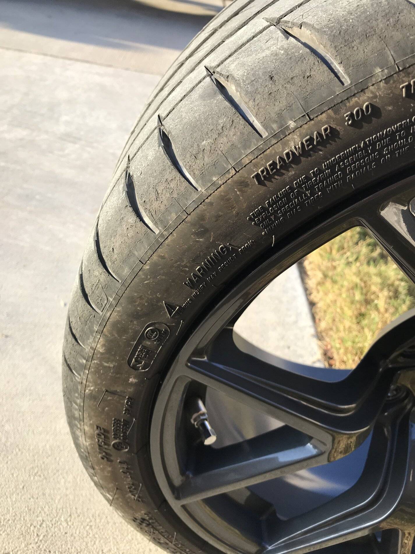

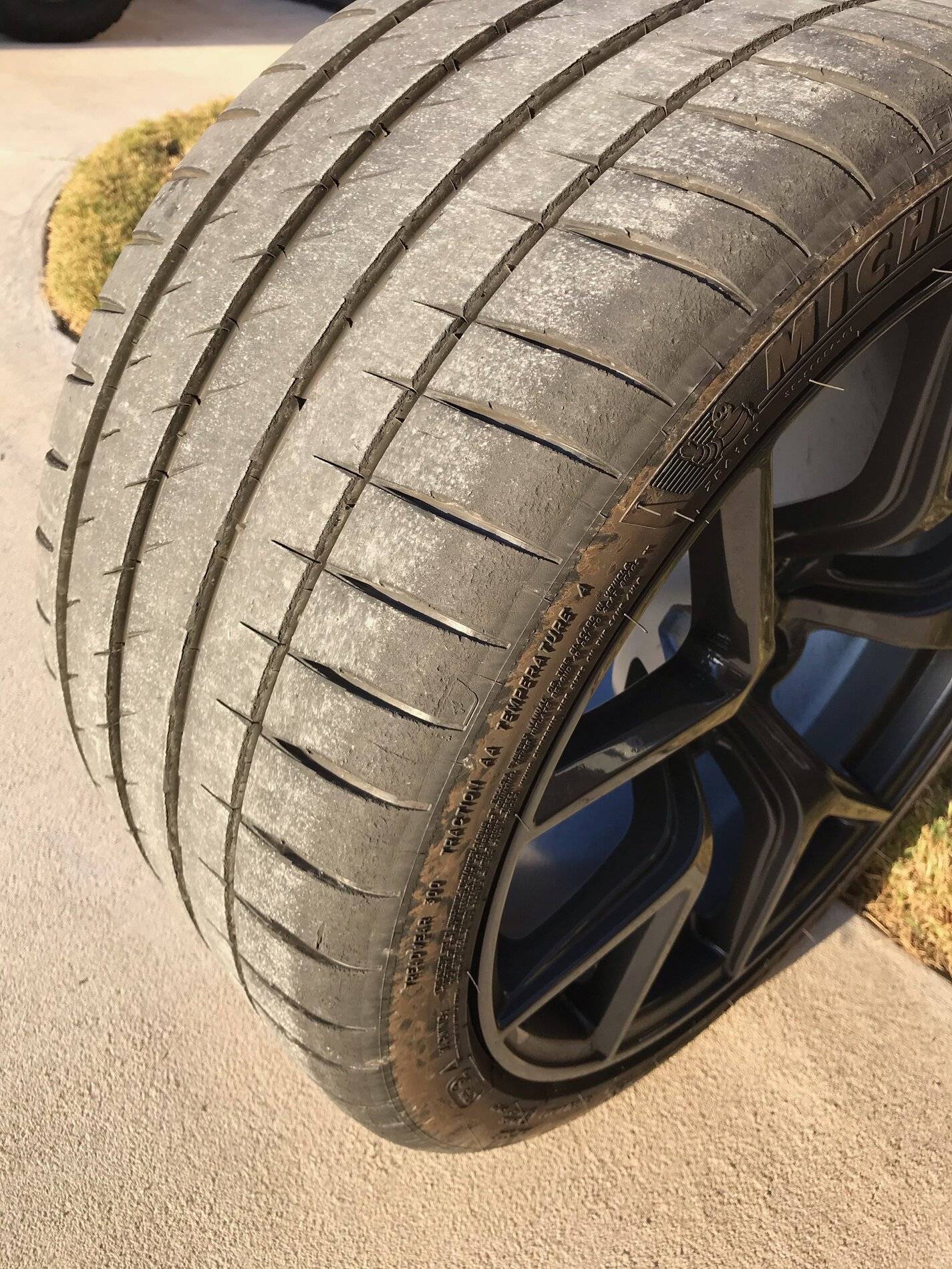

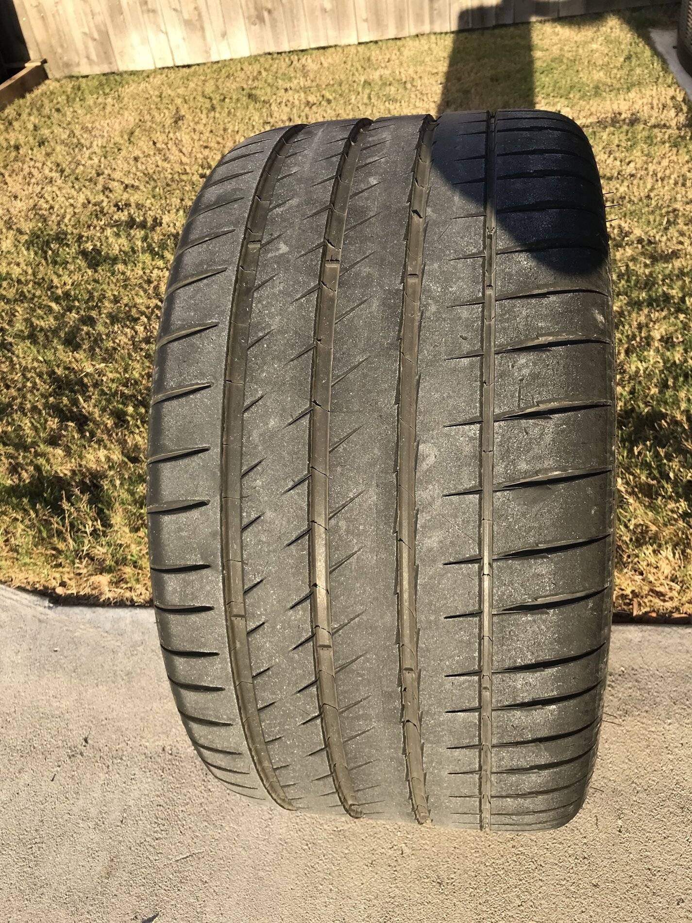

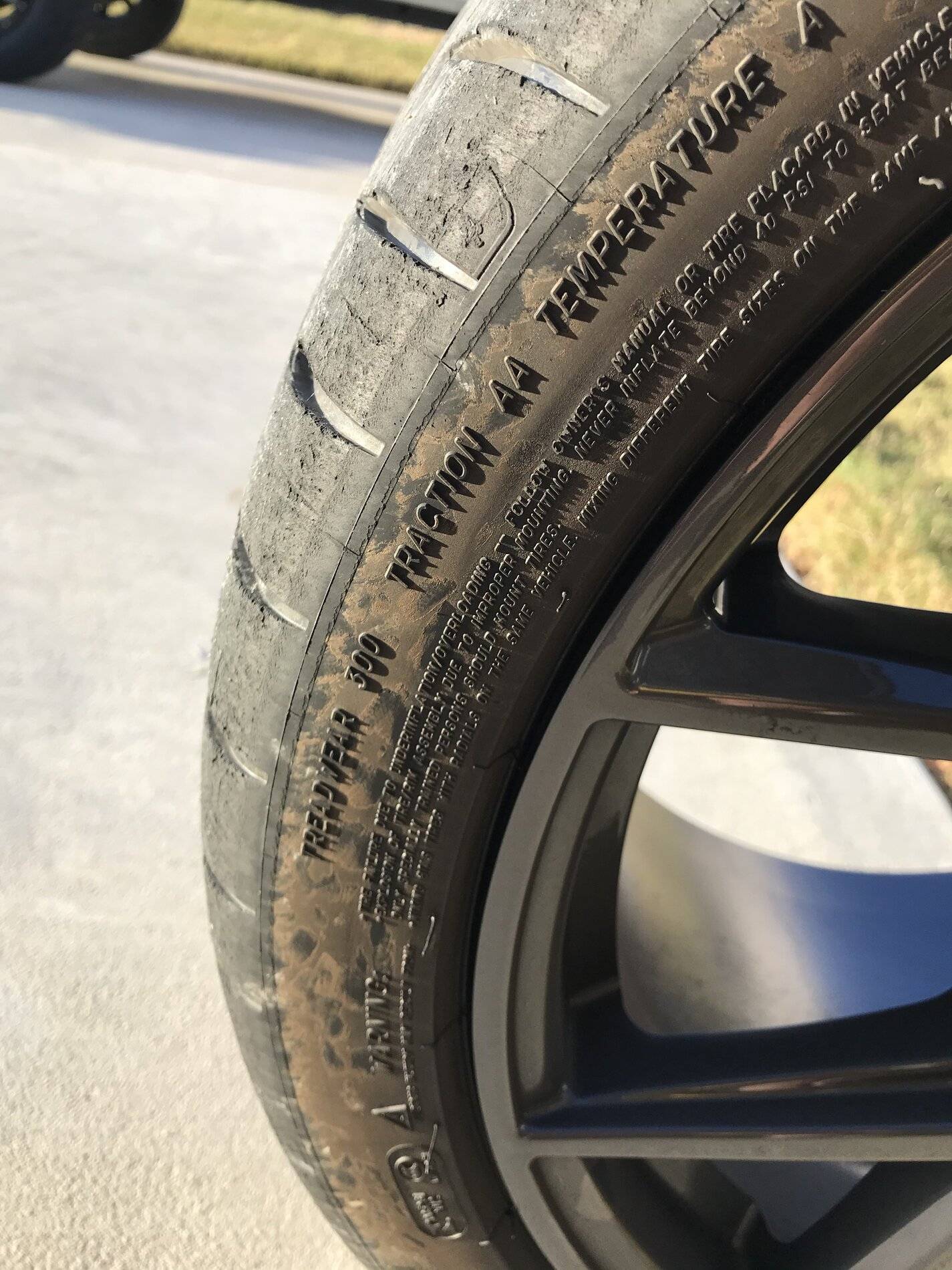

So both sides are comparable in terms of wear, so I'm only going to post front and rear from the drivers side. Tires are Michelin PS4S in 305/30/19 Square setup on 19x11's. I know these aren't "track" tires so don't hound me too hard for having street rubber :) Tire pressures were 32psi front/rear hot.
Front tire:
Rear Tire:
Is the wear excessive and just a result of my overdriving the car? Was this a pressure issue? Lack of Camber? Any input welcome!

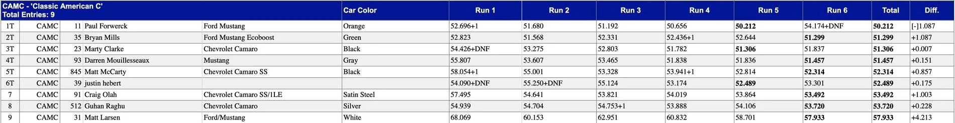

Results for those of you who stuck around: #39
PAX results: 54th/127
https://autocross.com/er/2020results/cc20_10_pax.htm

I am not sure where you see excessive wear. There is basically none. If anything, you likely have (no offense meant) underdriven the car. There is some wear on the sidewall so pressure could be higher but you should be able to feel tire flex in the corners rather than try to figure out the sidewall wear.
FWIW 305/30 Rivals at ~32psi on the front flex way too much (for me - on Perry's pics you can see it almost coming off the rim), I'm running 34.5ish.

In hindsight, I think the "excessive wear" mention was the wear observed on the outside edge relative to the wear across the rest of the tire. It looks like I hammered the outer edge and didn't use much else of the tire. It is my hope to understand if this was a result of the pressures I ran, car setup, or my driving.
No offense taken! :) I'm pretty new to this stuff (it was only my 2nd ever AutoX) so it would not be out of the question to have my observations be completely opposite of reality! I do know that I entered the slalom at corner #2 quite hot and had to scrub a TON of speed by over correcting to get the car back on course. Same story to a lesser extend the 3rd gate in corner #3 was something I often overshot due to carrying too much speed on entry (or rather not setting the car up appropriately for the next gate).
I can see exactly what you're mentioning in your pic. I suspect from your picture and the pressures that was with, I was grossly under pressure. I appreciate you taking a moment to share your input!
Next event is the 22nd. I'll certainly experiment a little more with some added pressure in them.

Probably somewhere between 34 and 36 psi front is correct. Use your hand to feel if the outside of the tire is significantly hotter than the middle, if so, add air.

Shoulder wear looks pretty good to me. You scrubbed down to about the right place on the sidewall. Might use slightly more psi but its a decent wear pattern. I’d start with the same 32 hot next time out and then after 2 or 3 runs increase it to 34 hot and see if it feels better to the seat of the pants.
IIRC I try to keep it between 34 and 36 psi hot with MP4S when I run those hard. 37 too high, 32-33 too low. (285/35R19 tho)
Keep in mind the shoulders are going to look a bit tore up from what you’re used to. Its the nature of handling courses, autox or track. Also the two types of rubber Michelin uses on the surface of the tire, the shoulders are a different compound that most of the middle and inside of the tire, they’ll respond to heat and abuse a little differently.

That 305 is really wide for the size according to the Tire Rack specs. It will be hard to keep from killing the outside edges no matter what you did given it is actually pinched on an 11" wide wheel. More camber and a little bit more tire pressure would help.
