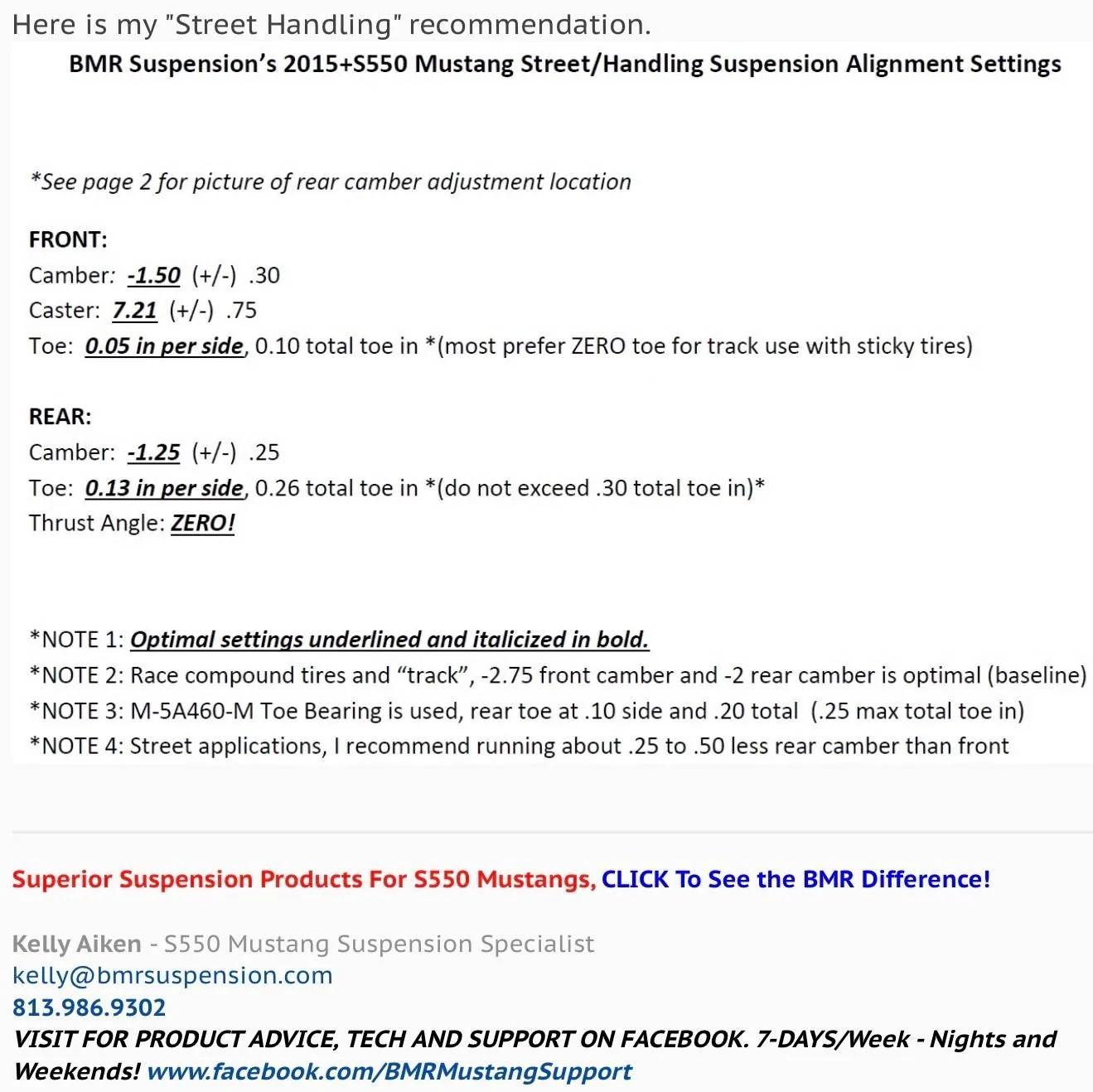

Even with low mileage and the car sat on its wheels, you can move the toe link around and see the OE rubber bush distort when you do so.
BMR amend their recommended fast road settings depending if you have the Ford Performance toe link bearings or not - I assume to allow for the reduced movement with the FP bearing.

Have a look at this post for the BMR settings :

I'm looking forward to seeing what a difference they make as what made my mind up on getting them was working under the car - even with the weight of the car on its wheels, you can pull / twist the toe link and visibly see the outer toe link bush deflecting.
It's also interesting to see that BMR alter their setup guidelines depending on whether or not these bushes are fitted - they recommend less toe on the rear when they are fitted (I guess to compensate for the lack of toe change that the standard bush allows to happen). Ref note 3 :
