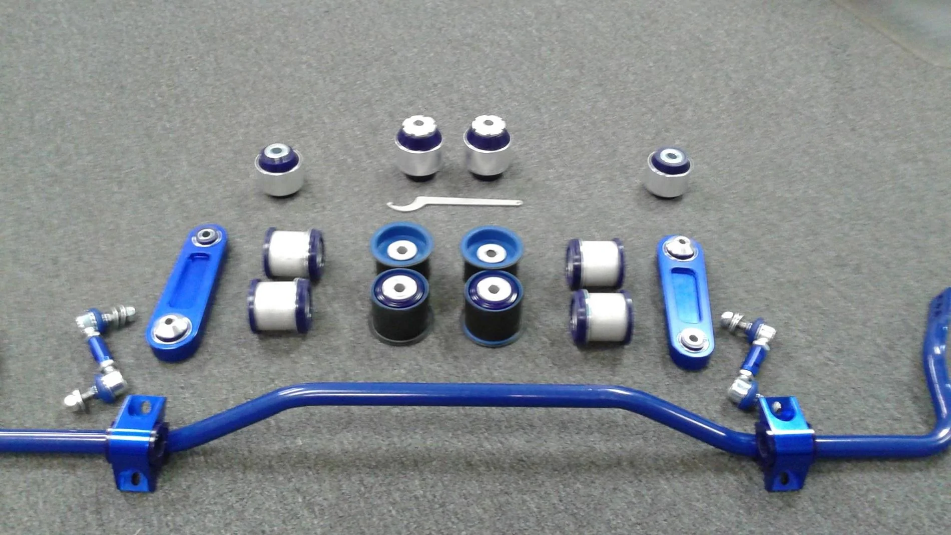

Polyurethane is just not effective (nor reliable) in a pivot point which relies on multiple load and articulation planes.
Once you figure out the proper material to make the part durable and not bind, or increase "snap-back" - you then have to consider the performance gain. Is a soft polyurethane bushing going to outperform the factory rubber? I think you start to split hairs at that point. You can't use a high durometer material, as you will quickly cold flow and deform the bushing, and when not deformed...the amount of bind and snap back would be insane.
There are companies who have them available already. The best design I have seen for the FLCA bushing replacement is from Super-Pro. The image quality is poor, but it is the top center two pieces with the adjustable sleeves and wrench (caster adjustability)
