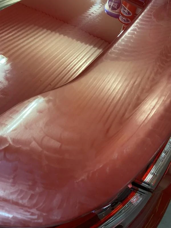

-I have been using a 15mm throw 5 inch machine for both paint correction and wax application for a long time. I have not had any issues with wax application with the 15mm throw.
-I would definitely recommend sticking to a 5 inch base plate machine, teamed with 5.5 or 6.0 inch pads. Unless you are doing a lot of large trucks and SUV's, a 6 inch backing plate with a 6.5 or 7.0 inch pad is just not needed. I went from 6 inch machine to a 5 inch machine and love the smaller size, it's more versatile and just nicer to use.

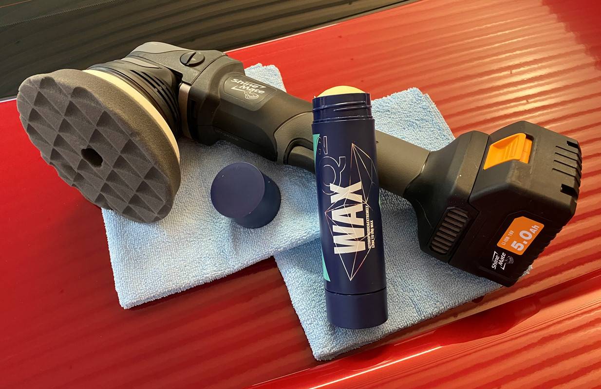

This is a 5 inch / 15mm throw machine with a 6 inch pad applying Gyeon Q2 Wax -

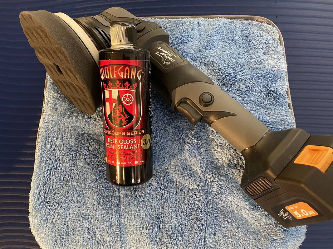

Same machine and pad applying Wolfgang Deep Gloss Paint Sealant -

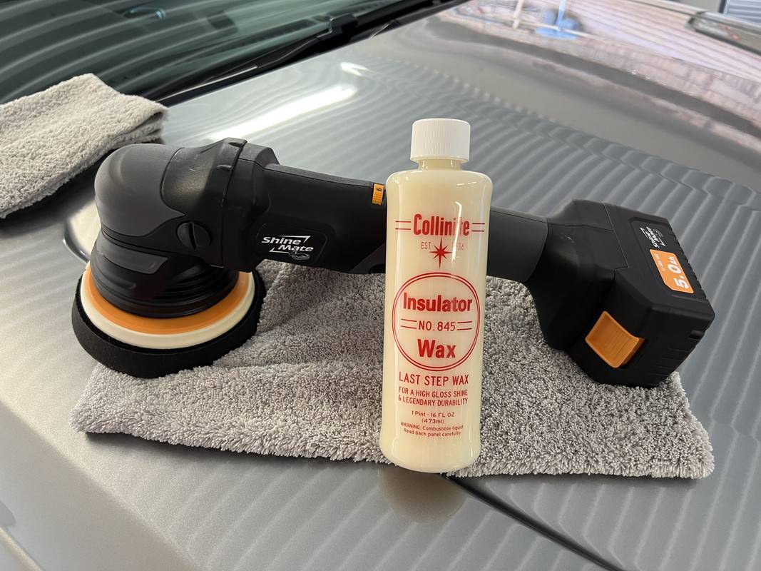

Again, same machine, this time teamed with a 5.5 inch pad applying Collinite 845 -
