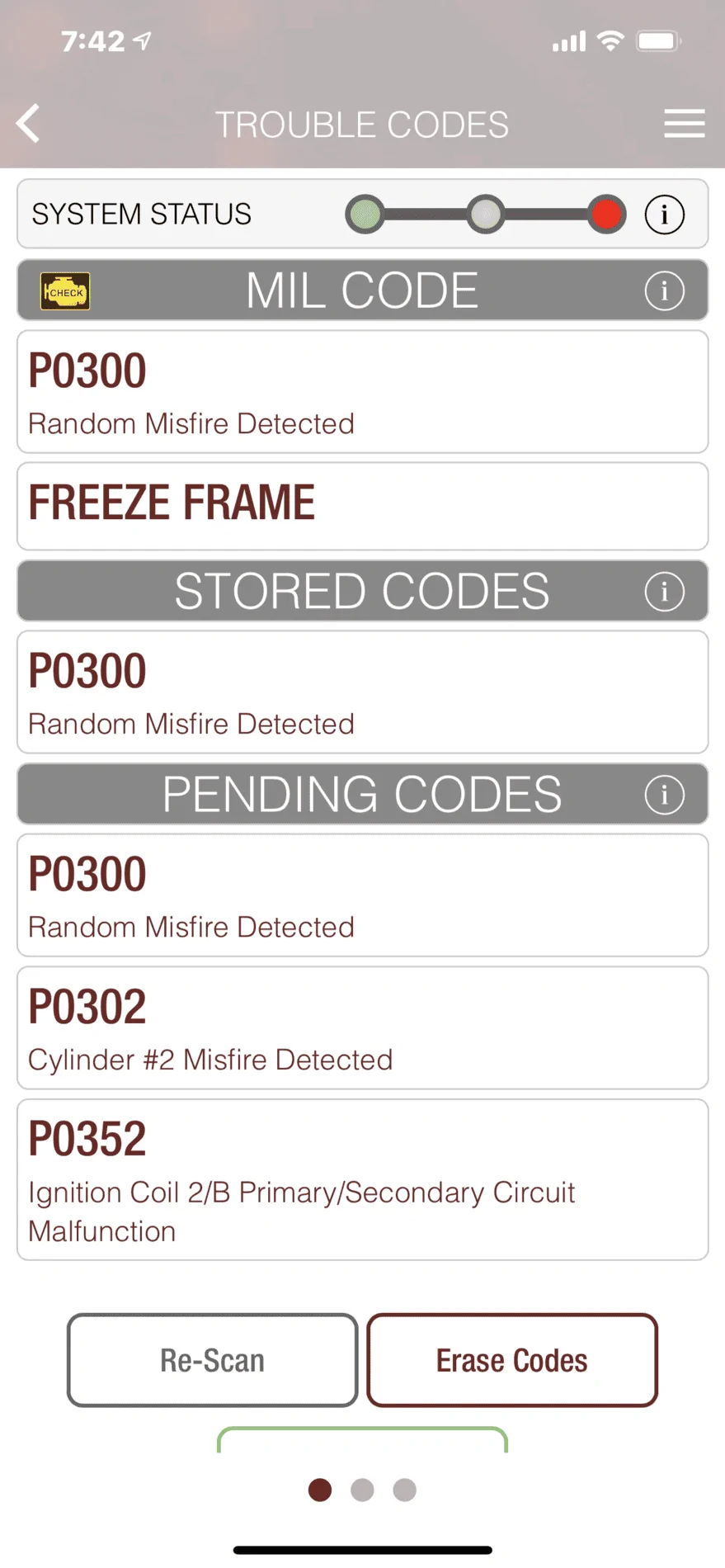

had more check engine lights pop up. anyone chime in know what's going wrong?
