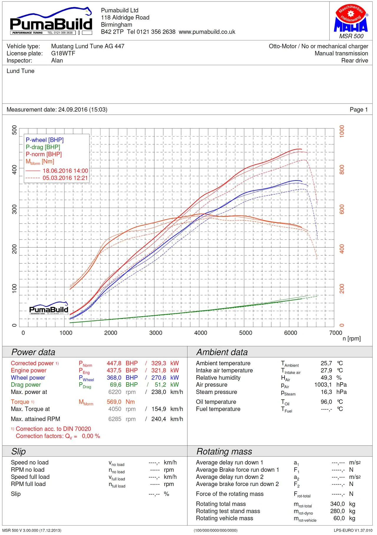

Paid a visit to Pumabuild to see what kind of gains the PMAS CAI had given me over my stock intake with panel filter and airaid modular intake tube.
I was expecting an improvement simply because the car feels far stronger on the road, unfortunately the car did not want to play ball on the dyno today for some reason we were getting issues with stability control kicking in causing us to abort runs, meaning that when we did get the car running things were toasty as such I think the car was reducing performance, still the results were rather impressive:
PMAS Tuned vs Stock Modded Intake Tuned vs Stock with panel filter
You can see the gains were not as hoped, but my car was putting down 440BHP on the stock modified intake with airaid modular intake tube and panel filter, which was a good combo, in defence of the PMAS today was hotter. Still A near 10BHP pretty much throughout a solid torque gains of upto 15-20b/ft down low. I think if the car had ran without issue whilst things were cool the gains would be greater and the car would of hit around 455BHP. :)
Bold red line: Tuned PMAS CAI
Faint red line: Tuned Stock CAI with airaid MIT & panel filter
Dotted line: Stock CAI, Panel filter with NO TUNE.
You can see the largest gains come from the tune, but the PMAS also does offer some further additional gains.
I would say with a Lund tune on a stock car the PMAS "no tune" CAI with tune file is worth 35-45HP and around 45lb/ft over stock. I am talking flywheel figures. :)
We also tried hood up and down, the runs were with 2-3BHP of each other, the best run above was with the hood down, but there was nothing in it really and was more likely to do with cooling.

Cool stuff [MENTION=13598]Gibbo205[/MENTION]!
I would suspect that on the road, it will do much better because of your IAT mod.
You convinced me of going the MIT and filter route...which filter did you use? The runs where including the grill delete and velossa right? What other hardware did you use with the MIT?

You changed tuners from JDM to Lund which will change things as you didn't do a baseline run on the Lund tune before the intake?

Yes all runs had the front grill opened up and velossa big mouth in place.
The MIT and a panel filter perfects the stock air box which then performs very well, I was using an Afe Pro dry filter. I reckon the combo is worth around 5HP and it improves throttle response. :)
Unfortunately not, the JDM tune was awesome on stock air box and the no lift strategy was cool but the throttle was over sensitive with the PMAS and JDM has not tuned the PMAS so were unwilling to change the tune.
So I went Lund as they have tuned this intake on several cars now and I can report with Lund throttle is much nicer and car seems to punch harder when you initially get on it.
I doubt Lund makes more overall power but their tune drives better.
But the Tune + CAI combo has given me around 35HP and 45lb/ft gain which seems very good result.
All my runs were made a few hundred miles after fitting part or tune. :)

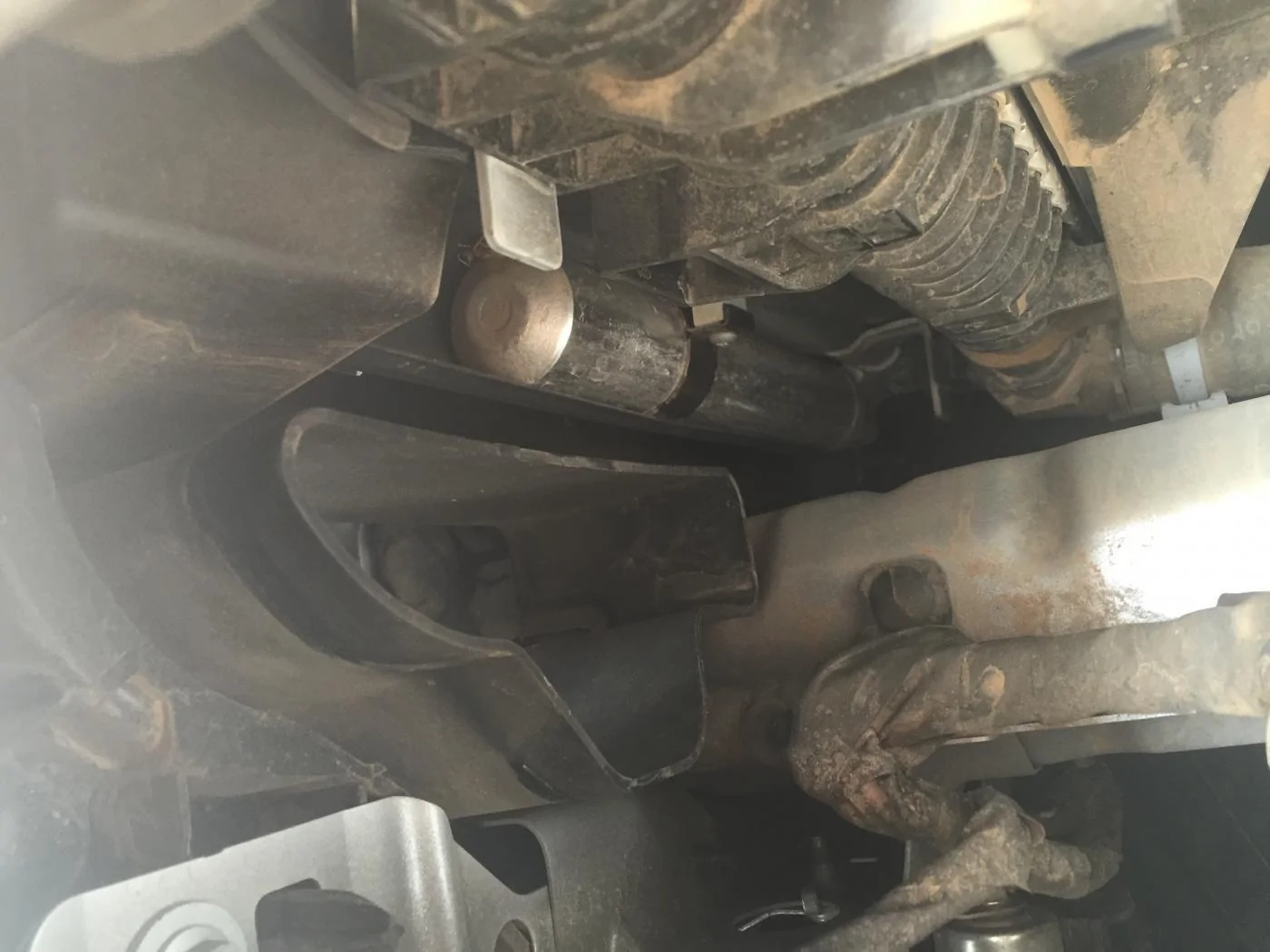

SNORKEL does not decrease flow... When he tested the stock intake on a flow bench the rubber end of the snorkel was collapsing because it was designed to slip over the grill insert... He was claiming the rubber end was collapsing at 380hp which I am sure is true with the intake pulled out of the car, but in the car it is a non issue. Here is my dirty dusty AZ engine bay to prove it. If you see the rubber end of the snorkel fits over the grill insert.
