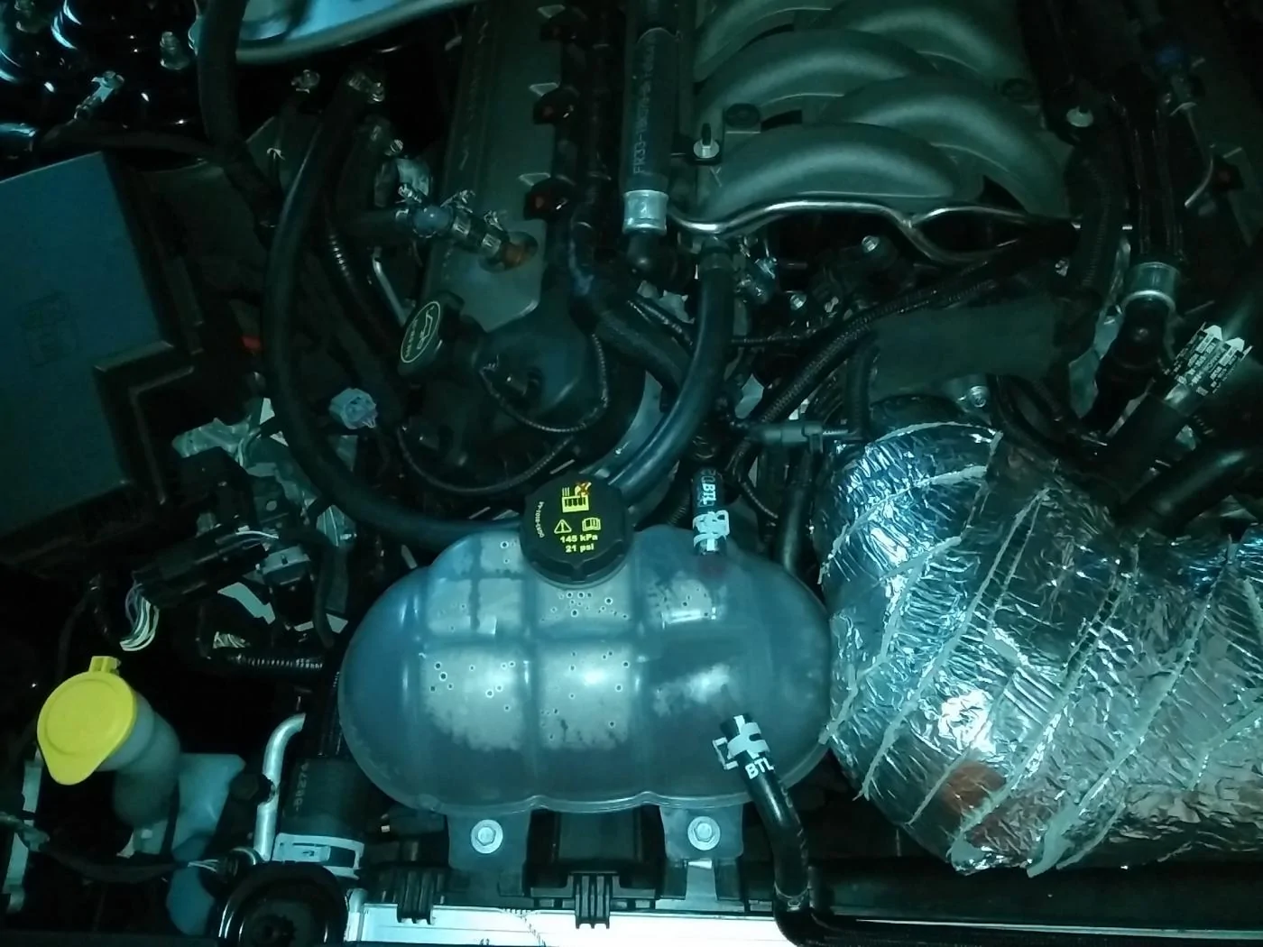

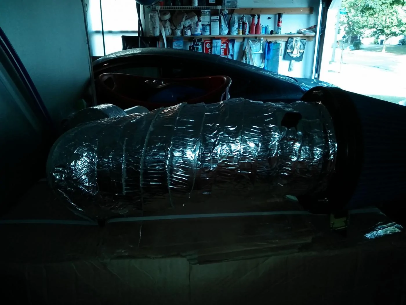

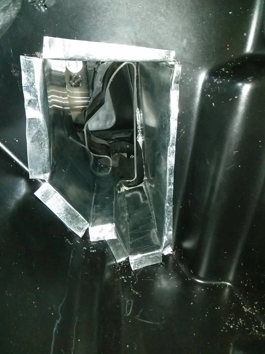

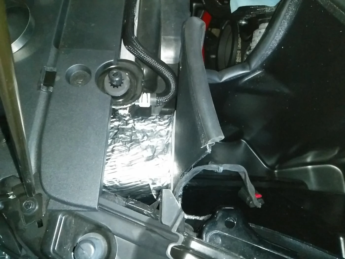

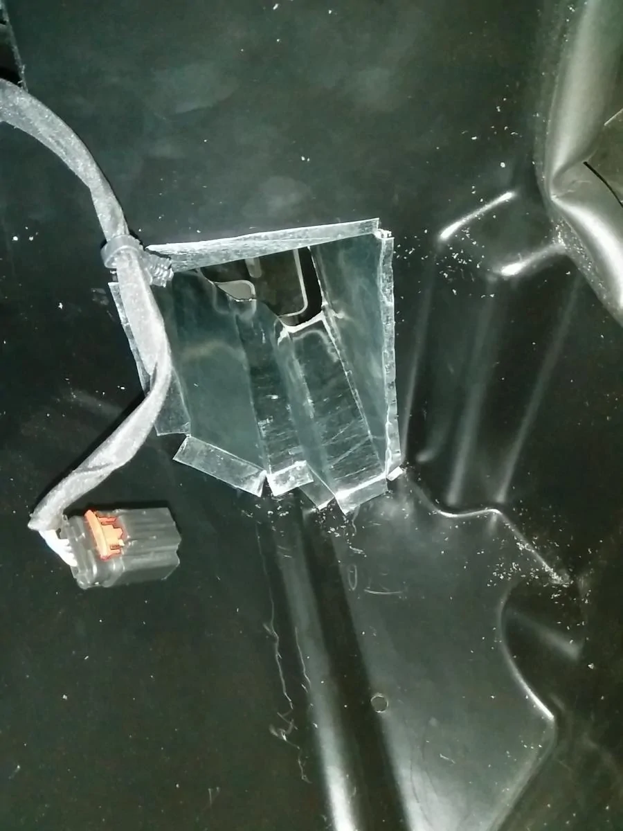

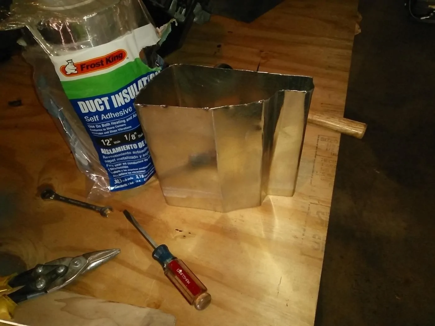

Been running PMAS for the last few days in 80-90 degree humid weather and I wasn't thrilled about IAT. I have never seen temps higher than 130 to 140ish with stock intake. With PMAS temps were about 20 degrees higher. This began to bother me enough so I decided to take an action and help PMAS stay cooler. This is my 30 minute snorkel fix and some ghetto insulation from home Depot to keep things even cooler. You have to consider the fact that I did it on impulse just to see if there's a benefit to it. And you bet..... there's. I'm excited because it worked and you can actually feel difference in performance, at least I could. Nonetheless, this is a prototype sort of until I get my hands on some real stuff that I can wrap the intake with some good heat shield. There is enormous amount of heat coming from the engine, radiator and it's cooling fans. In fact, there is so much heat generated that it began to deform the resin part of intake at the clamp location, both ends. PMAS must add metal rings on inside to prevent intake ends from collapsing as that's what I've noticed and found this rather an important issue to resolve in the near future. After 30 minute run in traffic, opened the hood and I couldn't hold my hand on any part of intake for longer than 1 maybe 2 seconds. I believe that there is a great amount of heat radiating through the aluminum part that fits the maf sensor. Tremendous heat soak is present in maf area to the point where maf readings are out of whack is what I observed so far. Just check for yourself and you'll know what I'm talking about when it comes to the heat. I have few other things that I wanted to share but I'm running out of time now, I'll follow up tomorrow

Ok first things first, [MENTION=19646]dev1360[/MENTION] I didn't intend to hijack your thread and if you feel that it's not cool for me to post, please let me know.

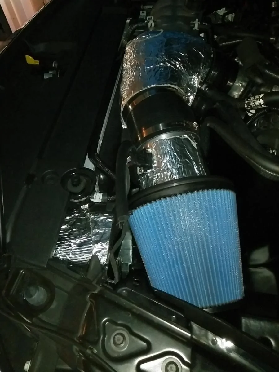

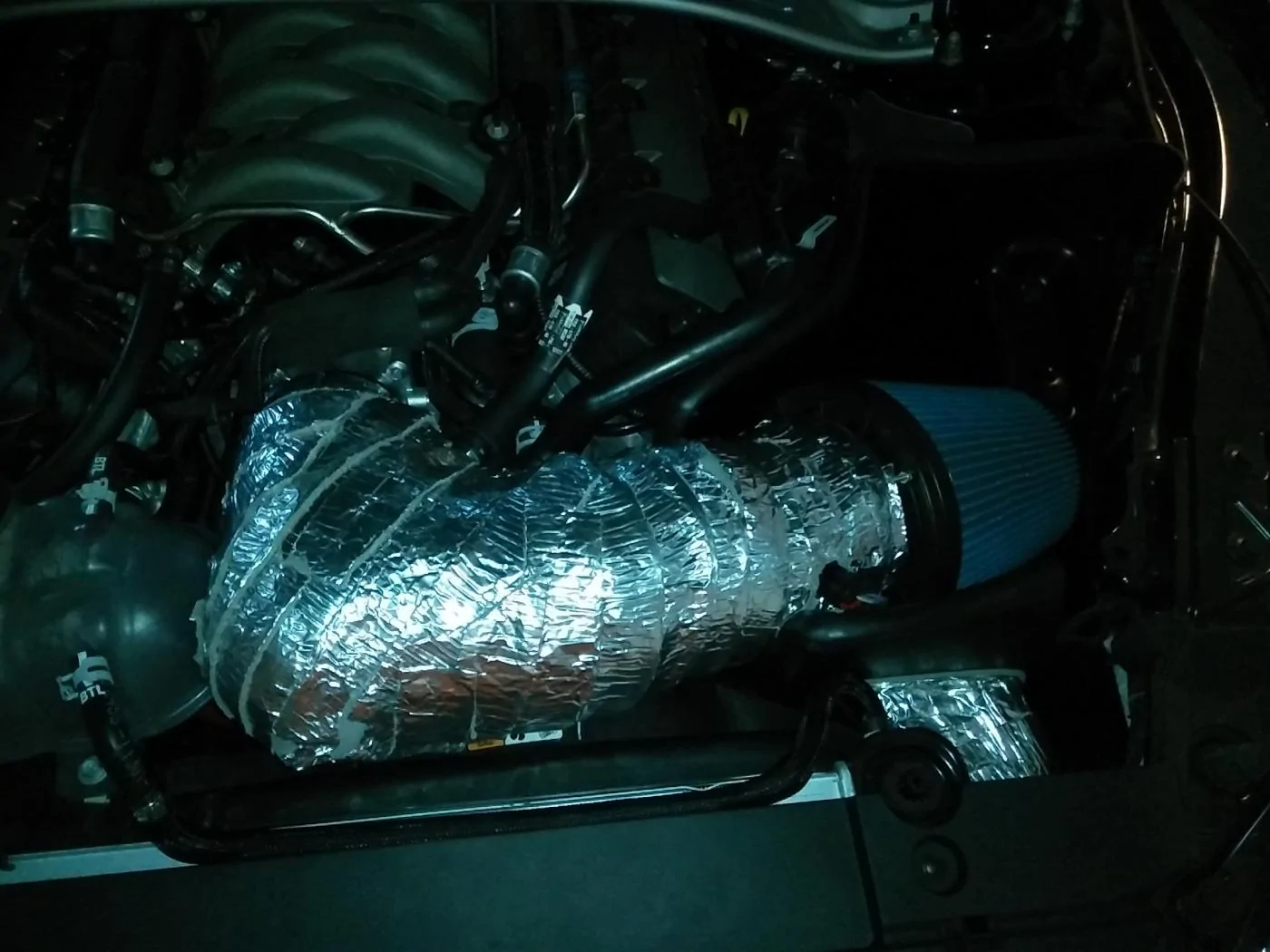

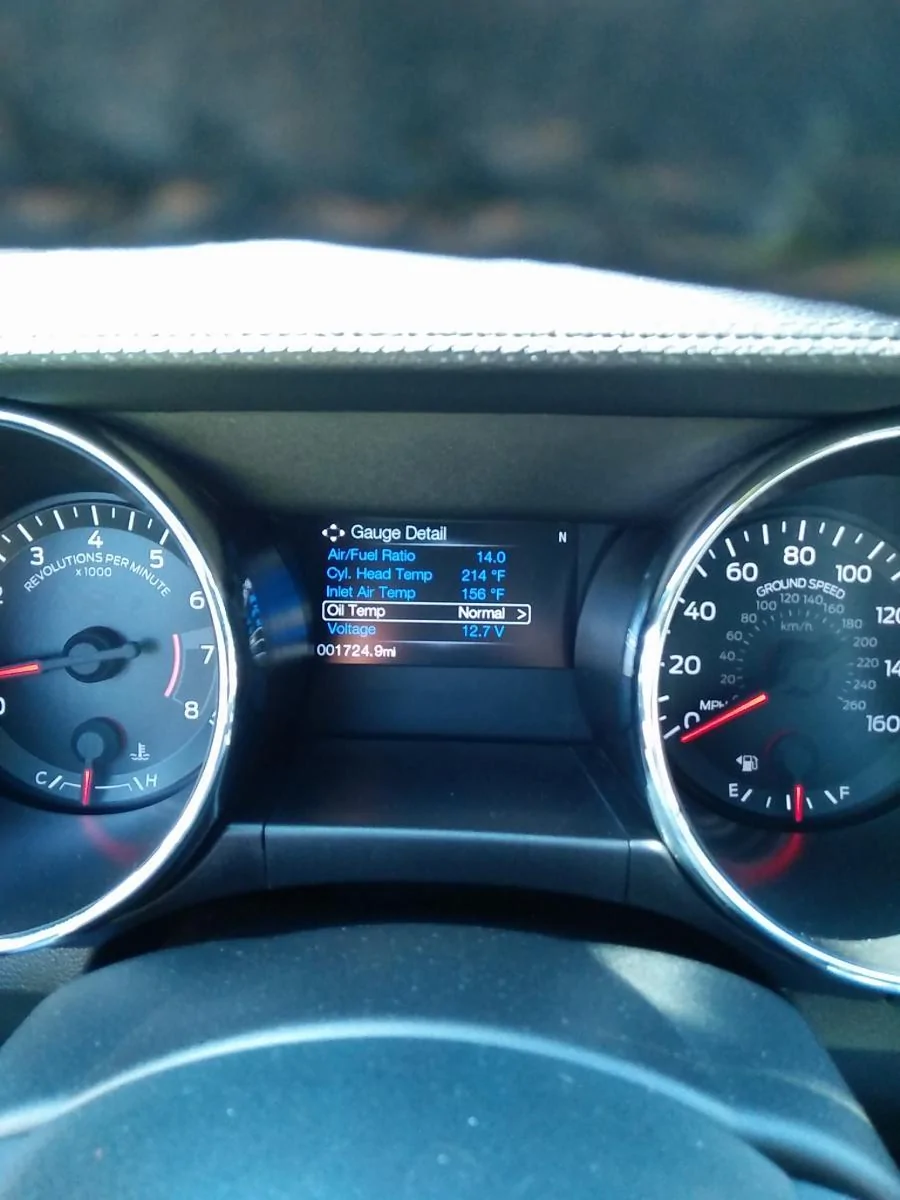

I've spent some time making a second prototype today after work. I haven't been able to run around in the traffic to look for quality stuff so I decided to go with the leftover insulation from yesterday and wrapped up PMAS entirely.
I'm not writing this to BS anyone, this my own testimony of what I observed so each one of you can take it for what it's worth. Like it or not, I'm OK with that though will gladly hear comments and opinions.
Impressions after wrap up:

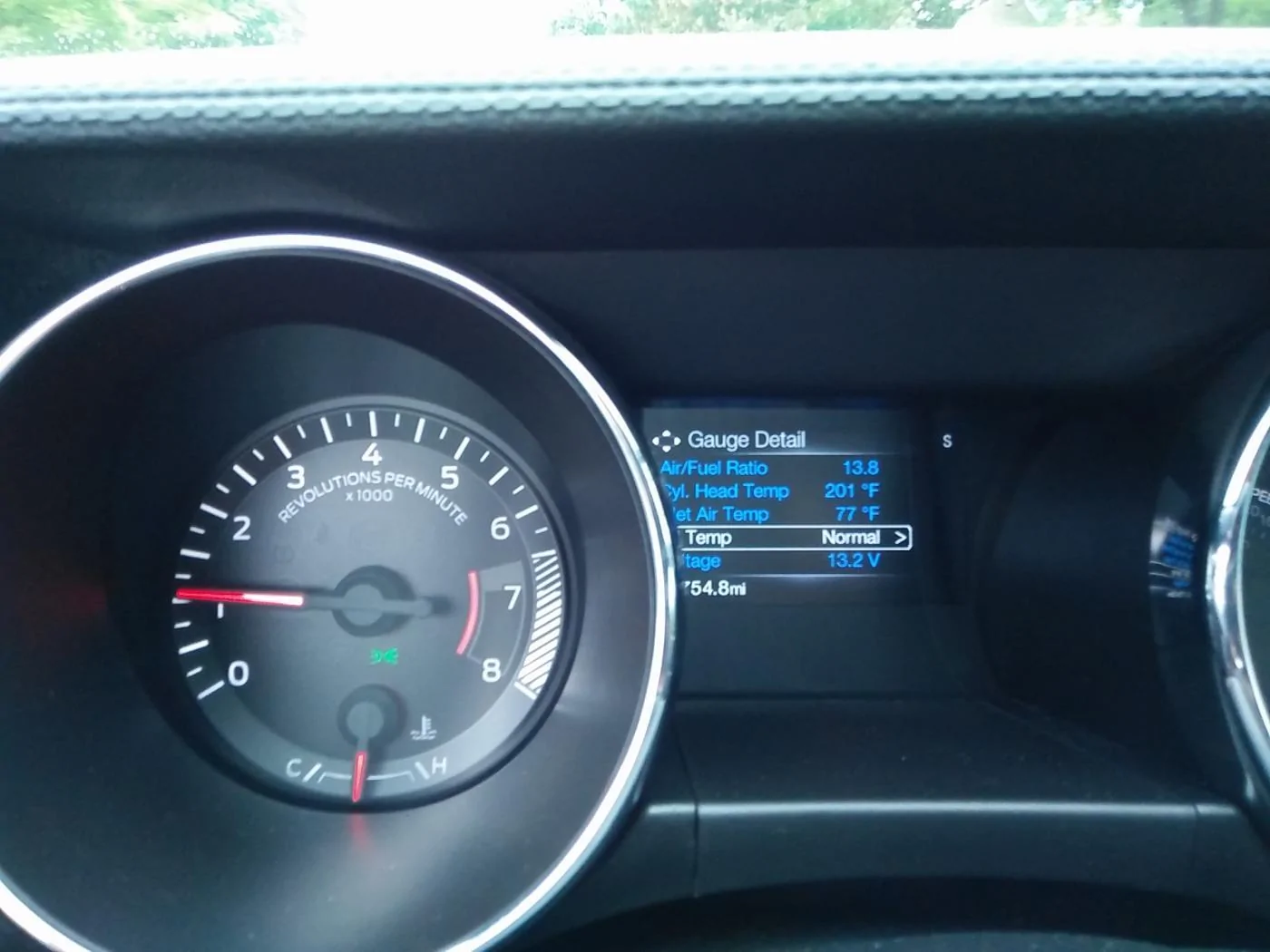

- insulation will not lower top end IAT temps in heavy traffic but everything else has been improved
- amount of heat soak greatly reduced, it takes me almost 3 times longer to reach same Temps vs no heat shield
- I can drop 40 degrees in about 1/2 mile distance driving 40-45mph from the stop
- I can drop 5 degrees just by reving engine for 2-3 seconds while parked,
- before heat shield car felt sluggish, Now Im getting nice rush just above 4k rpm and the higher it goes the better it pulls
- I can get within +6 degrees above ambient temperature much quicker than ever before
- very pleased with the results so far
I'm not sure if my homemade snorkel has anything to do with the cool air supply but judging by the very quick IAT drop while driving looks to me that it does. I know what PMAS said about snorkel but I'm personally not worried about air flow restrictions snorkel may cause, what I'm after is cool air.
My dyno day has been moved from August 12 to August 26th due to a week long vacation trip to Orlando my wife came up with :crazy:
I will update my findings and share more results with you guys as soon as they become available
Cost: $18 at home depot but highly recommend quality heat shield wrap/tape. Definitely worth a shot
I may do some videos and if so I'll post them here.
Any questions or comments, I'm all ears
Oh... Almost forgot, anyone wants the prototype snorkel I have leftover, just pm me

It looks ugly but it looks like it works now if only there is a way to make it look clean lol. Good write up man

PMAS said the snorkel decreases flow. And the gains in flow are worth more than the losses in heat.
I'm seeing between 6-10* of ambient while driving the way the intake is now. I have plans of using gold tape on the box, but I won't be doing any more than that.
LOL, indeed looks ugly. We used to do this in our rally cars except this version doesn't include a heat resistant sleeve which makes it all tight and neat under the hood. I'm looking to have someone make me a custom sleeve to cover all that mess.
